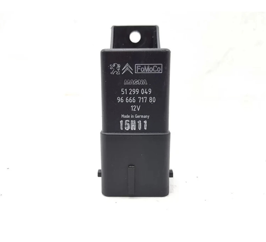

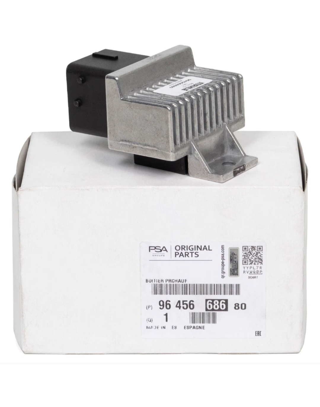

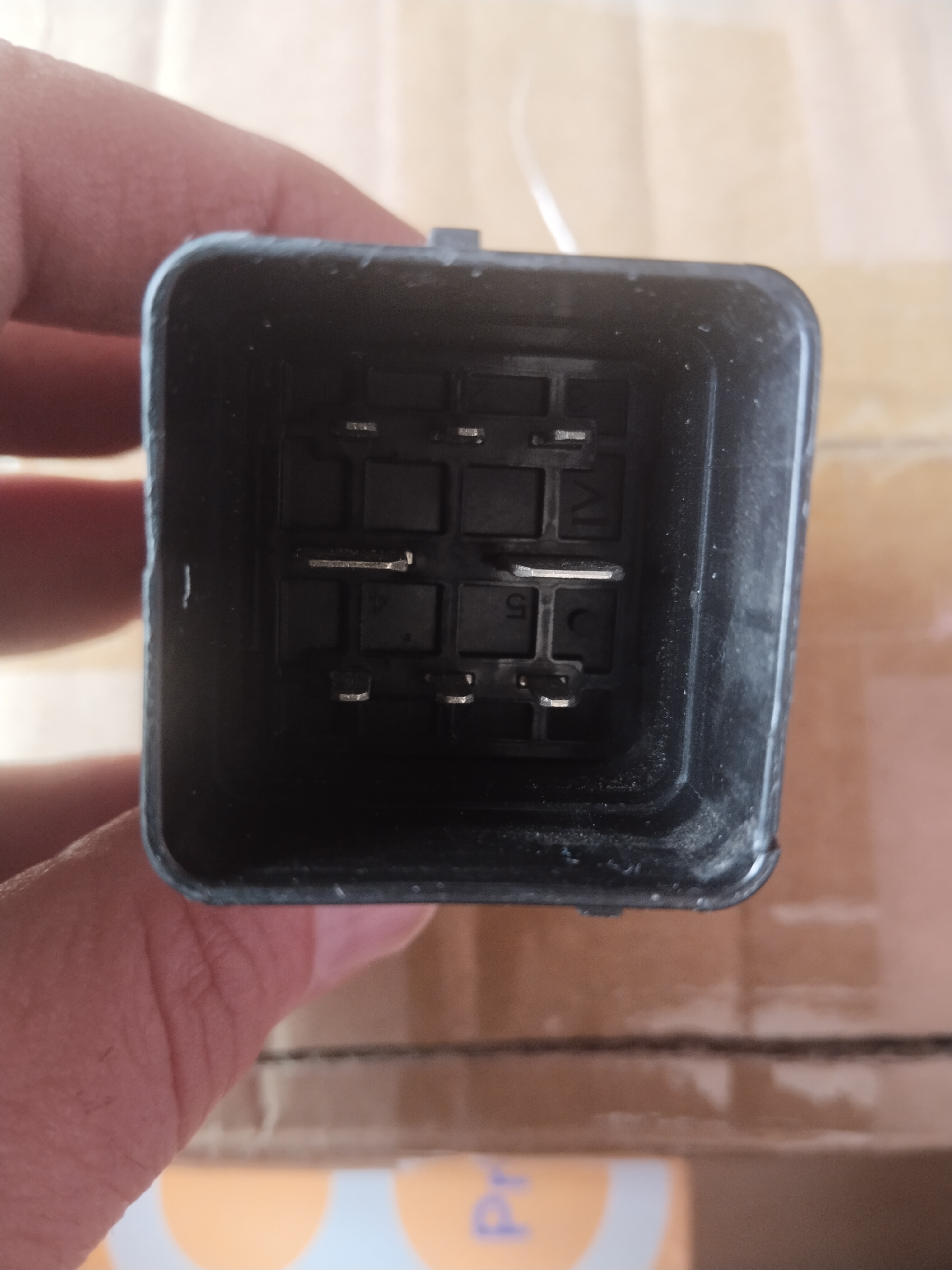

PaulC5
- Posts: 2635
- Joined: 06 Jun 2023, 15:26
- x 686
Re: C5 II Glow plug relay test
I would check again with the supplier that they have sent the correct part.
You have 2 different part numbers as you will have noticed. Your old one is 9802424080 and the one purchased is 9645668680. Depending on what the supplier says, then the only way to see if the new one works may be to try it. Possibly a previous owner has fit the wrong one if the glow plugs have never worked whilst you have had the car or there has been an update to the part. A search shows the old part is still available https://www.ebay.co.uk/itm/333215814229 ... gLalPD_BwE

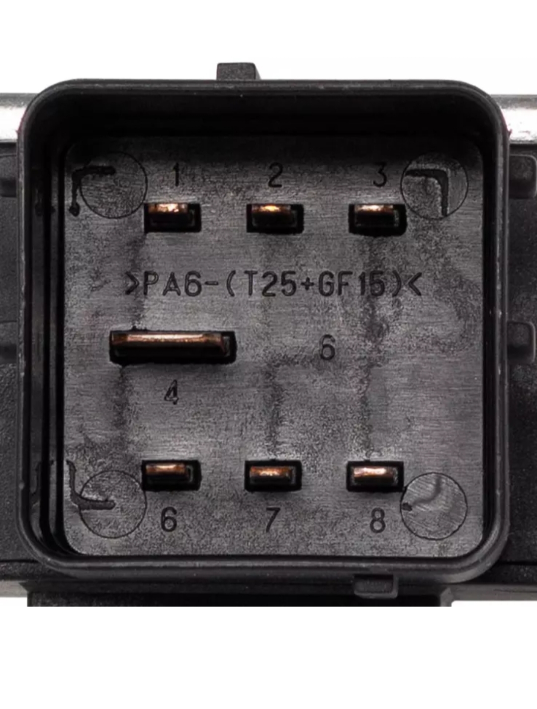

- Posts: 9364
- x 1938
Do both of the large spade terminals have a matching electrical contact in the connecting plug? Two thoughts occur to me. 1) It's just plain wrong and has possibly never worked as a result of that. 2) The second spade terminal doesn't connect to anything and it doesn't matter because all the current is carried by the first terminal.

I received information about the new relay from a technician specializing in electronics at Peugeot Citroen. He explained that the old relay had two large pins in the middle, one positive and one negative, but the new relay only has a positive pin, and the grounding connection is made by screwing the relay body to a metal part in the vehicle, thus ensuring flawless operation. He also said that the part number has been updated, that this is the new, updated relay used in Peugeot Citroen production, and that it is released with a VIN number.PaulC5 wrote: 12 Dec 2025, 11:53 I would check again with the supplier that they have sent the correct part.
The number 9645668680 corresponds to that Model. But at all sellers, the relay with that number has that pin 5. Maybe it can work without that pin, but I would still search with all the pins. Otherwise, the relay is difficult to check except to install it. The heaters must be on when the engine is started unless the engine is already warm. It is very difficult to check whether they are receiving voltage, since this can only be done when they are mounted, and then it is difficult to reach them with these motors. With Renault engines, it's easy because the heaters are on the front. That's why when faced with the dilemma of whether they are good or not, it is better to take them out and change them if they cost less than paying a mechanic again. Who works alone does not cost him anything, but there is a lot of work to change.
Now the main question is whether you suspect the heaters just because the car starts hard when it's cold. It doesn't have to be because of them but because of some other parts or temperature sensors. If the relay or heater is not good, then an error occurs in the diagnostics.
Sydo, what you previously wrote about the relay is correct. The new relay does not use that pin as it is ground and gets it via the screw that secures it. In that case, you should pay attention that the contact where it is located is clean and free of rust.
- Posts: 9364
- x 1938
Do you know I wondered whether the missing terminal was an earth and that the return was now made through the metallic body but I discounted it because I couldn't see why the earth return on the original had to go through such a large terminal. It would surely have had very little current flowing through it as it would have only been the return flow from the activating coil.
Just goes to show that you can overthink things and talk yourself out of the correct answer!
