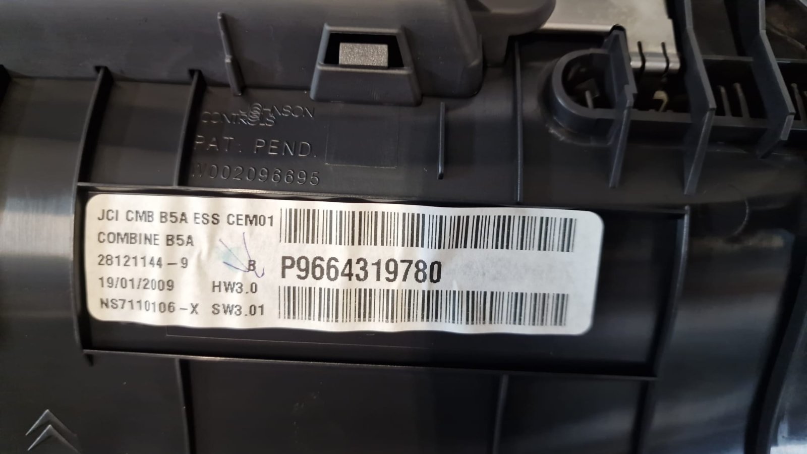

I came to ask you about a malfunction, which I think is common, in the instruments dashboard of my C4 1.4 2009. Basically, the screen stopped showing anything. Some days it is completely lighted (showing everything at once), and now it is entirely blank.
I am trying to find an spare part as a replacement, and I've read that the mileage is going to be changed if I simply plug in the spare part, so I talked with my mechanic and he told me that it can be solved by cloning my console into the new one, so that problem is (I think), solved. But I am having a hard time finding the specific replacement, as there are not that many. The product number registered in my dashboard is P9664319780 (as you can see in the image attached), but no spare part in the nearby scrapyards have the same number. The closest one I could find was one that had as product number P9664319880, which corresponded to a C4 1.6 diesel one. I'm assuming that it does not work, but I am becoming more and more desperate, as it does not seem to be any suitable replacements available.
Now, the question is: can I use other dashboard, like the one I found, as a replacement? Would that be problematic? If I manage to find a dashboard from a gasoline C4 with a different product number, would it be suitable? And finally, is there an alternative dashboard that can be used as replacement?

I'd suggest your best chance in the UK would be to call Chevronics and ask them if they have one: https://www.chevronics.co.uk/ :)

Thanks for the suggestion, but unfortunately I'm in Spain and importing from UK is quite complicated haha.
