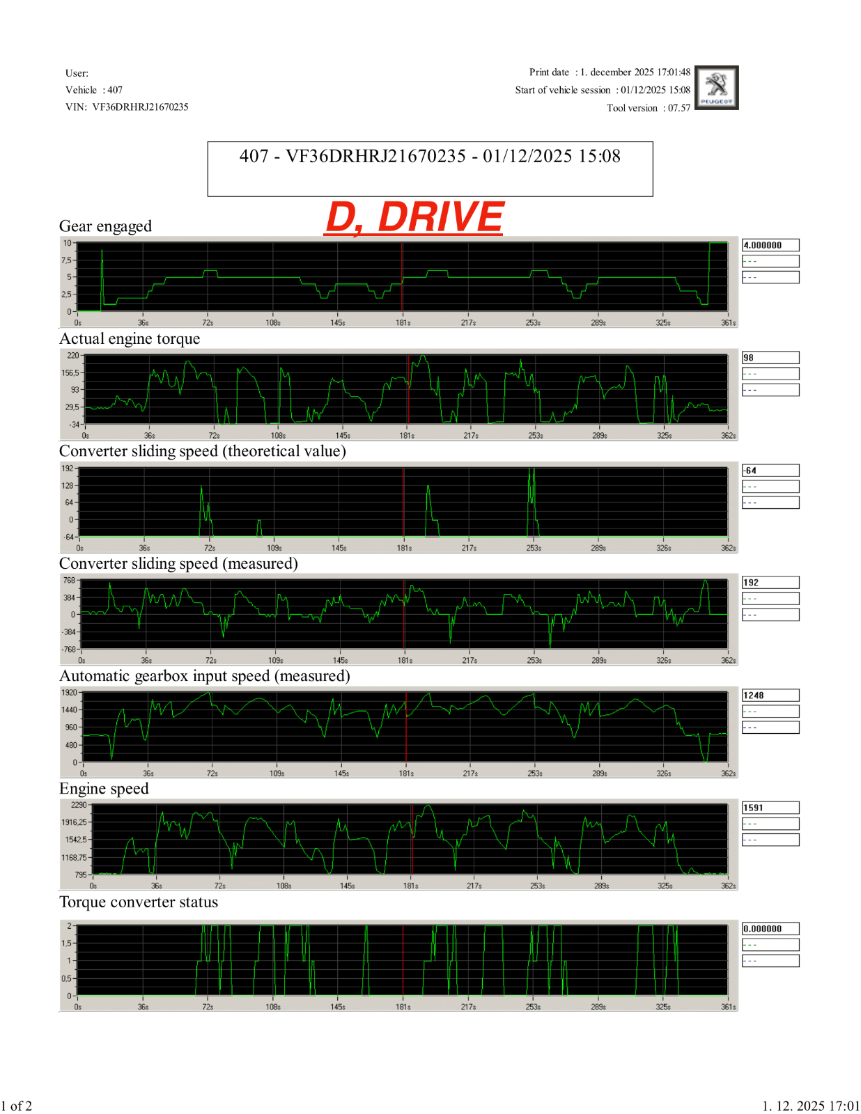

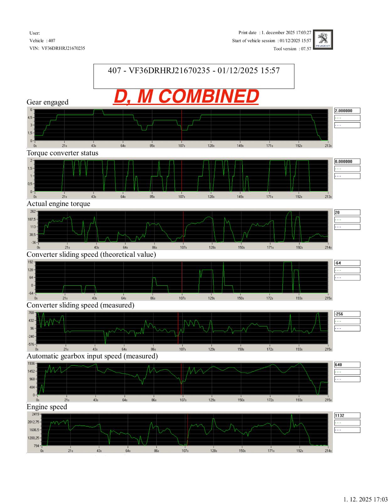

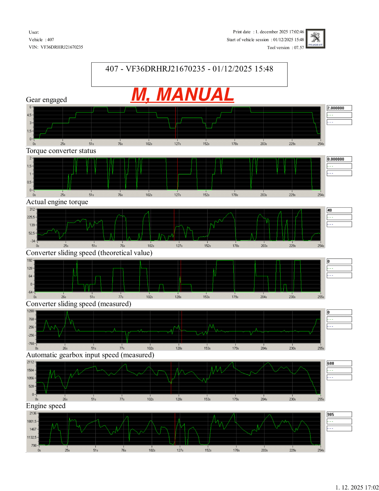

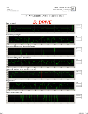

Recently I have noticed that my car does not accelerate like it should in D but when i switch to M it goes like it should, so i hooked up DiagBox and did some measurements on the gearbox, the results are in the attachments.
1. D only -> It slips like hell the torque converter almost never locks up.
2. M only -> The torque converter is locking up and the car drives like a dream.
3. D <-> M Combined -> When I am going in M for example in 5th gear and the torque converter is locked up and I put the gear lever to D the engine roars up and the RPM jumps up by 300-400 but the acceleration is extremely sluggish.

This whole situation is so strange and absurd, in D it is so bad but in M and SPORT its perfect and works like it should. Can the valve body be the fault? The line pressure might be lower in D than M and even in SPORT mode it manages to lock the torque converter like in M when commanded to and theese two modes need more line pressure to operate. I also heard that theese first gen tf80sc s had valve body weakness issues after some use and my car being at 280 000 kilometers it would make some sense according to me.
