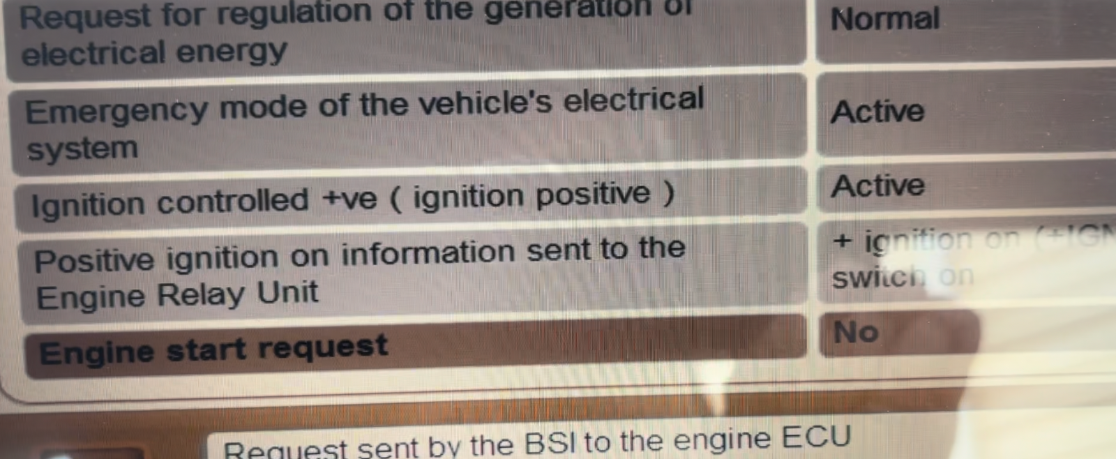

The BSI shows 3 faults:
The first is 9528 Fault: absence of command of the starter
Extra information: From: Local; and
Characterisation of the fault: Coherence (whatever that means!)
The third is B9A0 Engine fusebox: Fault in the starter motor control circuit
There’s no extra information. It says: Ownership not referenced; Value not defined
For the engine ECU, there are 4 errors. I think that all of these could be related to the engine not starting, but again, I’m not an expert.
The four errors are P1694 Controlled engine start and stop
Properties: Local, Intermittent, and Fault on the starter motor control line.
There’s a list of other things such as ignition status, engine status, engine speed. The image is still in the other post, on page 3.
P2291 and P0017 both have Starting monitoring
Fault P2291
This is reported as intermittent and local. It then talks about the rise in pressure rate.P2291 then talks about engine speed, coolant temperature, fuel temperature, as well as Rail pressure setting, amongst many other things.
P0017 seems to be about synchronisation, so maybe not relevant.
P2290 Is Accelerator pedal sensor

The codes may or may not be relevant - they were all intermittent, which means the fault is not currently present - they may be recent and related to the starting issue, or they may have occurred some time in the past. By deleting them, and then seeing if they come back when you try and start it you will get an idea if they are relevant.

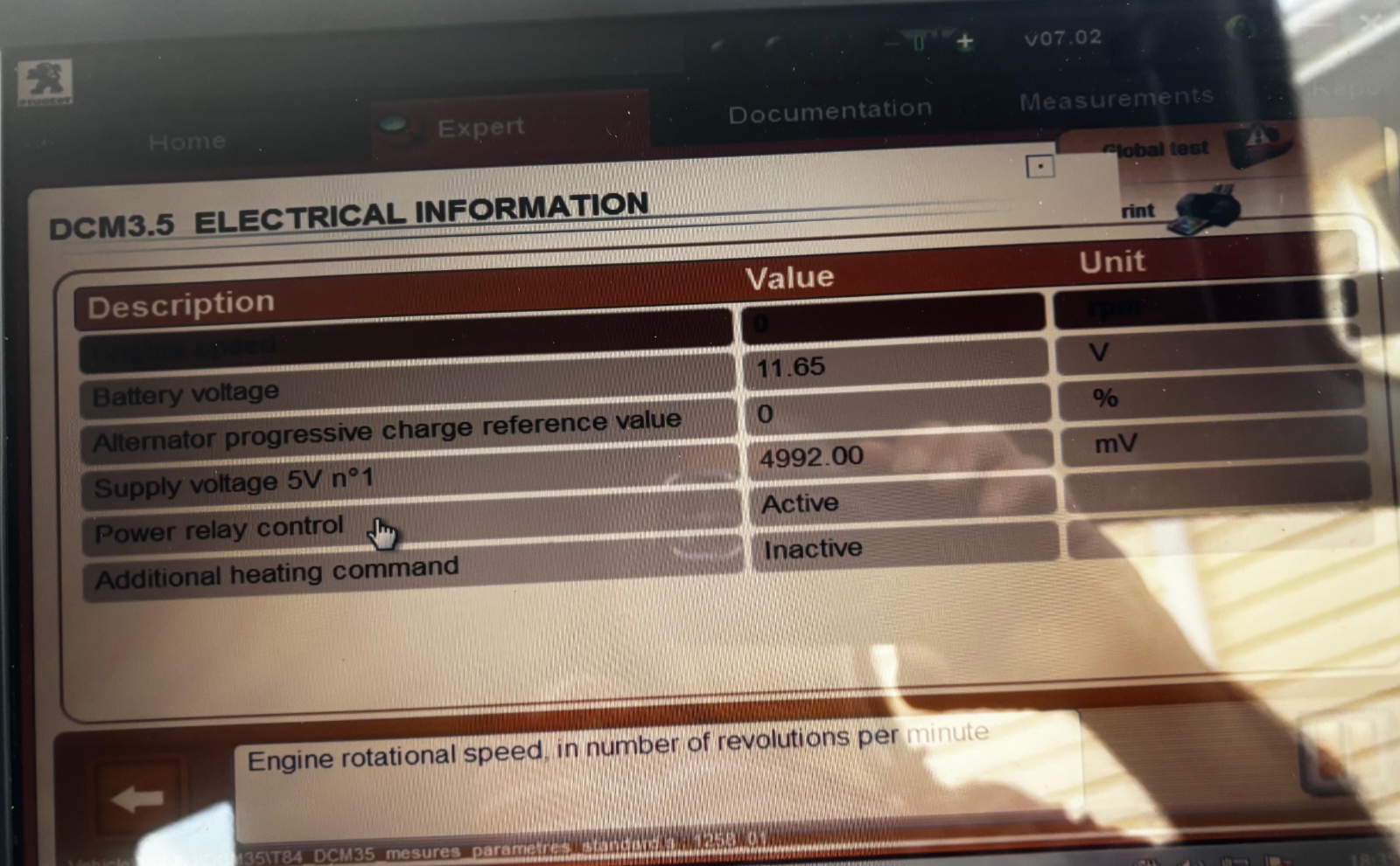

Live data is what the ECU is actually seeing in real time - do the global scan, click through onto the ECU, and then Standard Parameters (I think that's what it's called). You will then see further menu items with different titles, you will be looking for electrical data or something where you can see the gear position and the starter status.
The low battery may be relevant here (or again, it may not!) - it could be that the battery has a superficially OK voltage, but when a big load is put on it (starter...) the voltage drops - but as above these could also be from some time ago. See if it comes back now you have cleared it.

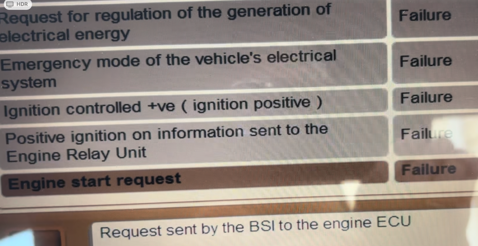

There's a lot of stuff in Diagbox! I wonder how much 'damage' someone could do if they had their minds set on it.
Now for the weird things that happened on this warm 38ºC day.
I cleared the faults and re-ran the Global Test.
Yes, the battery voltage has dropped.
Whatever that 4992.00 is measuring, it was alternating between reading 4992.00 and 5000.00 fairly regularly.
I cleared the faults again and tried again with the Global Test.
I cleared the faults again and re-tried the Global Test. Again..
I still didn't get the same results. But I have put the battery on charge overnight.
Ready for 39ºC tomorrow!
