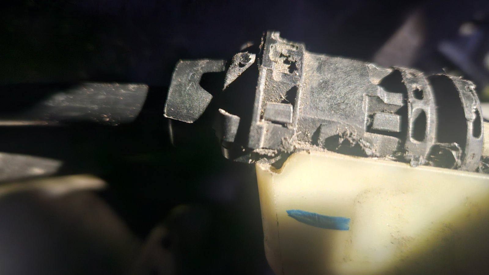

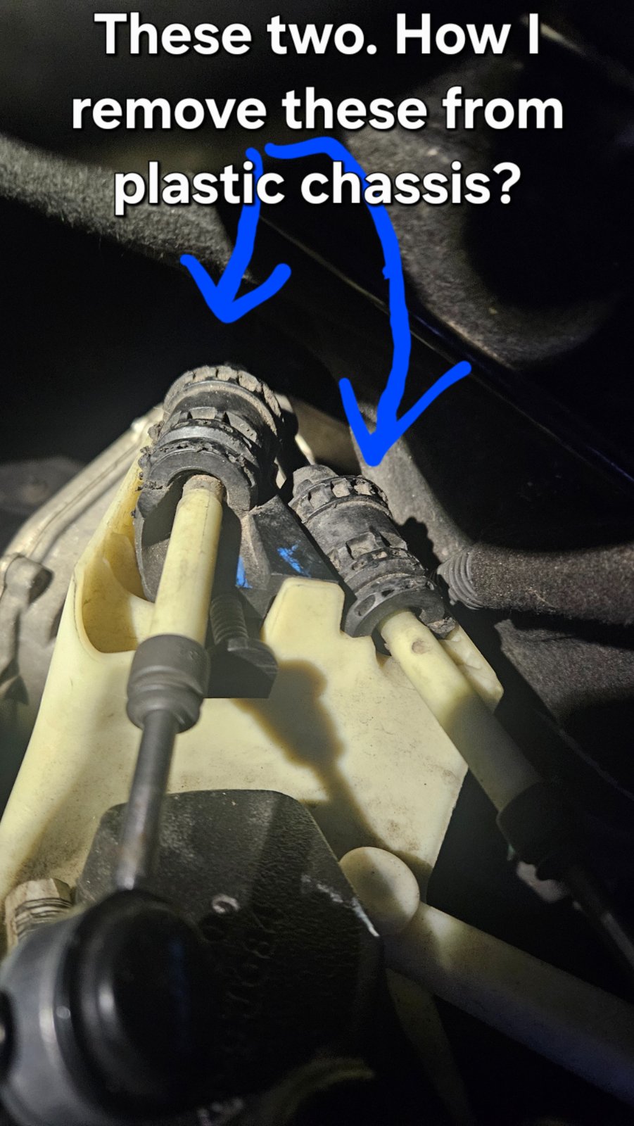

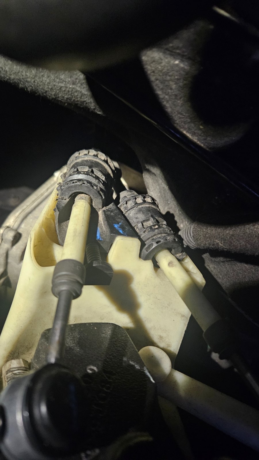

Hello.
I am already released two gear selector cable (shift cable), but both of these lines goes throught yellow plastic "thing" :).
In plastic there is a black rubber and these gear cables goes inside of that black rubber. This black rubber is connected with plastic and I don't know how to remove this rubbers from plastic?
I attach few pictures so you might have easier to understand 😅..

Re: Citroen C3 1.2 (2018) Gear Selector Cable
Will the rubbers slide back along the white sheath? :)
Unread post by Pasi80 »
I don't know, have not tested 😅. I will try tomorrow and tell what happend.
Okay.. there was a bolt front of that plastic. You need to push bolt and it release the mechanism and same time lift those rubbers..
Too easy ;)
