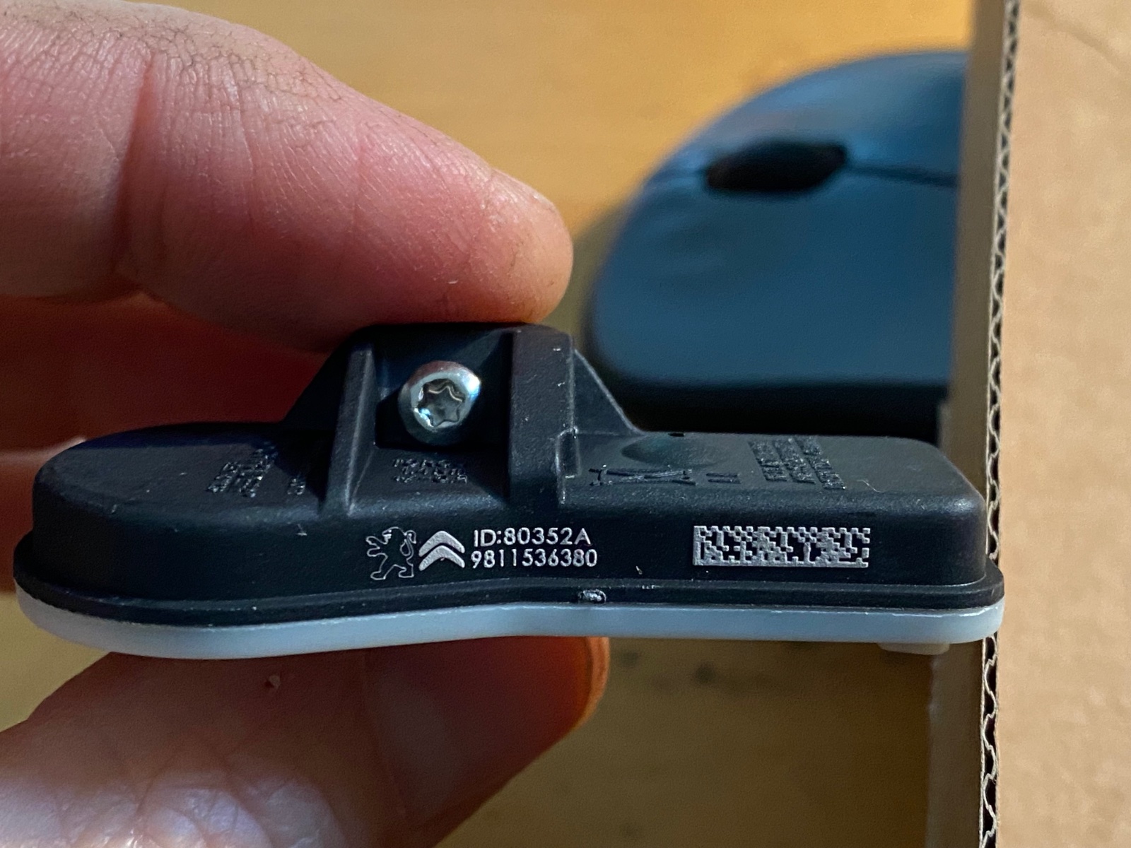

I ordered new tyres and decided to replace the exisiting TPMS-Sensors after all the years.
I did not know, which ones were installed, so I looked around the internet and thought the Schrader OE 9811536380 were the proper ones:

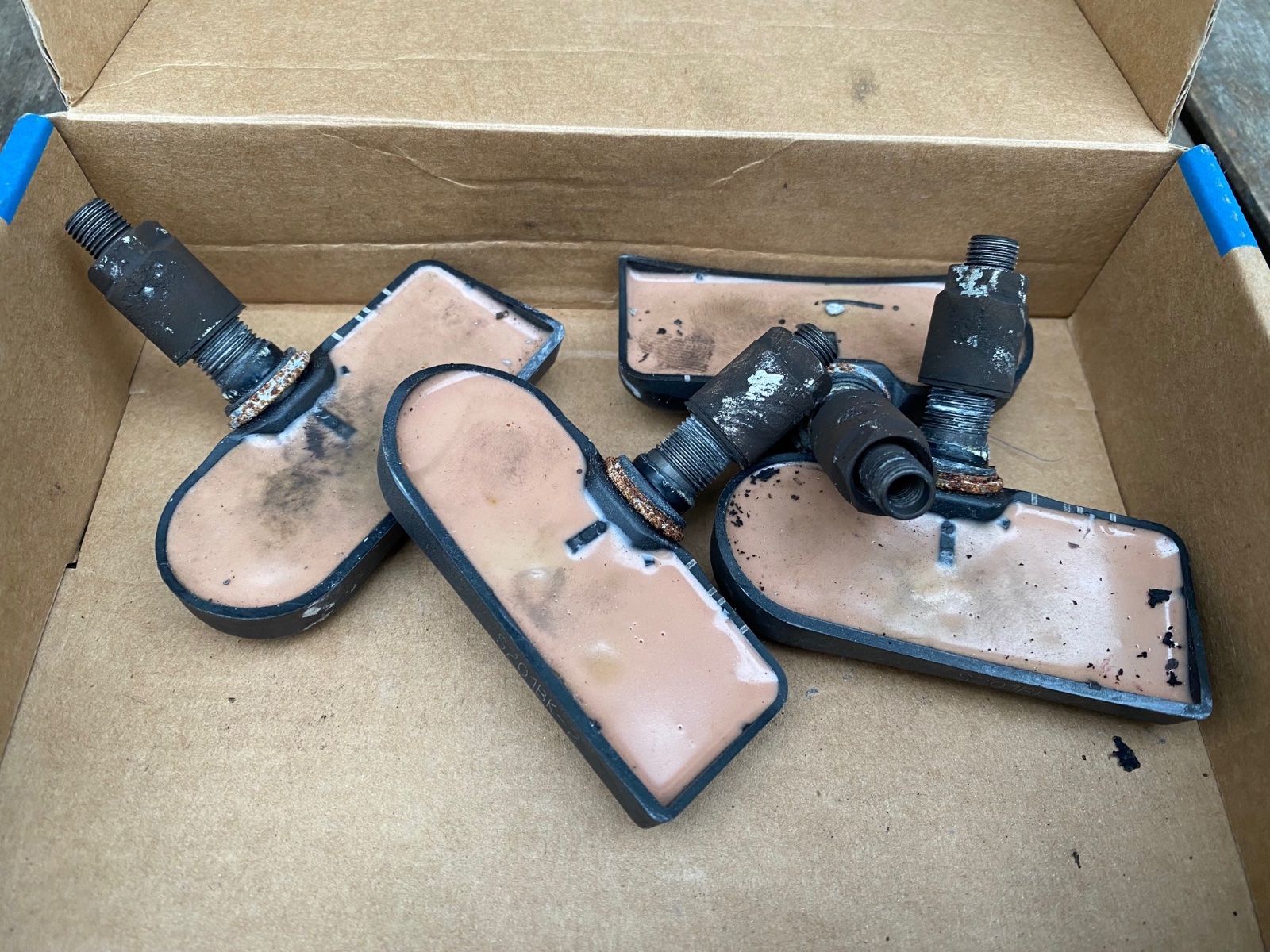

After the tyres were attached I got these old sensors from the tyre garage:

The first thing I noticed: The new sensors ID is 6 characters long, the old one was 8 charcacters.

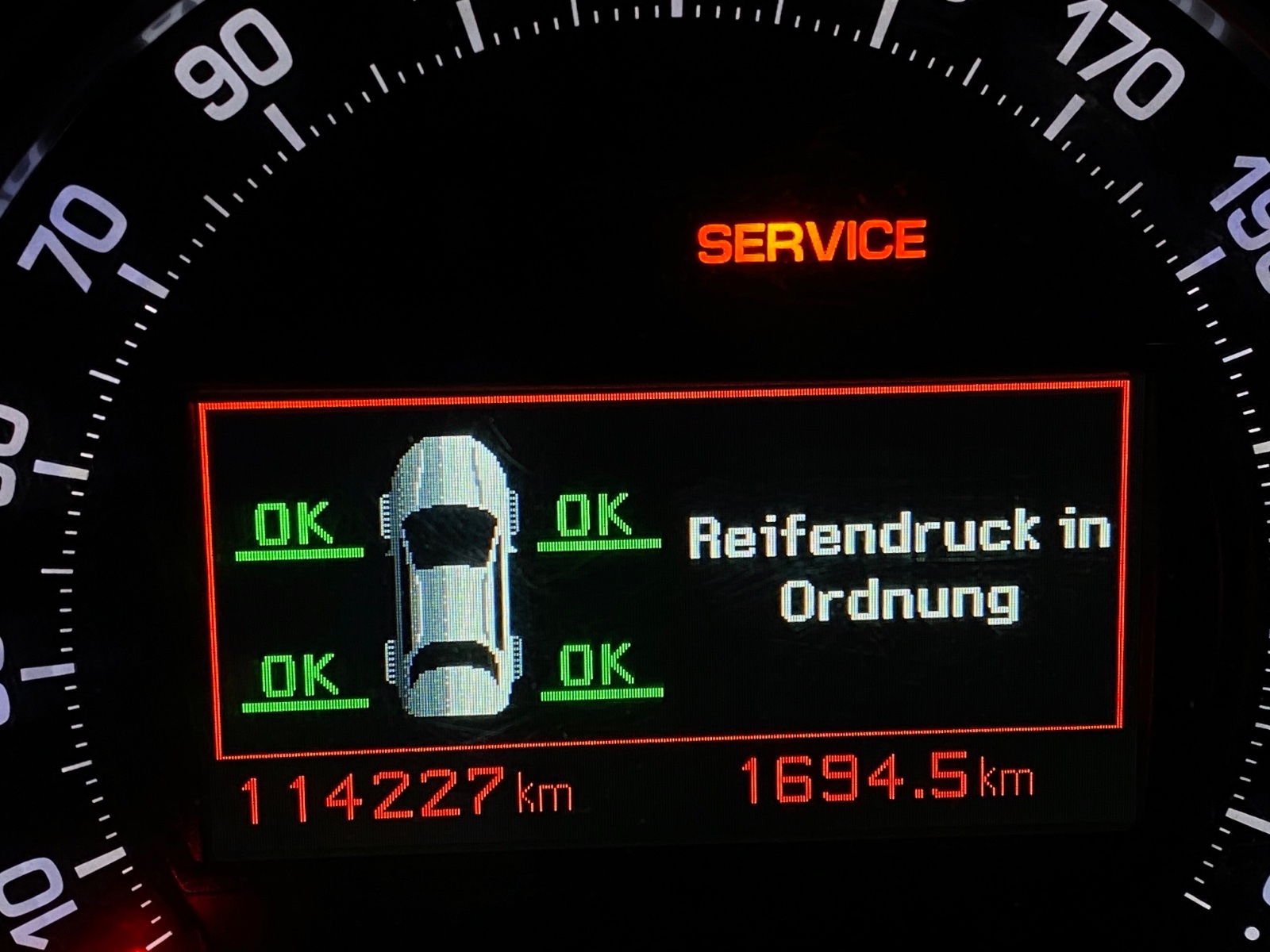

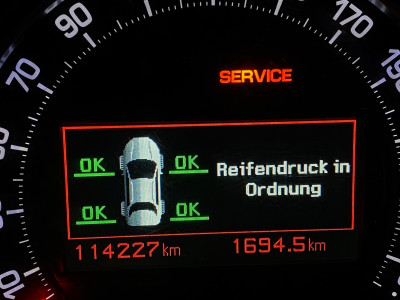

At first this worked, and I got the OK regarding the tyre pressure:

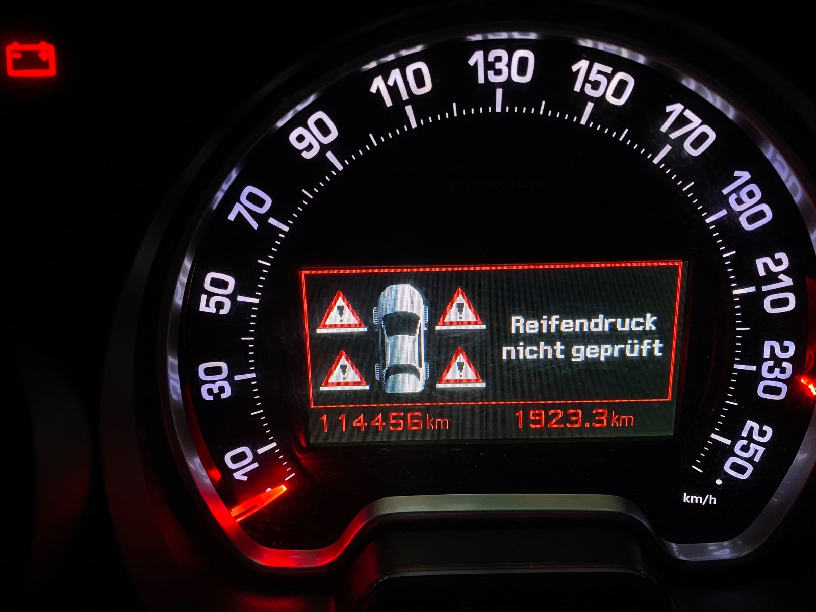

But after a few rides and and few days, I got the message, that the tyre pressure is not monitored, when pressing the "Check"-Button:
So I once again disabled TPMS via DiagBox, reenabled it, everything was OK, but again after a few days the pressure was not monitored any more.
So are the different sensors really not compatible to my 2012 car? Or do I have a different problem?

Why not just replace the battery's, remove the pink gel, then you see the type of battery and Google them. You find them with/without solder lips.
