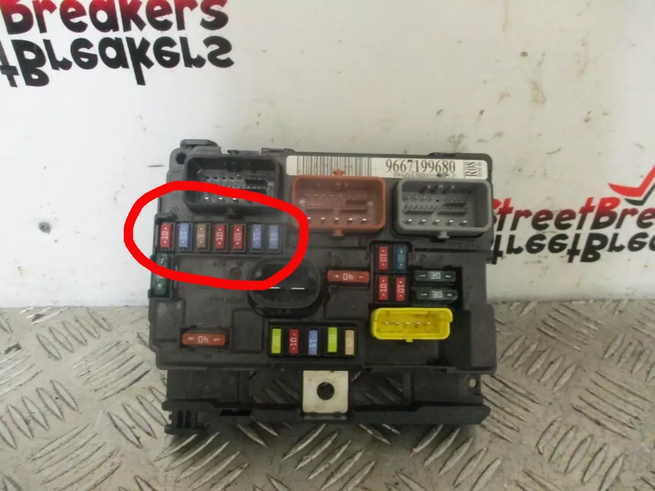

Testing the fuses in the BSM showed several of the ones circled in red are only showing voltages around 2.4v, replaced the BSM as an easy starting point but still the same.
