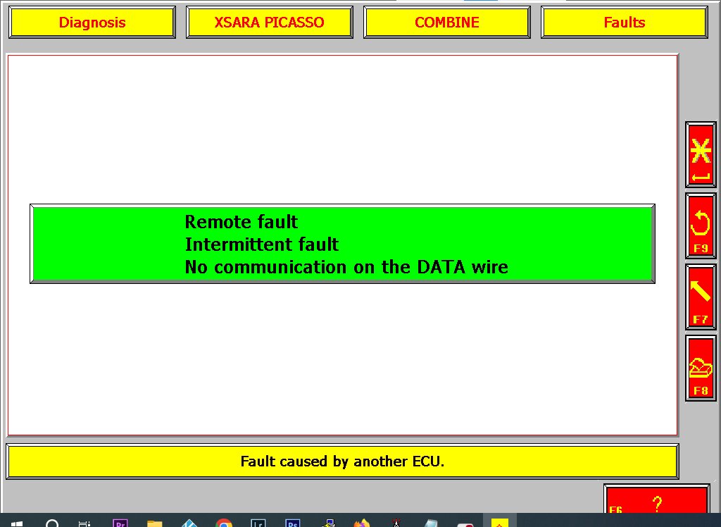

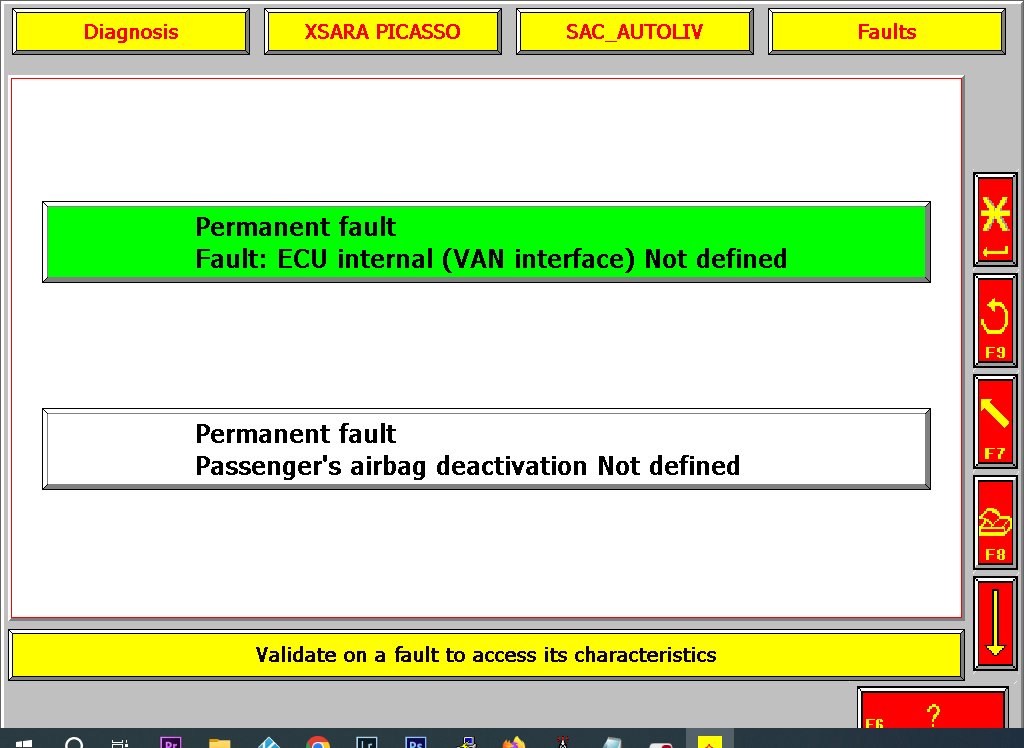

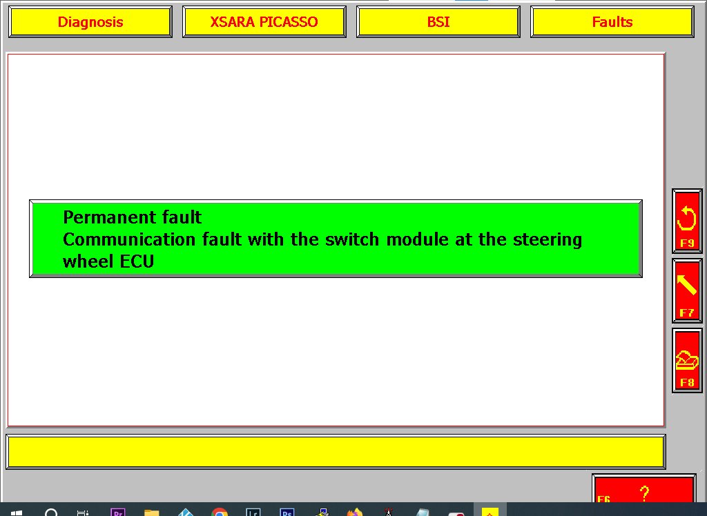

I checked all the fuses and they were all fine. After that I bypassed the Comfort DATA B wire that Lexia was pointing to be the culprit but now I get new errors. The next step I plan to do is to bypass the Comfort DATA wire as well and do another BSI reset (I have probably done 5 of those today and still can't start the engine, it turns but does not start). Battery light is ON (battery fully charged over night, just in case) and the main display is still dimmed.
I attached the 3 latest screenshots from Lexia.

Can you confirm fuses 4, 14 & 15 in the BSI have 12v on both sides with ignition on?

wheeler wrote: 21 Nov 2025, 16:38 Can you confirm fuses 4, 14 & 15 in the BSI have 12v on both sides with ignition on?
With the ignition on F4 has 12v on one side, 2.45v on the other. F14 and F15 have 12v on both sides.

bokis wrote: 21 Nov 2025, 18:11
Unless im missing something that means the fuse is blown?? (or there is a huge volt drop across it)
If the diagram in the other post is the same as yours that fuse is the permanent supply for the radio & com2000 unit.
No power to the com2000 = no start
This would also explain the no comms with the switch module at the steering wheel.
I'd be amazed if this wasn't just a blown fuse.

OMG! When I was testing the F4 for continuity it was beeping, when I took it out it was evident it was burned. Gremlins. New 20A fuse is in, car started. It still shows the airbag error but I will connect Diagbox to it and resolve it...

Now the only errors that are reported on the dashboard and main screen (and in Lexia) that airbags are not functioning. I will try to resolve this today.
