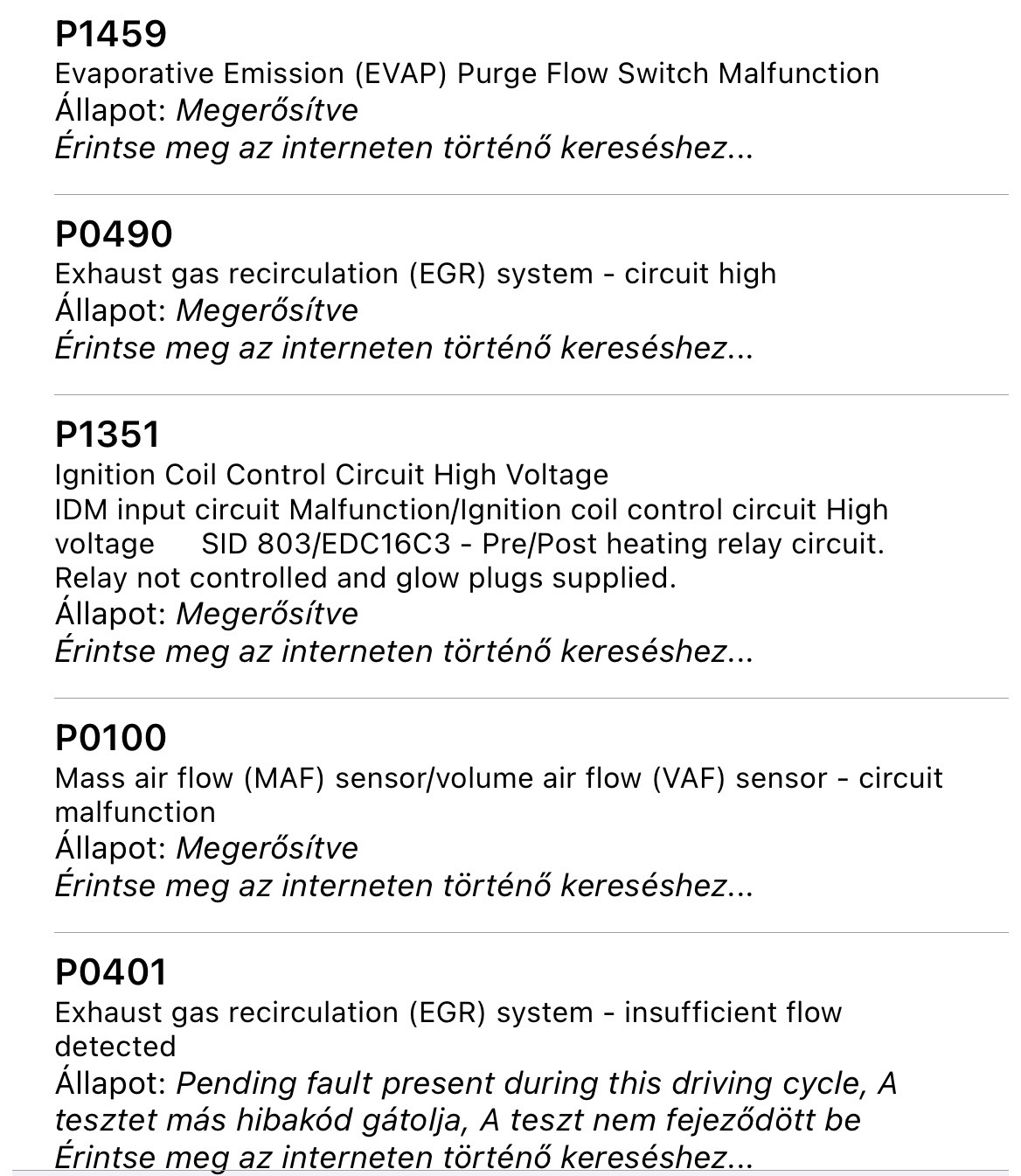

I have a 2008 Citroen C5 wagon (estate) with a 1.6 HDi engine and over 200,000 km on it. Unfortunately, the car jerks in every gear, at both low and higher speeds. It only stops jerking if I press the accelerator hard. It has been to my mechanics, but so far we haven’t found the cause.
One important detail: if I unplug the connector from the EGR valve, the car runs perfectly with no jerking at all.
I would really appreciate any experiences, tips, or suggestions. The MAF sensor and the EGR valve have already been replaced, but nothing changed and the fault codes are still there.
These are the current error codes:
P1459 - Evaporative Emission (EVAP) Purge Flow Switch Malfunction
P0490 - Exhaust gas recirculation (EGR) system - circuit high
P1351
- Ignition Coil Control Circuit High Voltage
- IDM input circuit Malfunction/Ignition coil control circuit High voltage
- SID 803/EDC16C3 - Pre/Post heating relay circuit.
- Relay not controlled and glow plugs supplied.
P0100 - Mass air flow (MAF) sensor/volume air flow (VAF) sensor - circuit malfunction
P0401 - Exhaust gas recirculation (EGR) system - insufficient flow detected
Thanks in advance for any help!
Error codes

The EGR has been calibrated (relearned), but the fault is still present. The car is jerking/shuddering, and the fault codes are still there. However, it’s possible that two injectors are not operating properly or are faulty. Could this also cause the jerking?
