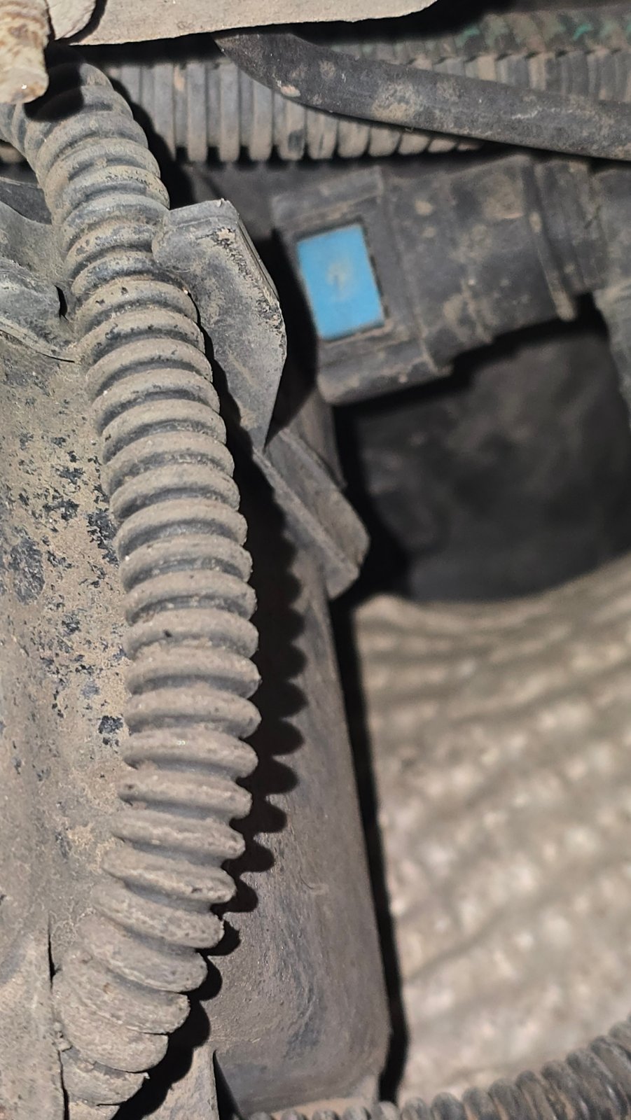

My apologies in advance if I am posting the same question asked and answered elsewhere, but 20 minutes of searching has not got me to a more correct point.
In ignorance, I never knew until the last few deays that there are several different types of Eolys fluid, and I have a strong feeling that I jumped in and bought the wrong stuff.
My (July 2015) C4 Grand Picasso II B78 2.0 Bluehdi 150 EAT6 Excl. must be gasping for fluid at 82k, although my (non-PSA) diagbox says it still has 400ml in it, so I bought some, and only found out after purchase about the different fluids (STUPID BOY, PIKE.!!)
The car has both DPF - Blue pipe connector plug - and Adblue systems.

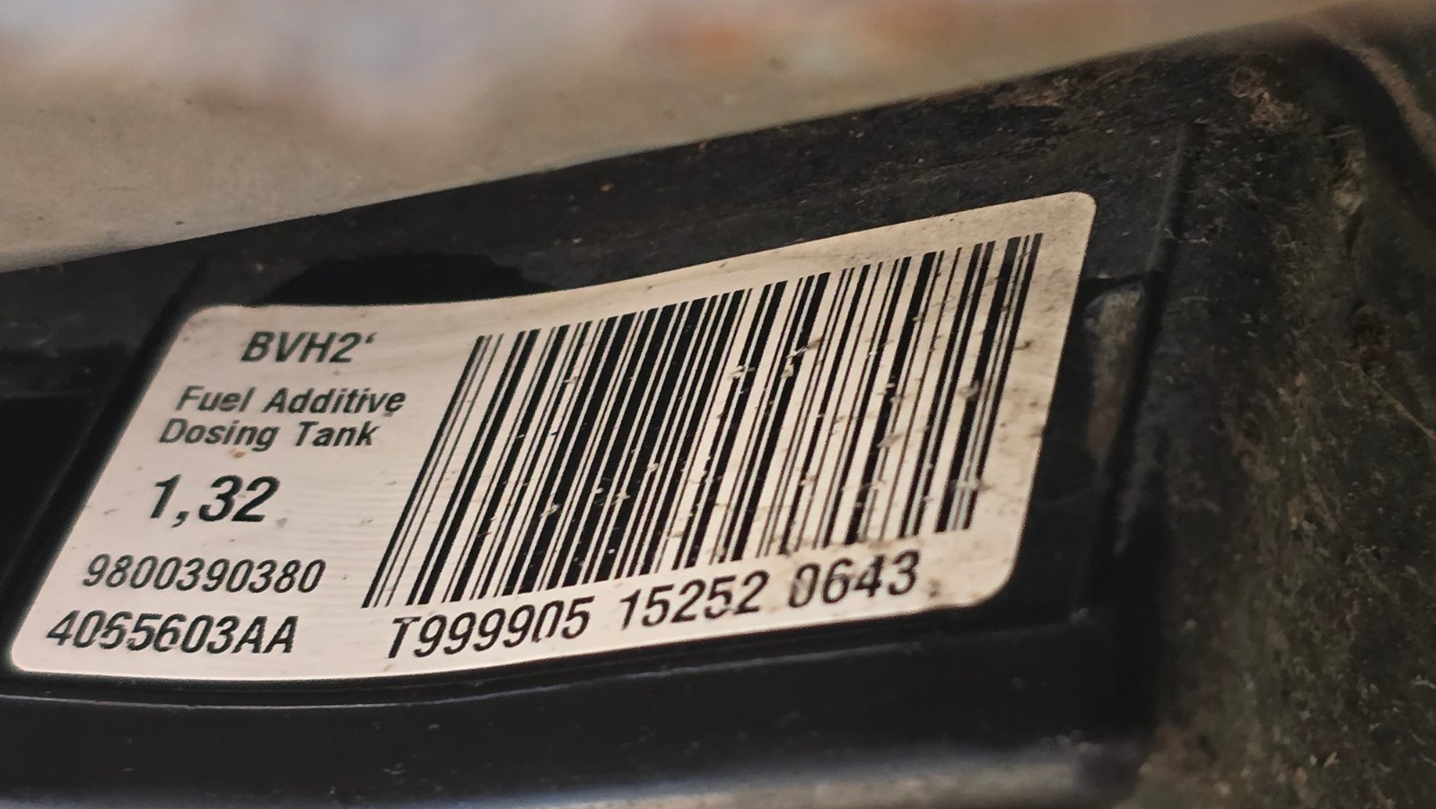

Re: Correct Eolys Fluid for 2015 Grand Picasso !! B78 2.0 150hp
Almost certainly Powerflex, but assuming you bought a generic fluid, and it covers all 4 generations, then it should be OK. 400ml remaining after 80k miles is not unreasonable if you only fill the fuel tank from empty to full. I think the number on the tank (1.32) is the amount (in litres) it contained from the factory - so you have possibly used coming up on a litre, and sticking one in and resetting the computer is not a bad idea. Will probably see out the car....

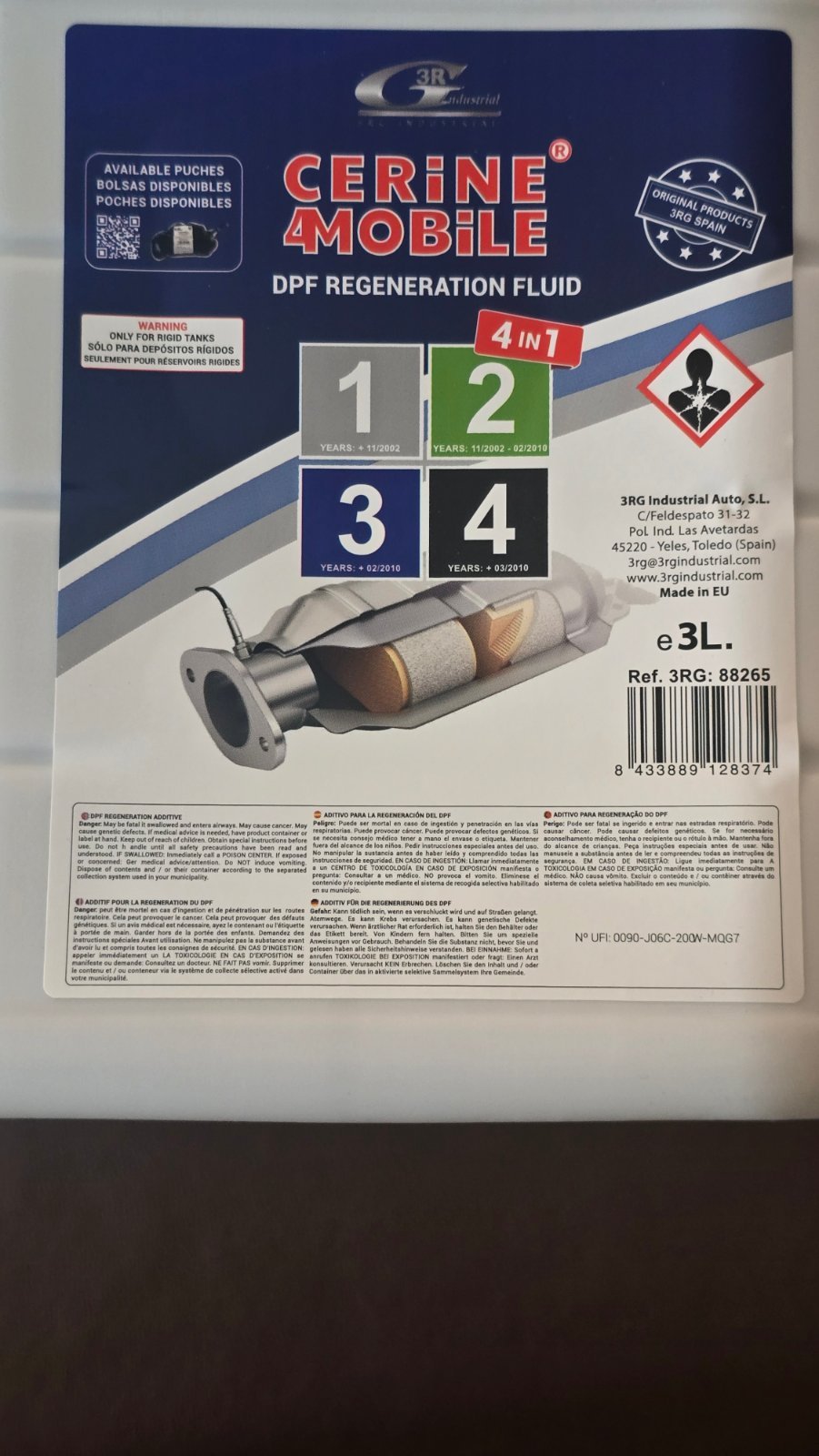

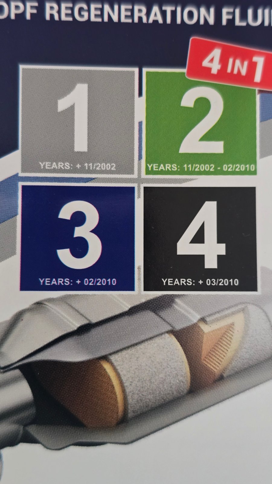

Good day, @Richard
The potentially wrong fluid has arrived, I am mindful that EBAY says this is NOT for my car, but following your words from yesterday, do the attached photos show that is OK to use? Would you trust it? If not, I will return it and buy one that EBAY DOES like (I will not sue you for your opinion). This is made in Spain, which, of course, is no reason to reject it, but.... The 1,2,3,4 bit on the label suggests it is good for all engines from the dates shown, but I've drunk snake oil before, and it can hurt.....
Thanks in advance
WillyR
Thanks in advance
WillyR
