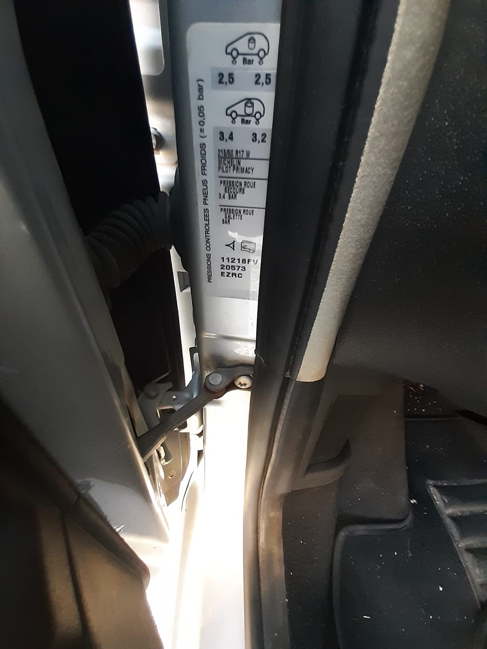

I apologize for not responding in time, but I didn't have the car available.
I have no idea what an RPO number is. I searched the forum and from what I understand, it's one of those numbers.
I apologize and thank you again.
Posts: 21253
x 8134
Re: Weird A/C problems in my Citroën C4 Picasso
Yes the RPO number is 11218. It is needed to get the correct information from the Stellantis database for your car. I can only try and find the diagram for the heater control circuits which I will do in the morning as I cannot get on my system at this time. :)

The rpo number (production date code) is 11218FV with the fv being the factory. Giving 27 July 2007 and the Vigo factory in Spain http://www.citroen-ds-id.com/gen/Gen_Organr.html
EZRC is the paint code so grey aluminium.
