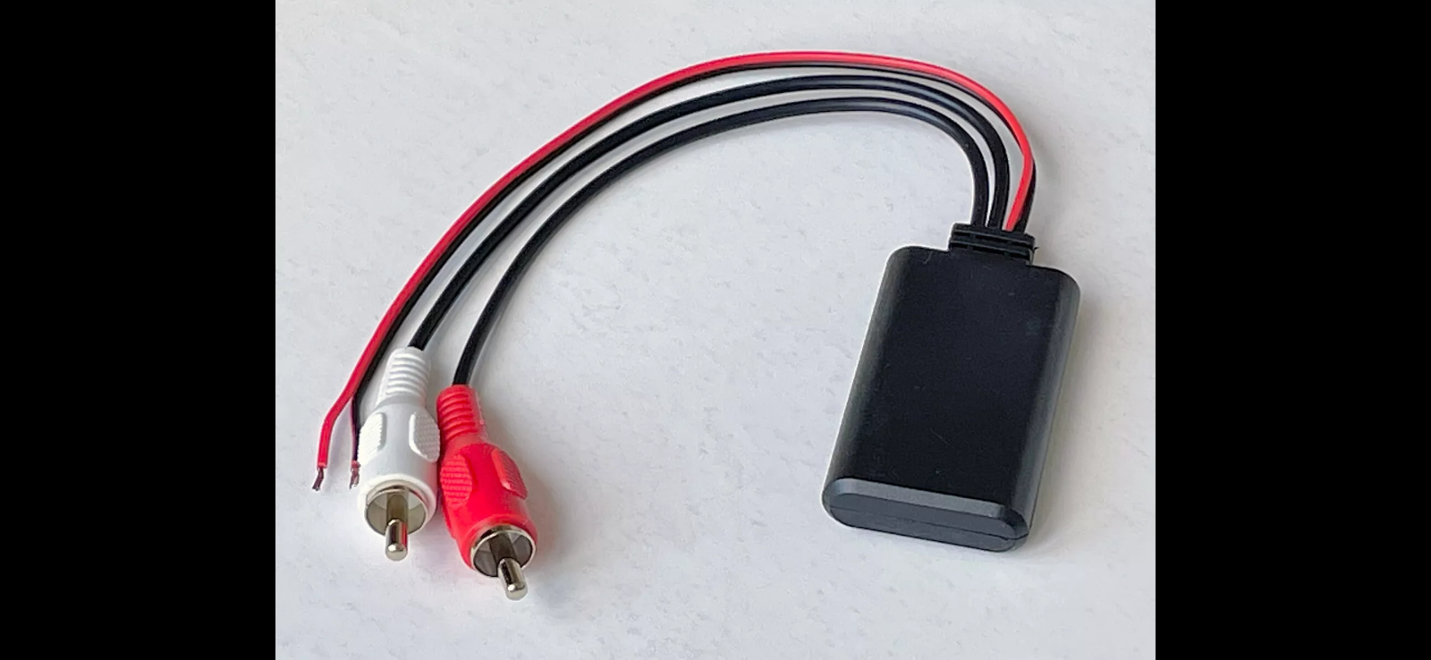

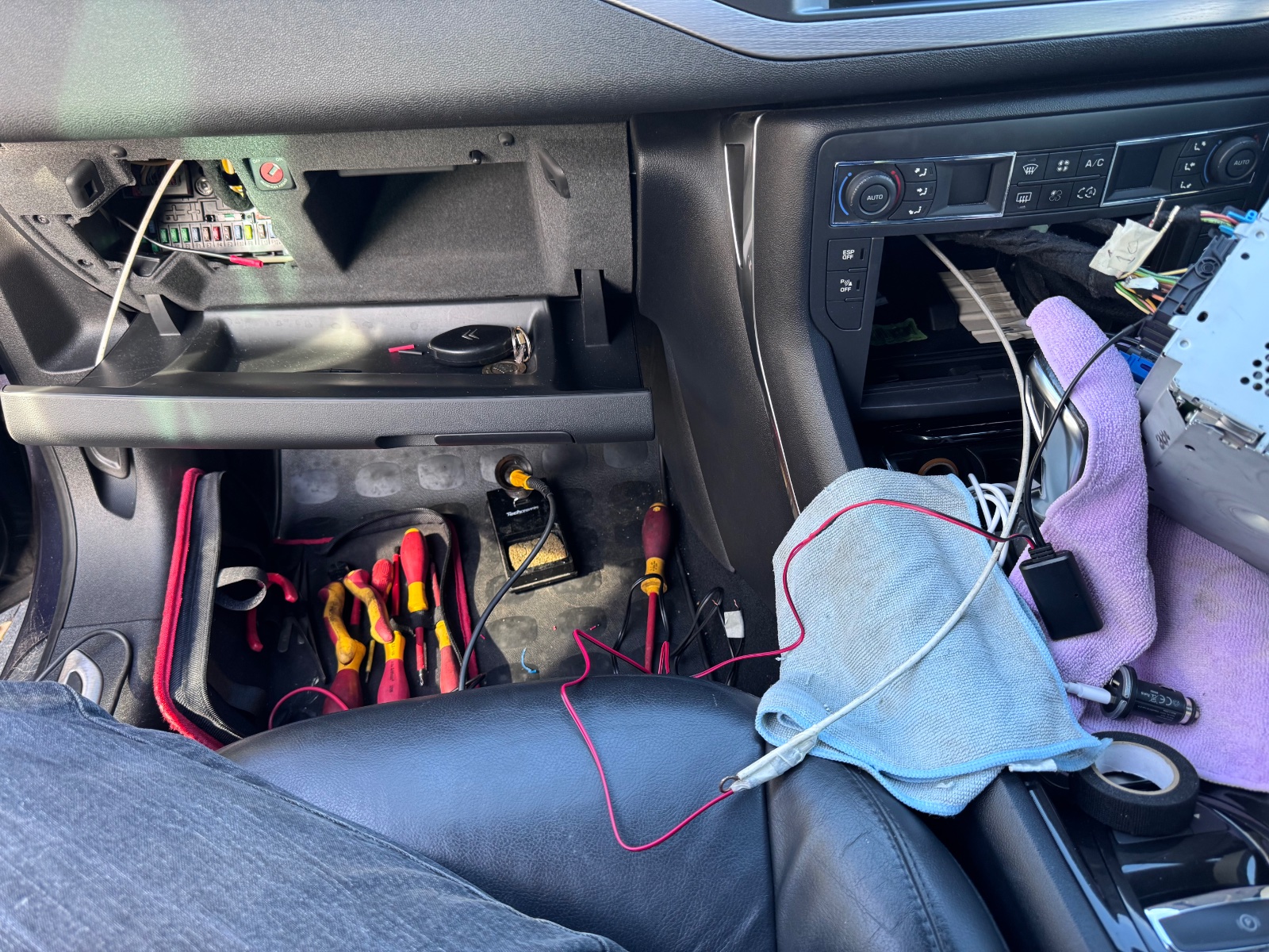

Originally I bought a generic automative Bluetooth to RCA out Bluetooth adapter from eBay - one of these.

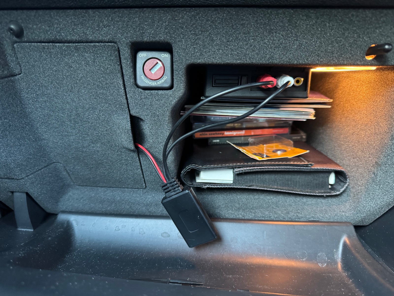

This would just plug into the two RCA audio in sockets in the top of the glovebox, but it needs +12v and ground.

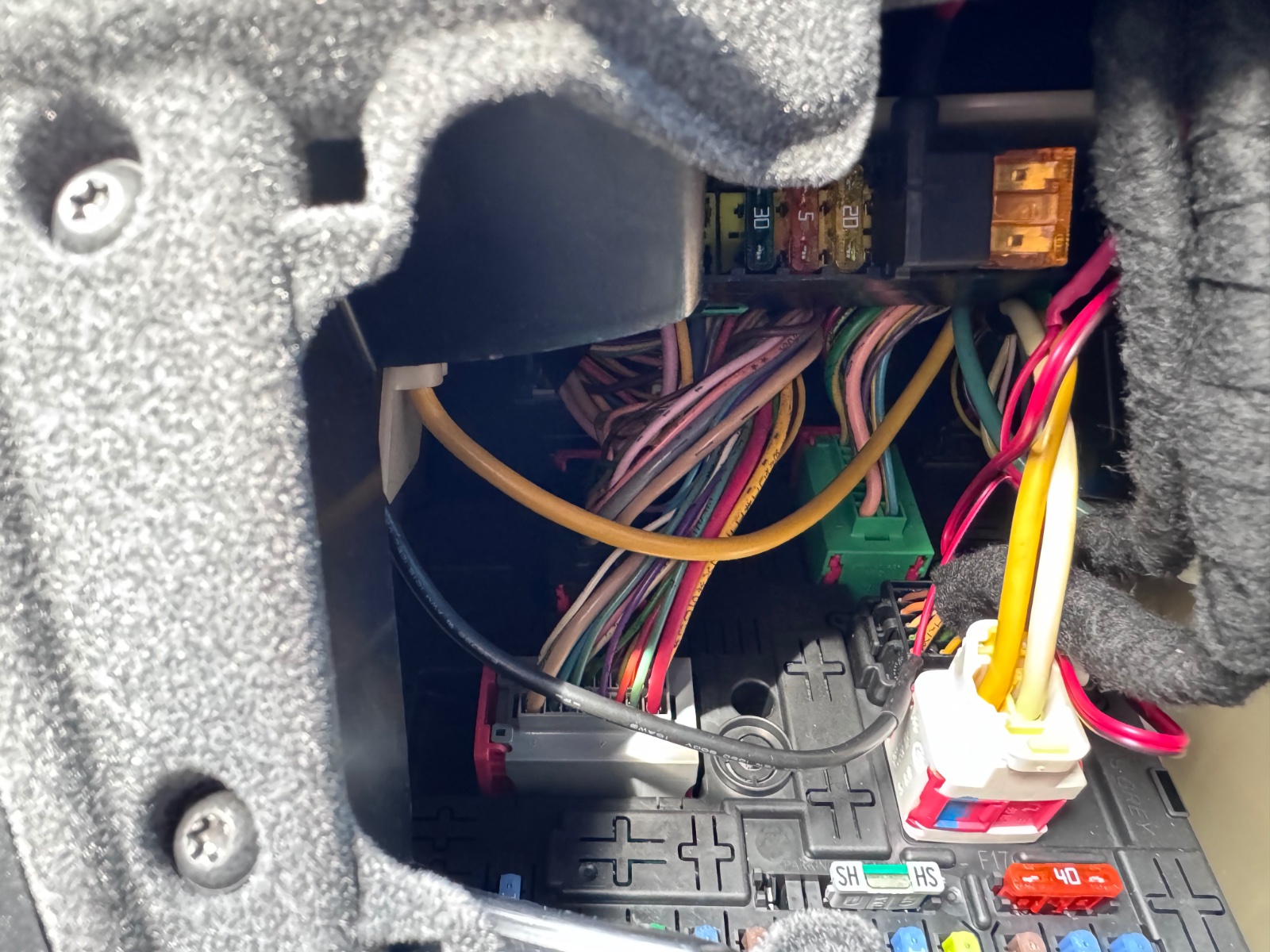

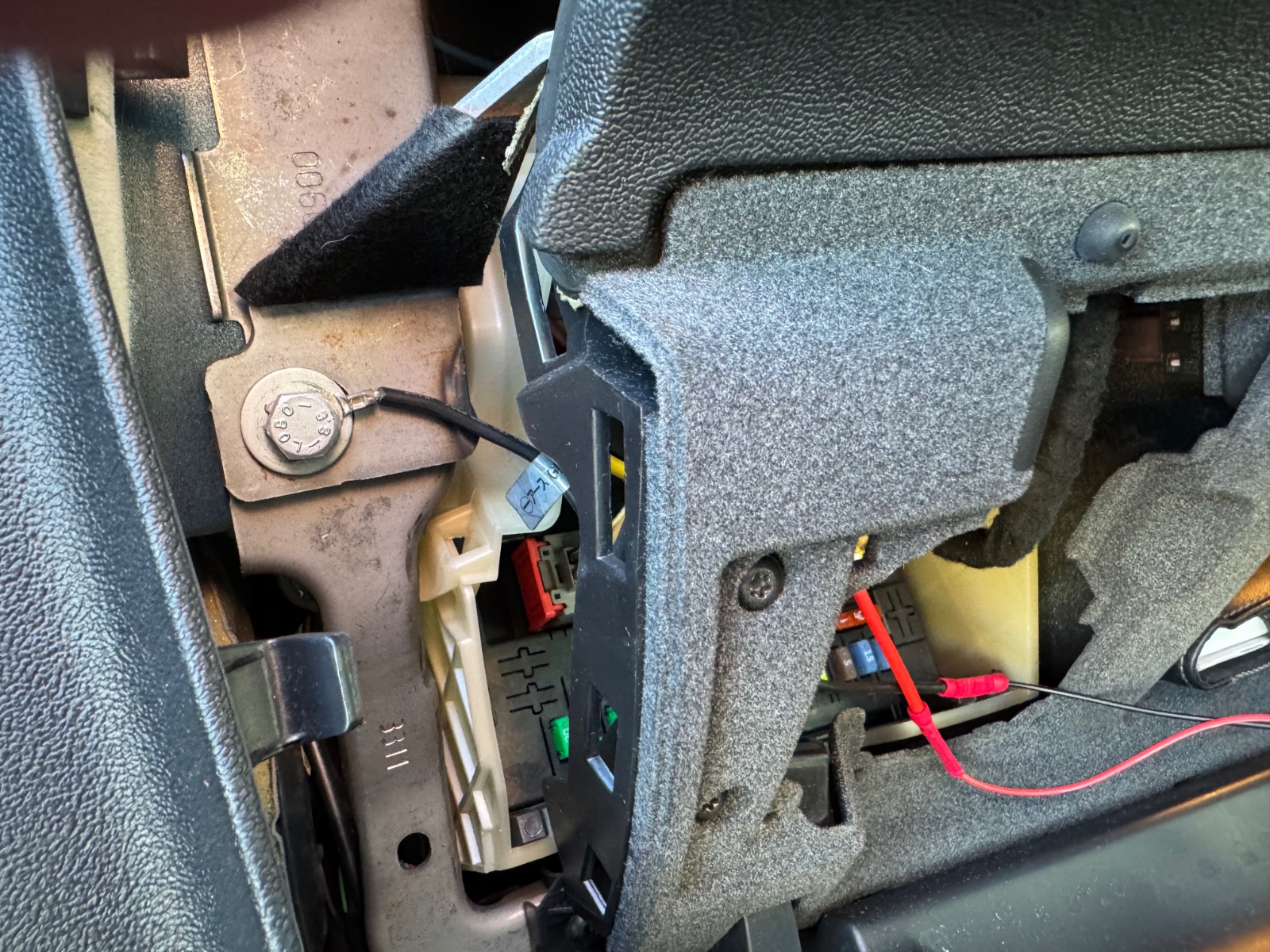

I didn’t want to hack into any of the original wiring, so I took the trim off the lower a pillar to find a bolt on the side of the dashboard that could be used for a good ground and ran a black wire into the fuse box area.

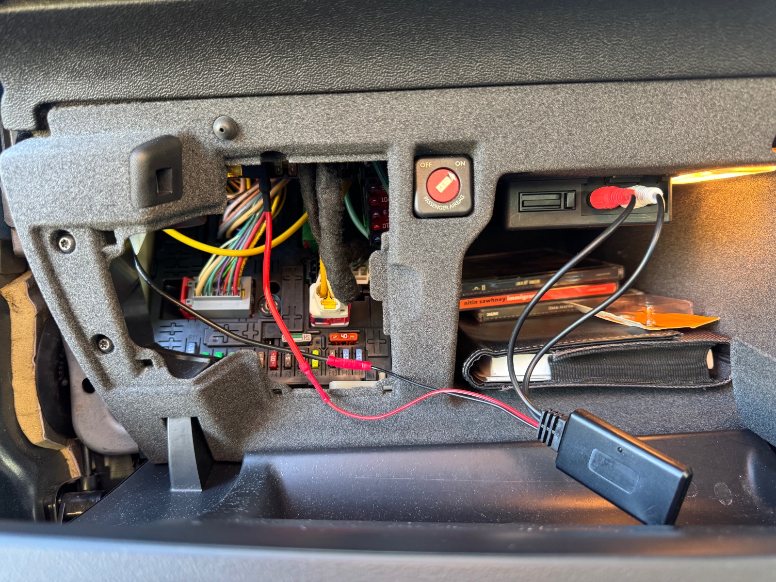

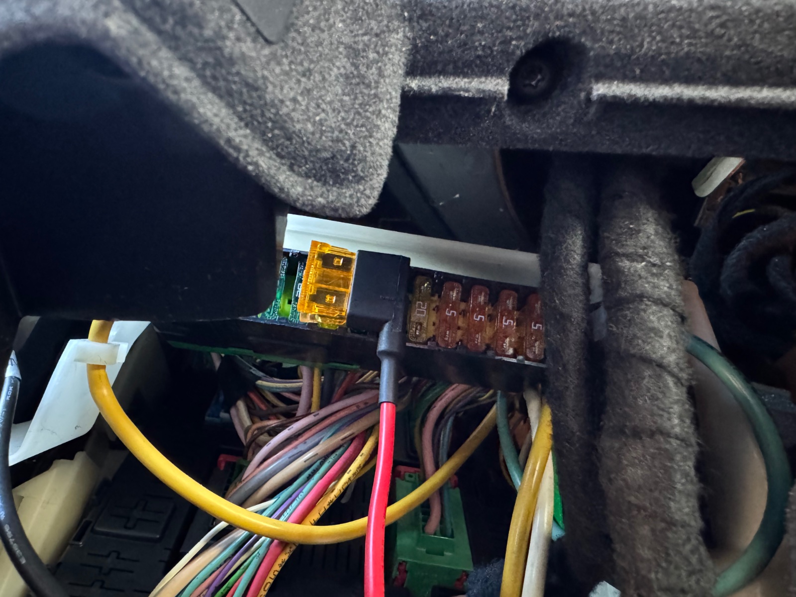

For power, I bought one of the plug in ‘fuse tap’ adapters from eBay and identified one of the fuses at the top of the fuse box that is switched 12v (didn’t want it to be permanently on). Wired both those in to the power, ran the power cables out the fuse box cover through where you pull on it to pull the cover off and plugged the phono plugs on the sockets.

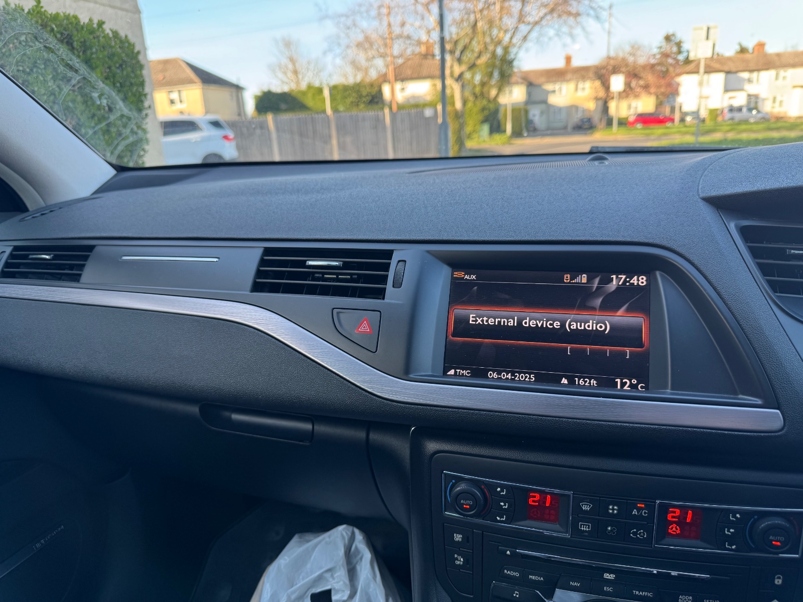

Connected it up and set the headunit to ‘aux in’ and it worked. However it was a bit quiet and I wasn’t hugely impressed with the sound quality - wasn’t sure what the issue was.
I kept my phone Bluetooth connected to the headunit so it used that for calls but via the eBay adapter for streaming. All worked fine and automatically swapped between the two for incoming calls.

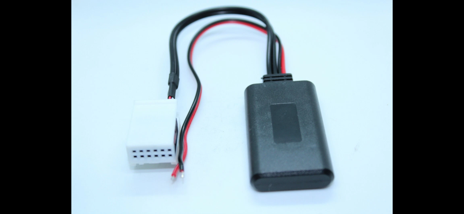

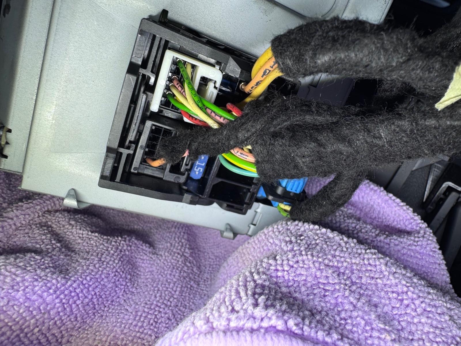

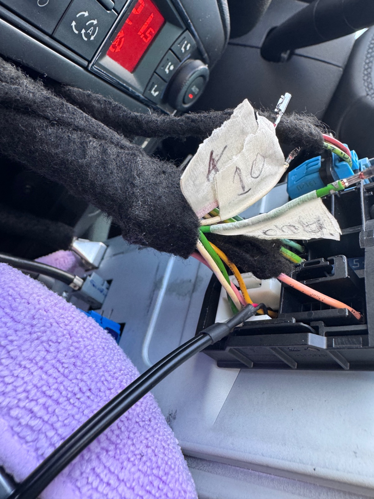

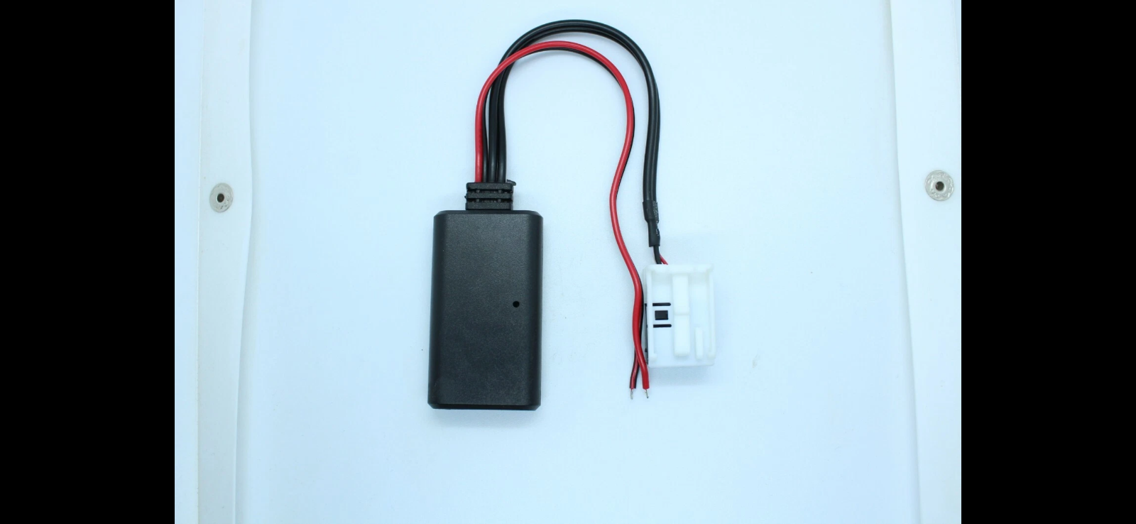

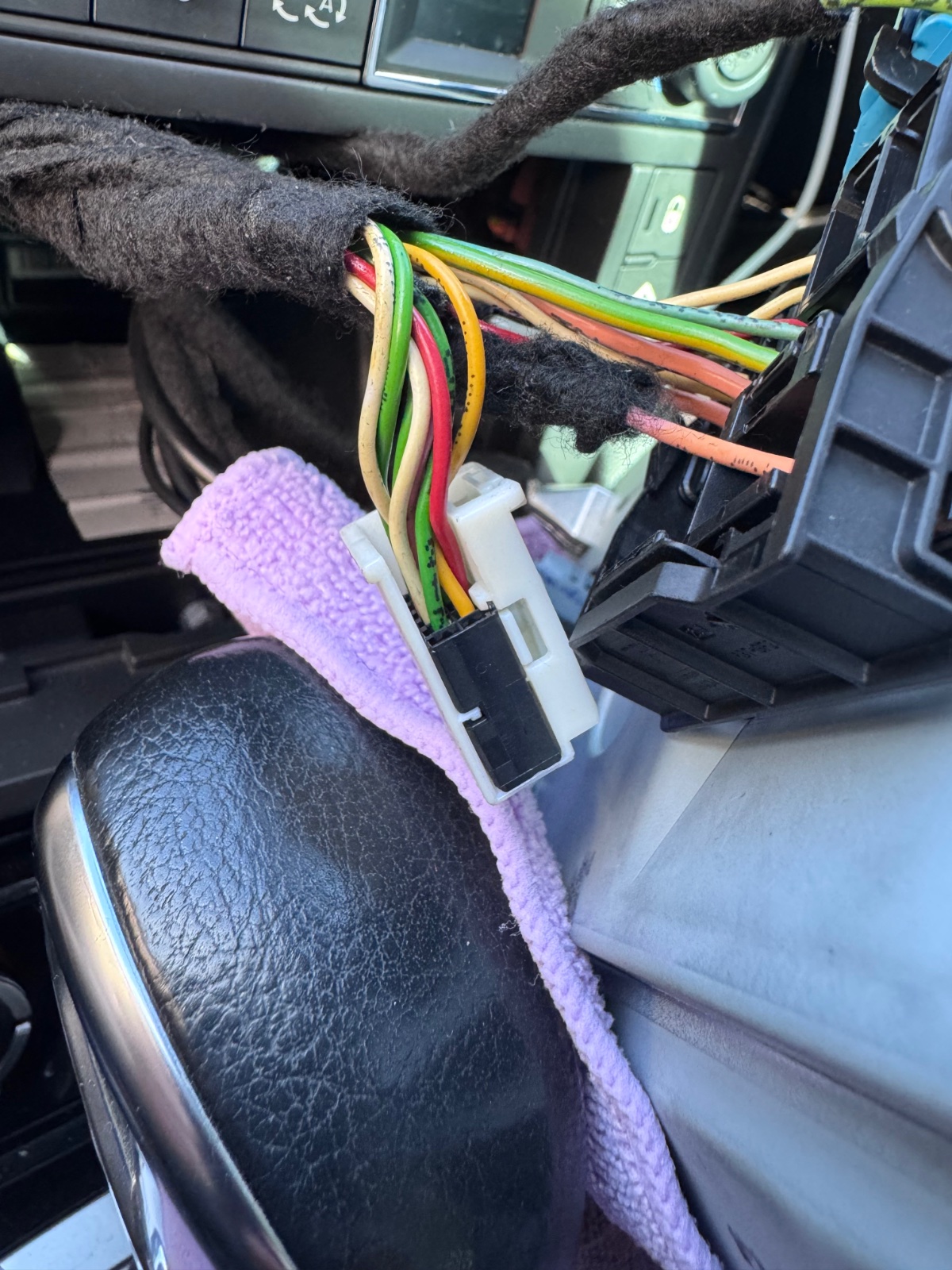

I wasn’t really happy with how tidy an install that was, so I bought one of the plug in adapters intended for the RD4 in the hope I would be able to sort out plugging that in to the back of the headunit (I was thinking into the autochanger inputs while leaving the aux)
Today I fitted that. I didn’t go for the autochanger inputs but instead I de-pinned the plug that came on the new adapter and the original factory wiring three pins that feed the ‘aux’ sockets into the connector on the back of the headunit - and swapped them.
I ran power and ground through over the top of the glovebox, by feeding through from the headunit area (I use a mesh curtain chord that I bought from b&w years ago as a cable chaser to poke through and then tape the cables to the end and pull through)
And then soldered it up to the ground and power I’d previously installed.
Everything now completely hidden inside the dash.
Works perfectly - let’s see how long this one lasts (hopefully it doesn’t die as quickly as the last one!!!).
I think this sounds better than running it through the aux sockets. Not sure if that’s just a factor of less connectors and wire length, on what is a very low output device.
