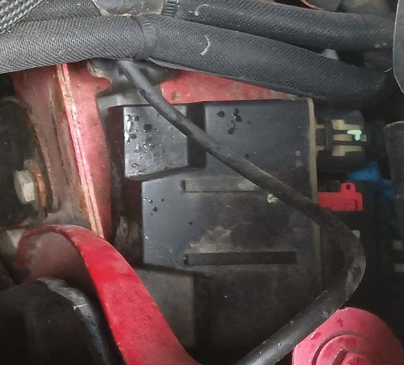

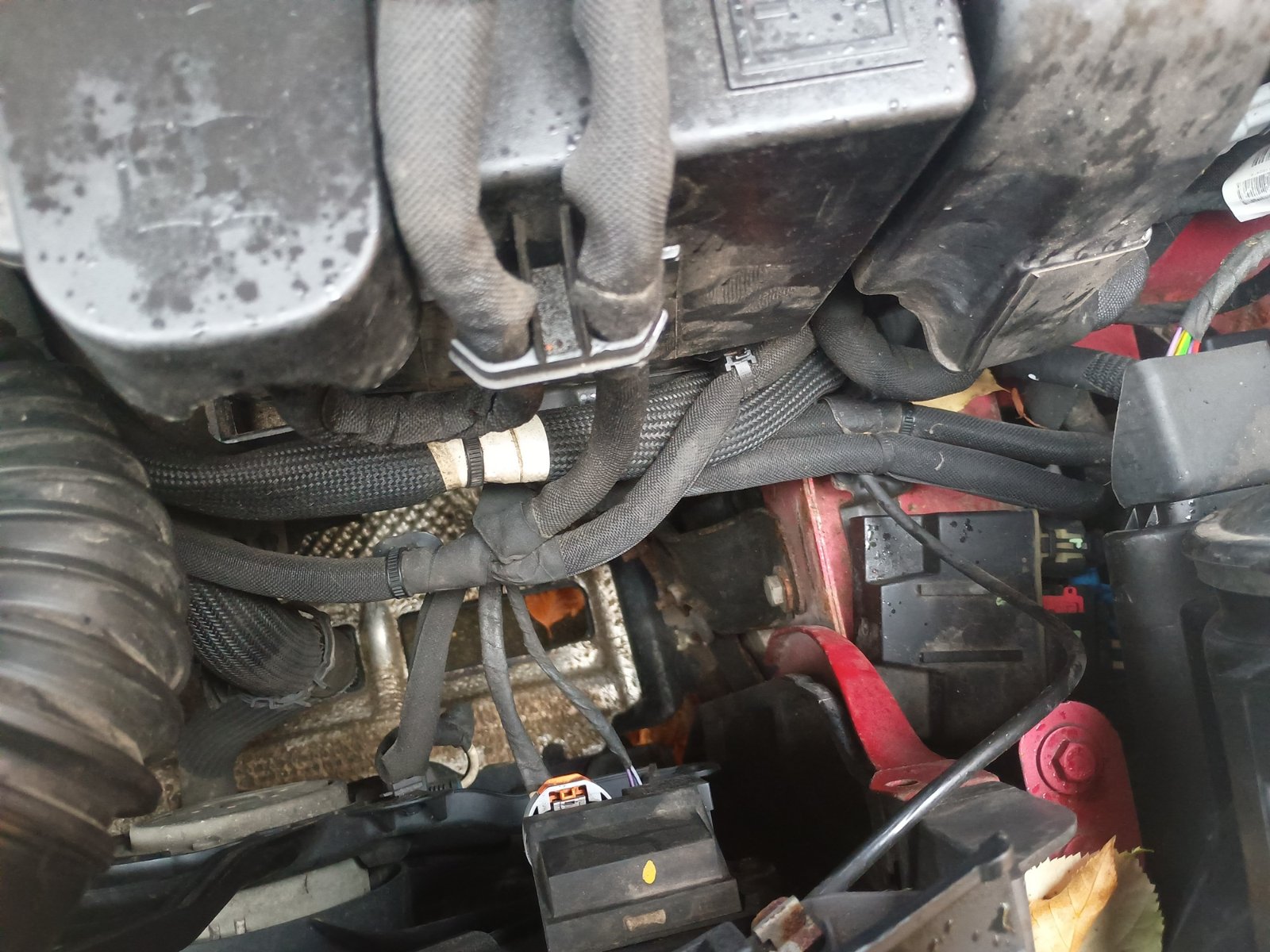

Does "Additional heating 1 command" refer to glow plug on cyl 1?
I thought that a good place to start would be to check the resistance from the glow plug relay to earth for each plug to see if any wires/ plugs are defective.
I can't find the relay though !
Anyone know the location please?
I've found a relay underneath the air intake but I'm not convinced it is the GP relay. It has two plugs. There is also a relay sitting horizontally on the left wing? Does anyone know the pinout please for which pins go to each plug?

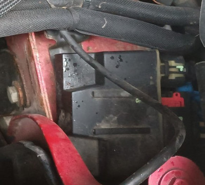

Thanks. I've seen that video.
However my DS3 is different as shown in the photos.
I would like confirmation that I have the correct box and also the pinout. I can't find any DS3 wiring diagram online.
Plus of course, do P1403 and P1404 refer to glow plugs?
