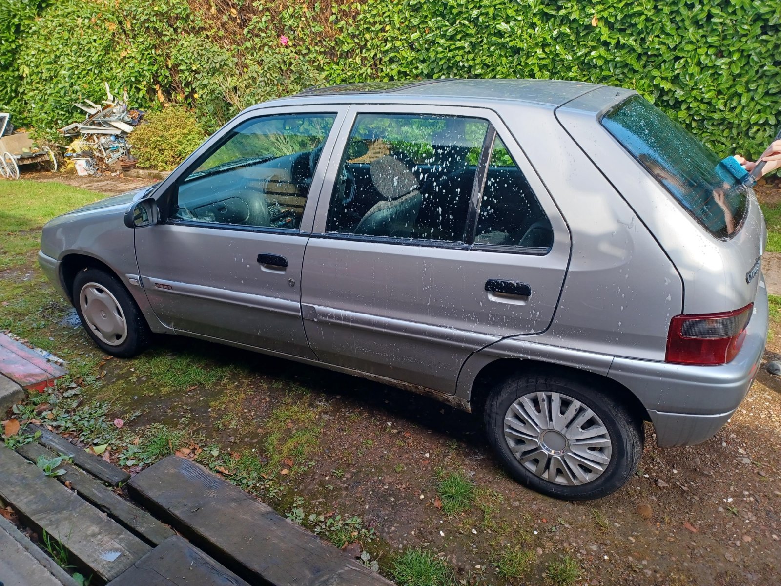

Just bought a 1998 Citroen Saxo Expose for my son. Mot till the first quarter of next year and was taxed but had blown a head gasket - hence it was cheap and saved it from scrapping. 85K and only three owners from new seems a very straight car with nothing molested. Plan to strip the head and and allow the lad to learn a little more about the working of the car. Having difficulty with finding the crank locking pin point - think I have found the hole on the crankcase but cannot get a pin to locate with the flywheel. Camshaft lock pin in place but crank will not lock in any position. Also think I have a airbag fault but not certain. Have heard car run and did hope when I found the thermostat seized that we had found the problem but sadly I think that this seizure may have been the undoing for the previous owner.
