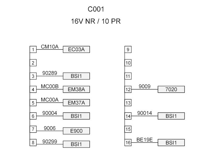

So, I've been doing some quite in depth messing around with OBD on my 2008 207cc 1.6Hdi.

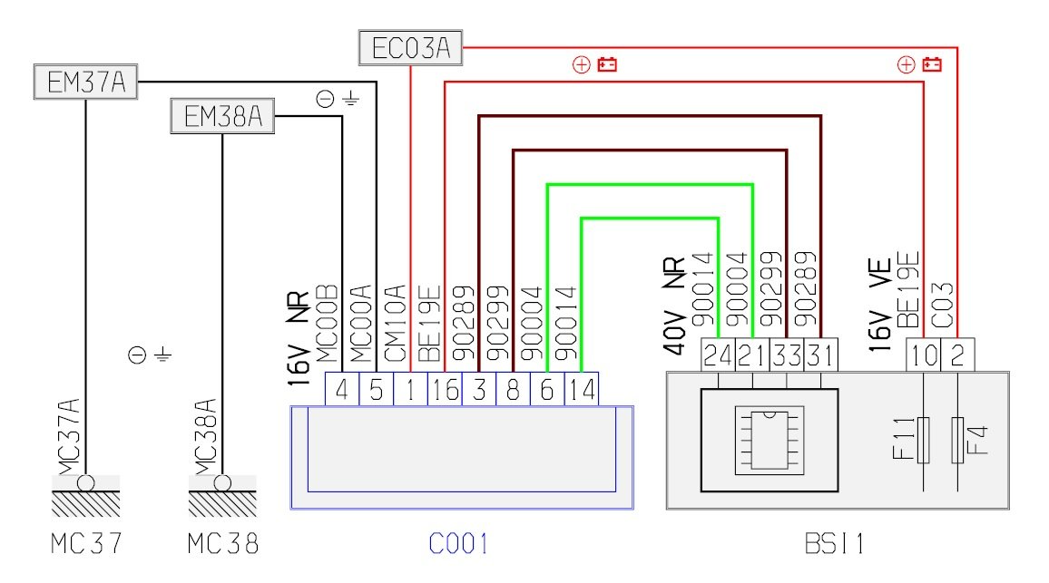

The diagrams in ServiceBox indicate that the 'CAN IS' is attached to a 250kbps CAN bus on the J1962 standard pins 6 & 14.
Also... it indicates an ISO14230 'K Line' directly connected to the engine ECU on J1962 pin 7 and a non-standard 'DIAG CAN' at 500kbps connected to the 'manufacturers use' pins 3 & 8.

Connecting an Actia/Lexia with a Y adapter indicates that Diagbox exclusively uses the alternative CAN bus on pins 3 & 8.
My only useful bit of this so far is that by using the K-Line direct to the ECU you can erase engine fault codes without the BSI trying to log them in it's memory.

I've definitely found that the BSI (connected to the 6/14 and 3/8 interfaces) is the gatekeeper/filter to the rest of the ECUs.
Edit: I've also just noticed there's another 'K Line' direct to the ABS ECU on Pin 12

Next step would be to wire the ELM327's CAN bus to the DIAG CAN on 3/8 and monitor what Diagbox does.
The CAN IS on the J1962 pins appears to be for information only as none of the ECUs that Servicebox lists as being connected to it respond to UDS messages on their main addresses, implying that the BSI is acting as a kind of firewall.
