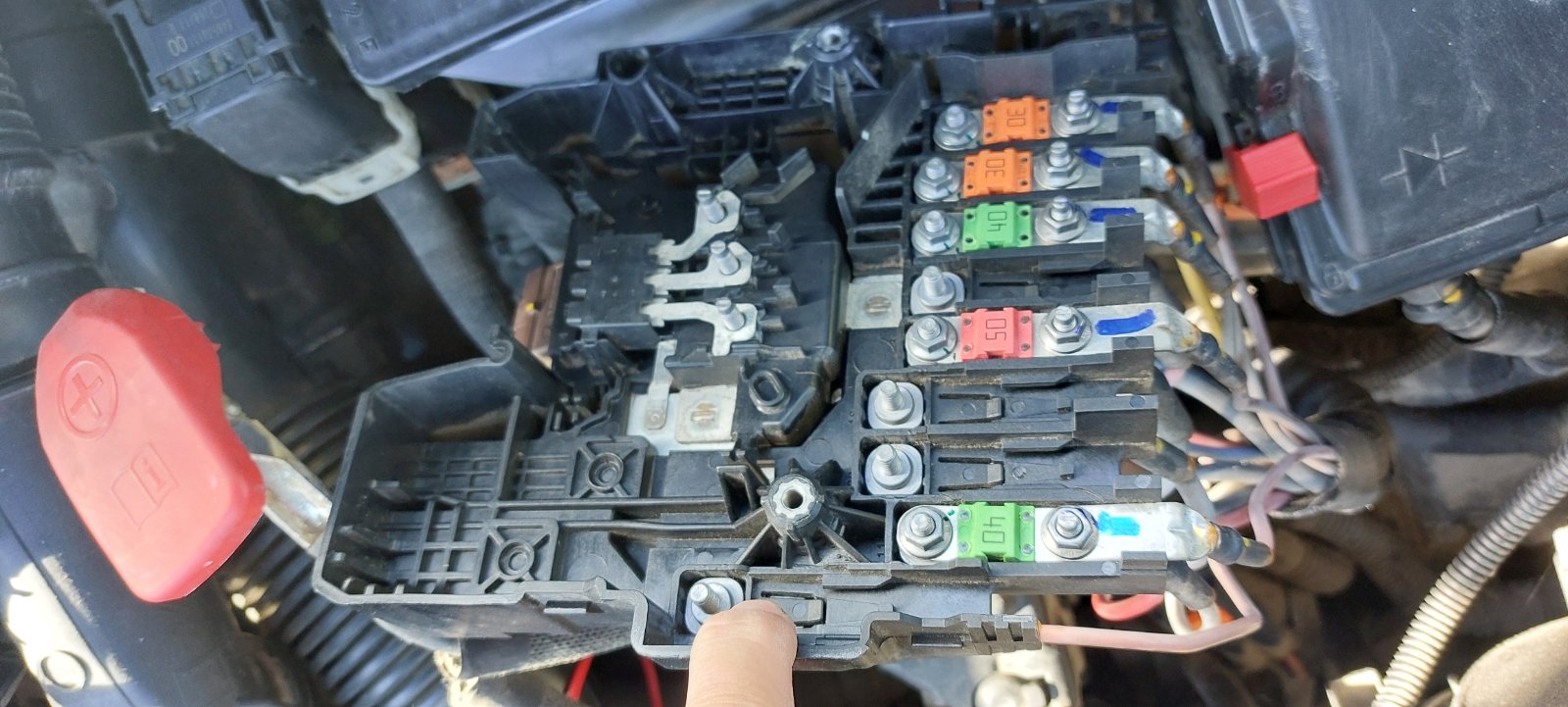

Garage says, to replace BPGA, but I have opened BPGA and checked, so for the first looks like fine.

Sounds like a short in the BPGA to me too. Open it and make sure it is completely dry with a hot air blast for a good time. Then see if the sound disappears.

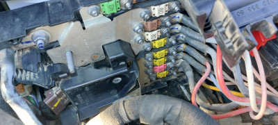

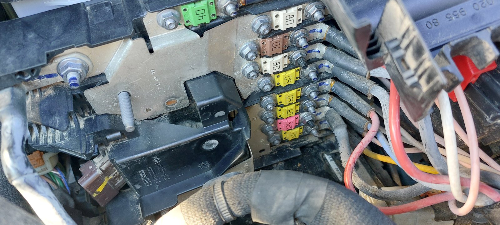

Regarding BPGA, It was opened last week, no weakness found. All fuses are OK, I tighten all bolts.
I didnt see any relay inside.(look for pictures, if any Idea)
