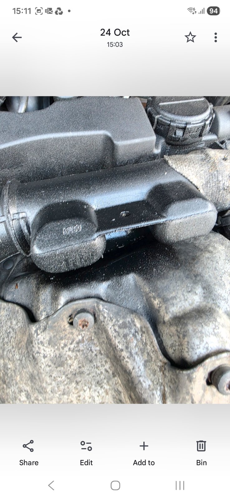

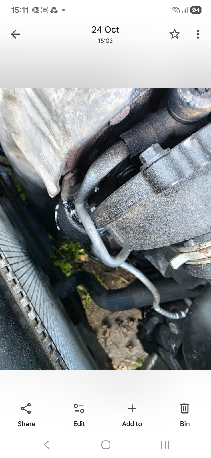

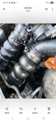

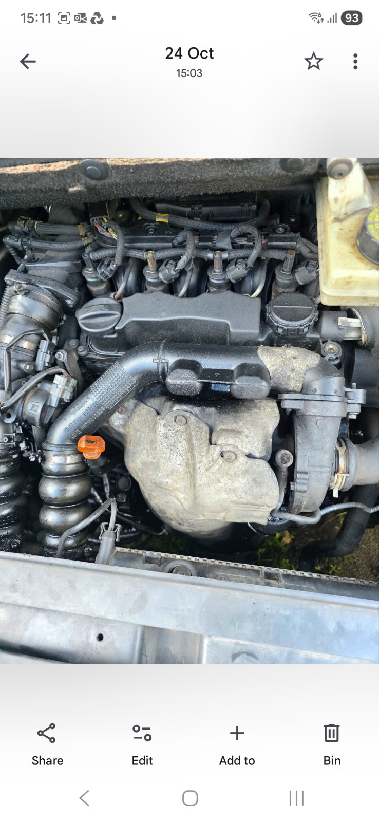

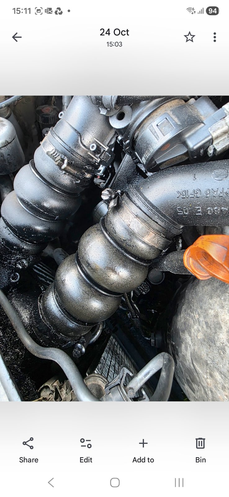

I popped the bonnet today as been using car fair amount recently and have noticed oil is everywhere! Is there any common places for these engines to leak so badly ! I have attached some photos for reference, thank you.

Looking at the way that has spread I'm tempted to think you may have an issue with the induction and turbo connexions. Have you tried running the engine at 2000+ rpm while watching all over the engine and seeing if you can spot any misting? :)
