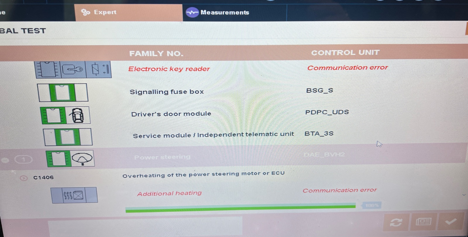

Diagbox, among several other fault codes, shows the message: “Electronic key reader Communication error'
However, my car doesn’t have the separate electronic key reader module (8239)— the key reader coil (10C2) is connected directly to the BSI.

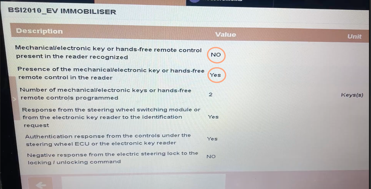

Can anyone explain what these immobilizer parameters mean?
It says that two keys are programmed, but when I bought the car, I only received one key.

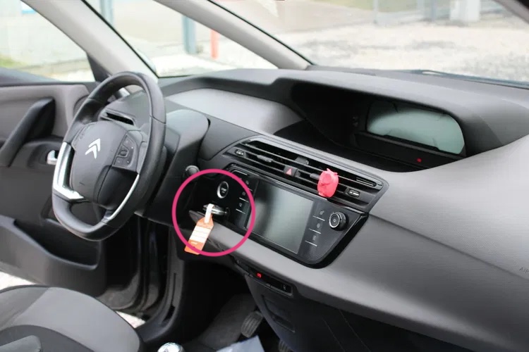

I switch on the ignition and try to start the car with the key fob inserted into the key reader, just like I always do.
It’s exactly like in this picture (taken from the internet). If pull the key all the way out of the slot, the car immediately stops detecting it.
I'd like to note that in Diagbox, under the immobilizer tab, the presence of the inserted key is detected — but the key itself is not recognized
And why, when press the start button, when with the ignition on, there is a command to start the engine and the starter begins to rotate, so many parameters go into "failure" value?

But the immobilizer parameters are very strange, why the key is not recognized....
