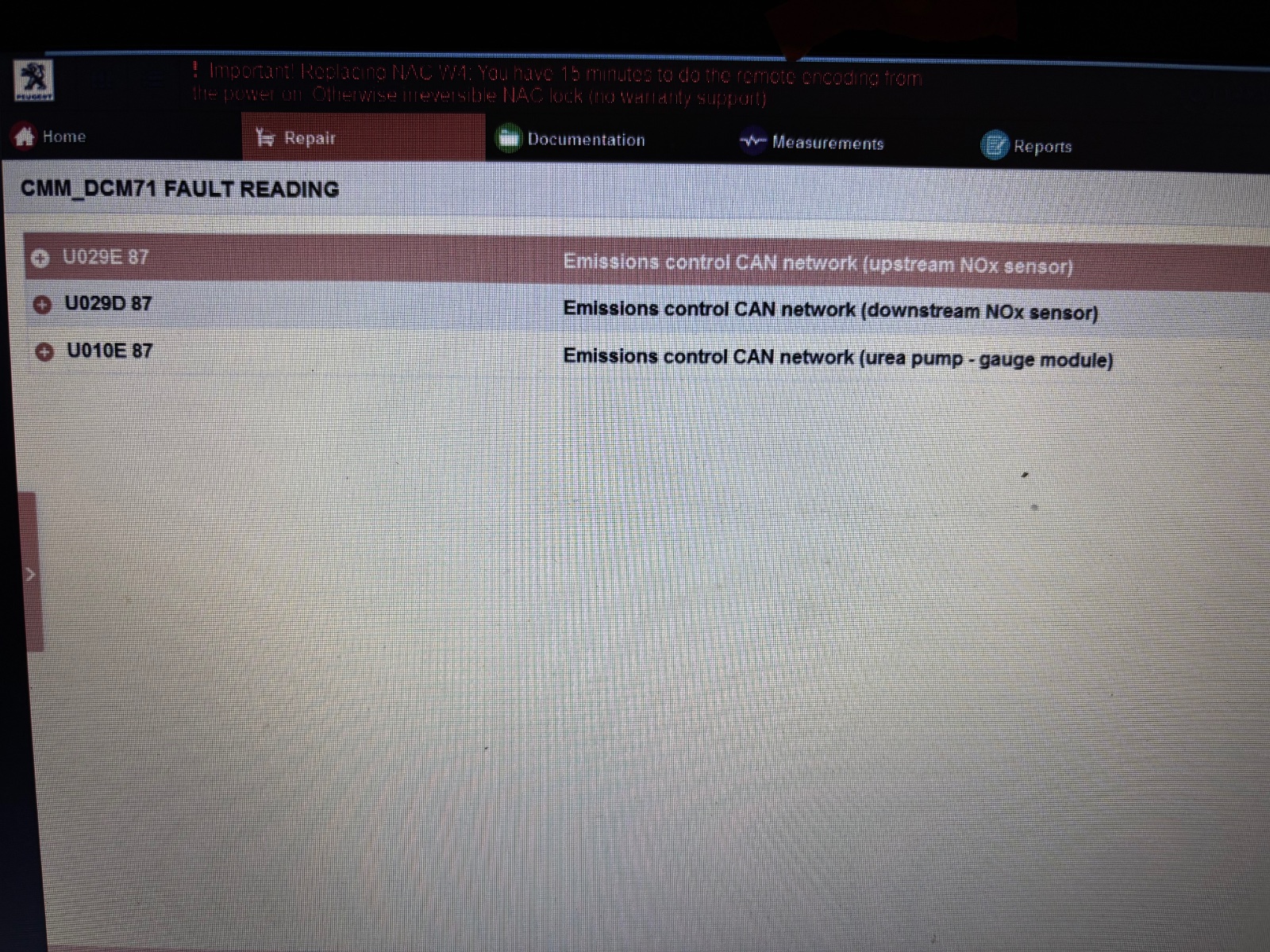

sorry you’re right my recollection of what i did was wrong, i actually used replace parts / replace downstream nox sensor and replace urea injector. i then followed that up with service action / reinitialisation of the denox system when i saw that the codes weren’t clearing.
strangely i tried an older diagbox from psa-diag.fr which o think is 9.186 and it looks like that might’ve initialised the injector correctly.
i’m starting to wonder if the nox sensor is faulty, it came from ECP and looked brand new but the box had been opened before.
current codes that won’t go away:
