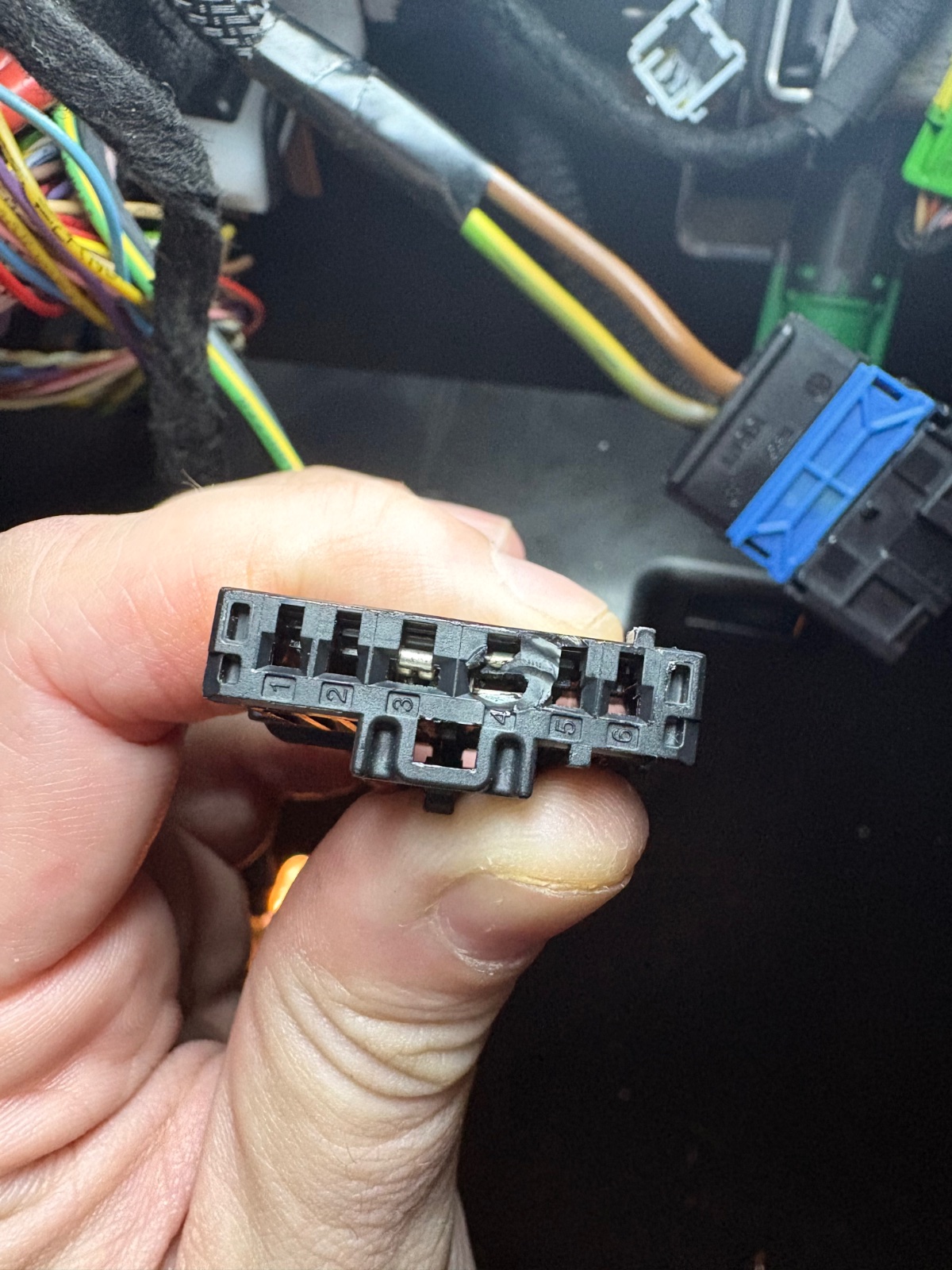

Hi all! I’m new to this but looking for some advice.
Have had issues with my blowers not working and coming into the winter it’s a problem with de misting the windows and stuff and no heating :shock:

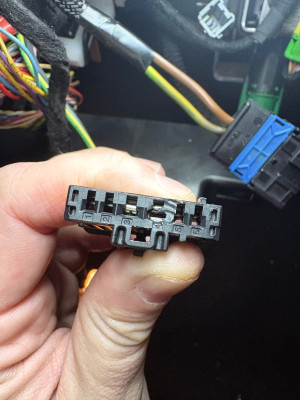

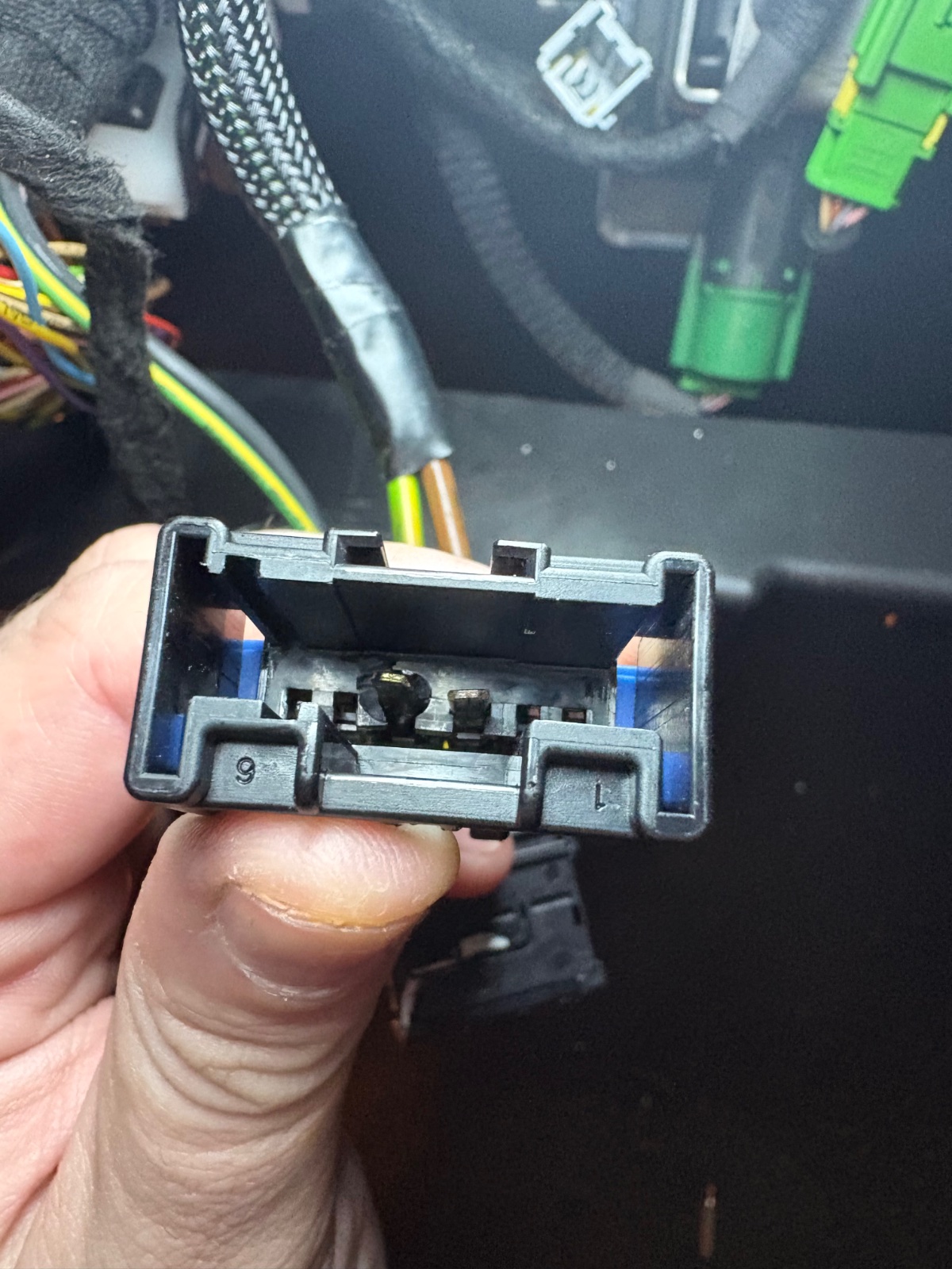

Me being myself I just jumped the gun and replaced both the blower motor unit and the resistor. I have now come across a melted connector for the wiring to the blower motor tonight when I actually took my time to investigate.
How can this be repaired? I have had a look for a replacement connector but not getting anywhere.
Any advice will be massively appreciated!

You could cut both ends off and use a terminal block as a cheap easy fix.

That’s amazing thank you 🙏🏼
