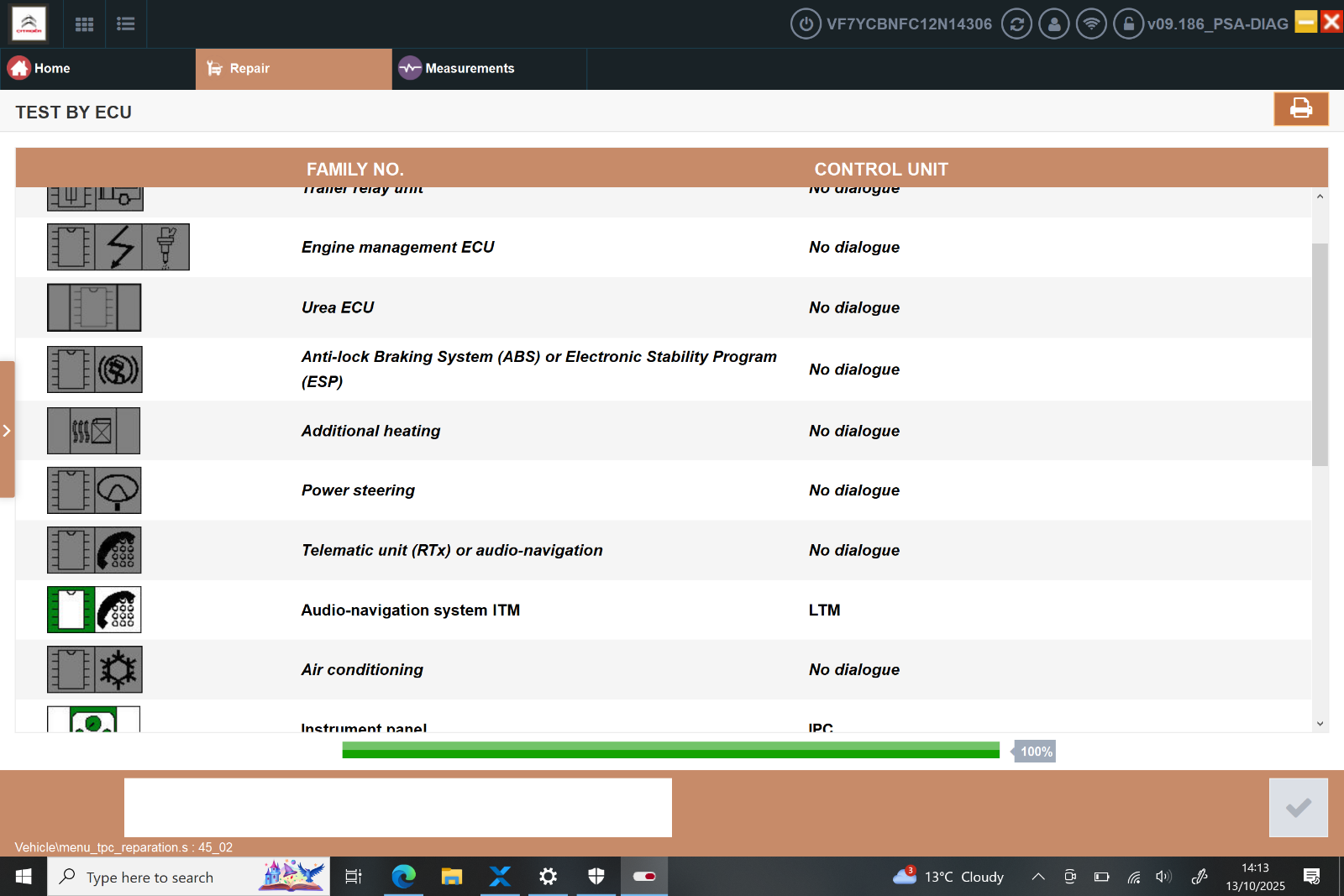

Vehicle is Citroen Relay 2.2 2020
The best I can get is access to a few modules, but crucially NOT the engine ECU
I have tried the Lexia 3 with and without S2179
I have tried VCX-SE interface today (same result as Lexia) (I think it has dynamic pin allocation)
Tried some generic commercial offerings like Topdon but got nowhere at all.
I didn't get this far until I re-wired the S2179 according to the PSA-diag forum. (I tried asking for help there but got nowhere)
I had a glimmer of hope when I very briefly got through to the Engine ECU after running the engine and stopping it. It then kicked me out. (Delphi 7.1_F module)
What is going on here do you think?

Alas, no dice
