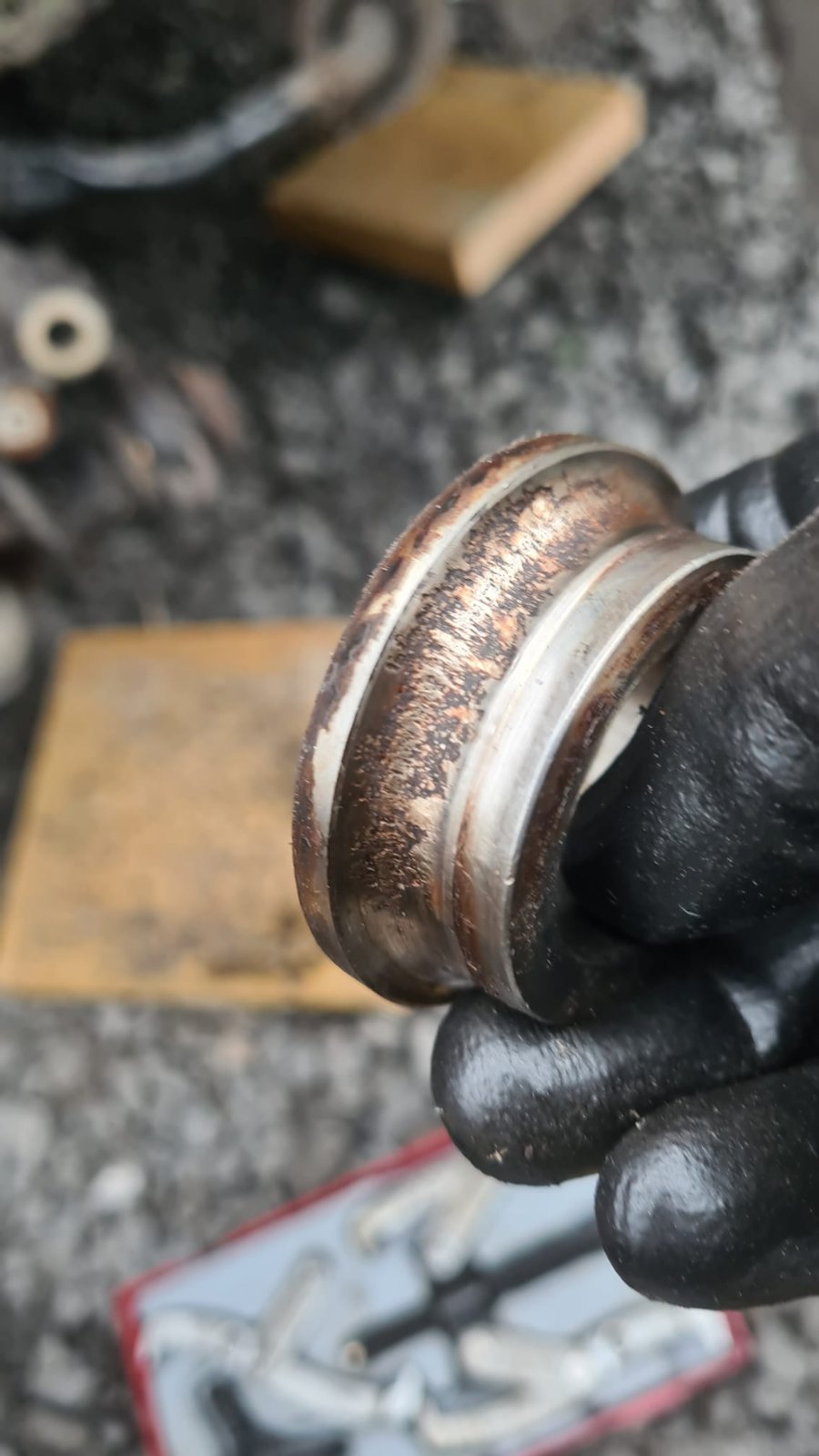

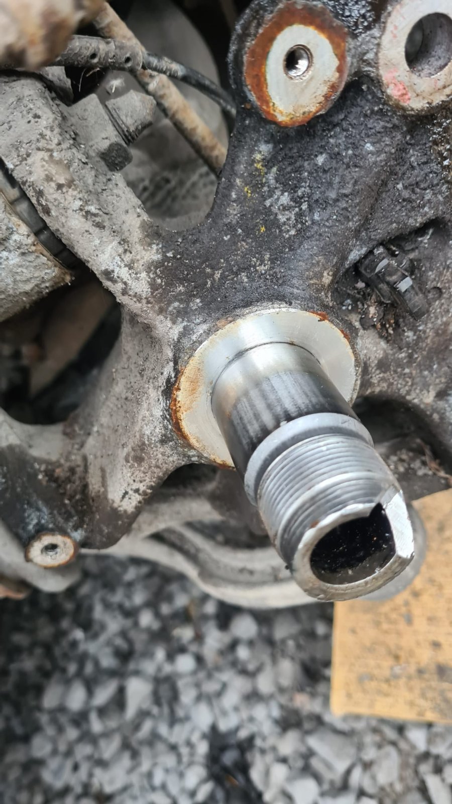

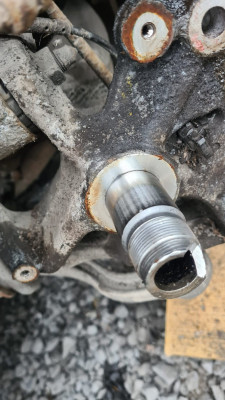

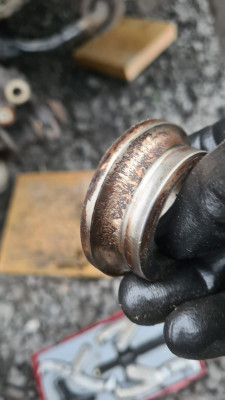

It was the other side wheel bearing, once i got the tyre off, the noise was very obvious. don't know if the way the tyre was hanging it was not putting pressure on the damaged sections.

Also is the nut not 40mm instead of 41mm? it came off with a 41mm, but was a loose fit.
