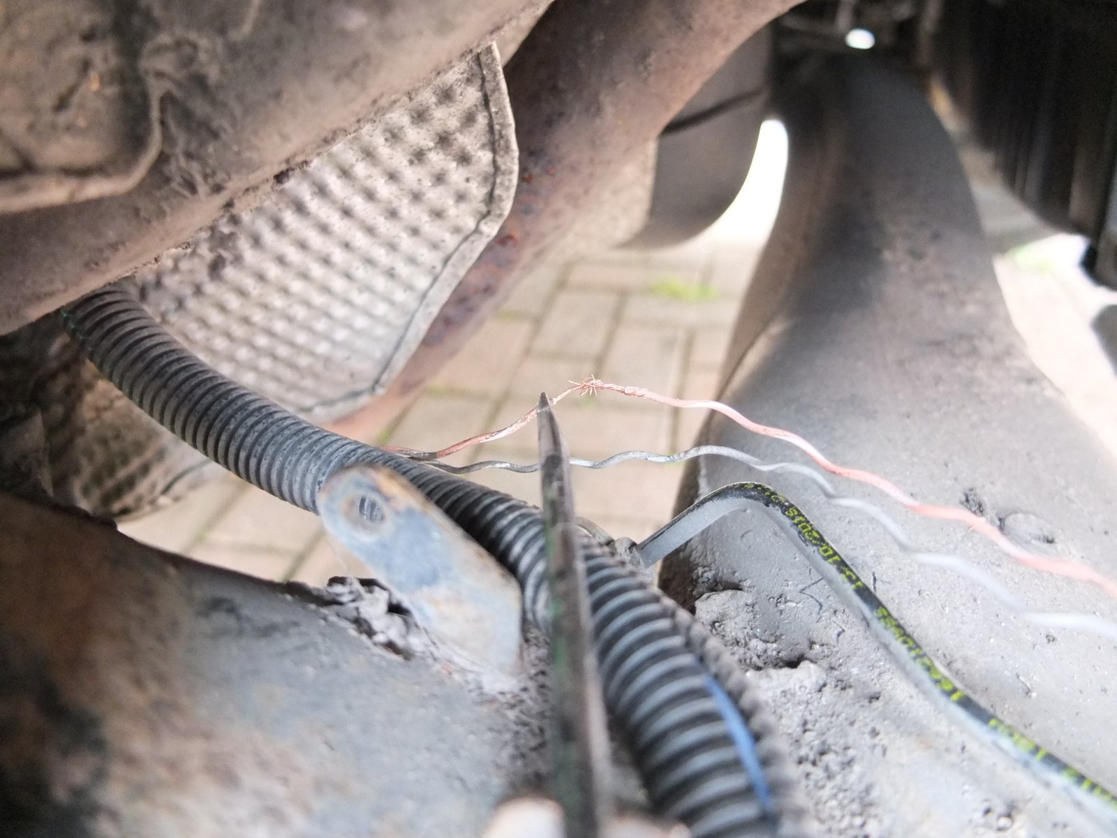

My husband has since found a broken wire high up near the fuel tank.
I'll try to attach some inages to help other owners with a similar problem.
Once cleaned and re-attached the warnings have all gone - PHEW!!

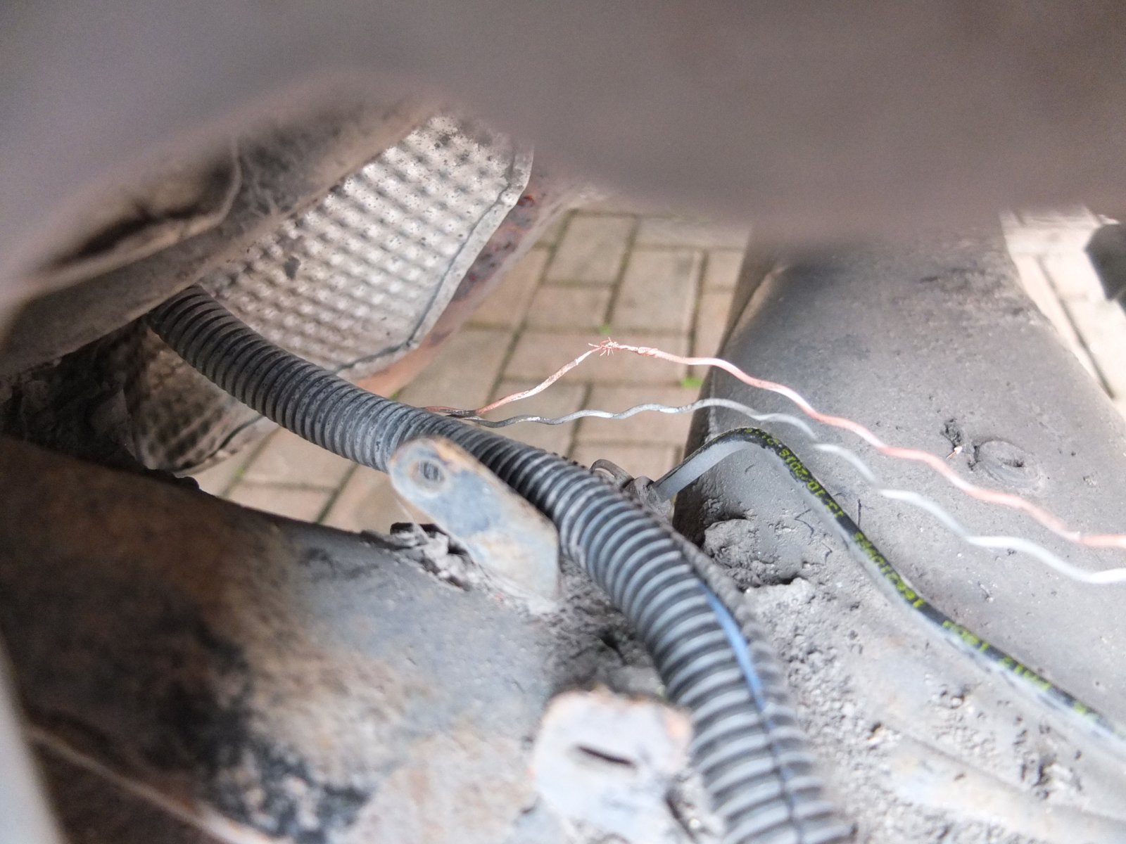

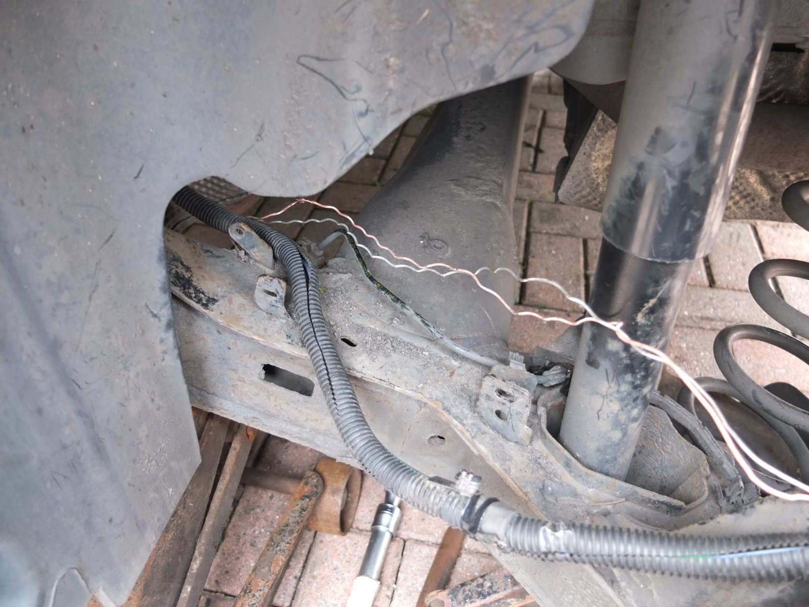

Here are a few images showing the broken wire. This is the rear passenger side and the damage is very close to the fuel tank.
I hope this helps anyone with a similar frustrating problem.
This could have cost us a lot of money to have repaired at a garage I'm grateful my husband perservered with checking the wiring.
