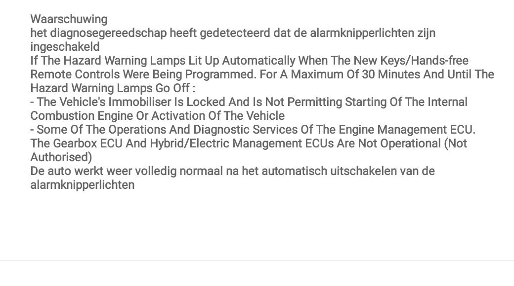

Hello folks
I place this here as i think this issue goes for all psa cars
I hope someone can shed some light on my weird message
that i get on my thinkcar scantool before i do a complete systemsscan
The message is strangely enough part in duch and part in english
but i'll translate the dutch parts
It speaks of new keys but i never had new keys made they are the keys the car came with
Also the hazard warning lights have always been off
I'm sure some of you encountered a message like this What does it mean and what can i do about it
The dutch part says: The diagnosing tool has detected that the hazard warning lights are switched on
the last part says: The car will function completely normal after the automatic switch off of the hazard warning lights
Also there are some dtc in the BSI: U1F00 , B115B, B1418, B1818
but i don't think they cause the no start
I hope someone knows what to do
thanks peyvey

peyvey
- Posts: 26
- Joined: 20 Sep 2025, 17:07
- x 1
Re: weird message on the scantool
Bedankt Kees
This scantool has served me well in the past on different brands of cars and has much functionality. Furthermore i don't think it invents its own messages,
this message comes from the car and the citroen software it uses,
I have also scanned with diagbox that i downloaded from a spanish forumsiite i found the link of on this forum the so called ROBERT free version
But i don't know what version that is
when i plug it in diagbox begins scanning all systems then at a certain point it asks me to switch ignition OFF and ON and then it stops scanning the rest of the modules and returns to the previous screen. I know those modules are on this car but it does not scan them
I dont know if the diagbox version i use is flawed or the vci is no good maybe someone on this forum can point me to a good download
but in the meantime i will use my thinkcar scanner
I would also like to know if someone seen this message before
thank you peyvey
