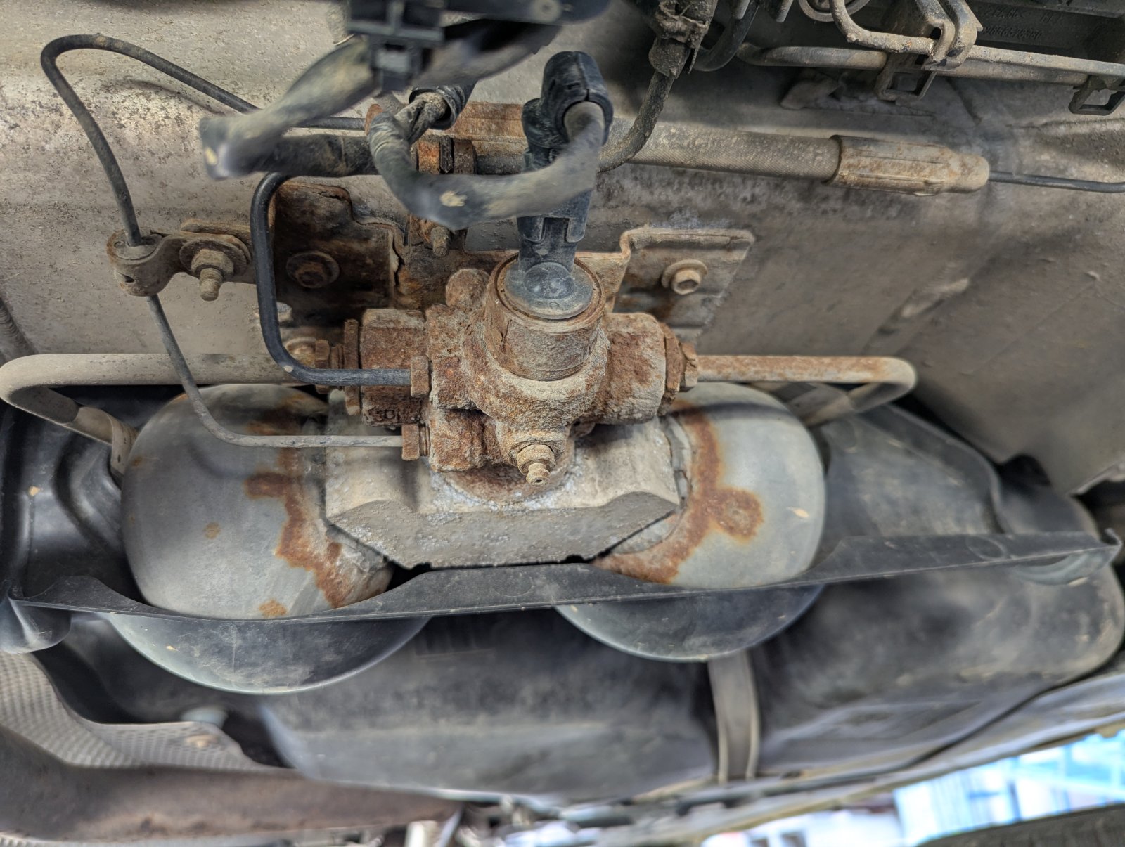

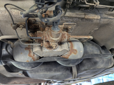

Thanks for the replies so far. From what I gather, and please correct me on this if I'm (most likely) wrong, there are 7 spheres on my car:
1 front regulator (KR70)
2 rear regulator (GV44)
2 front suspension (MC50)
2 rear suspension (ME40)
Is the number of spheres right? My understanding is that V6 variants had 8 spheres with 2 front regulators.
Suspension spheres up front are easy to see and the front regulator sphere is pretty much just like Kees said, though I'm not exactly sure about the rear end. There are clearly two spheres on the regulator valve (older picture included) but where should I look for rear suspension spheres? I haven't been down there in a while and might not be able to look in the near future, so guidance is welcome :)
Rear regulator valve

The rear spheres you can see if you look inside the wheel arc earea, and no at the front there are just one stiffness regulator with only 1 sphere on it, and this is for all types the same.
