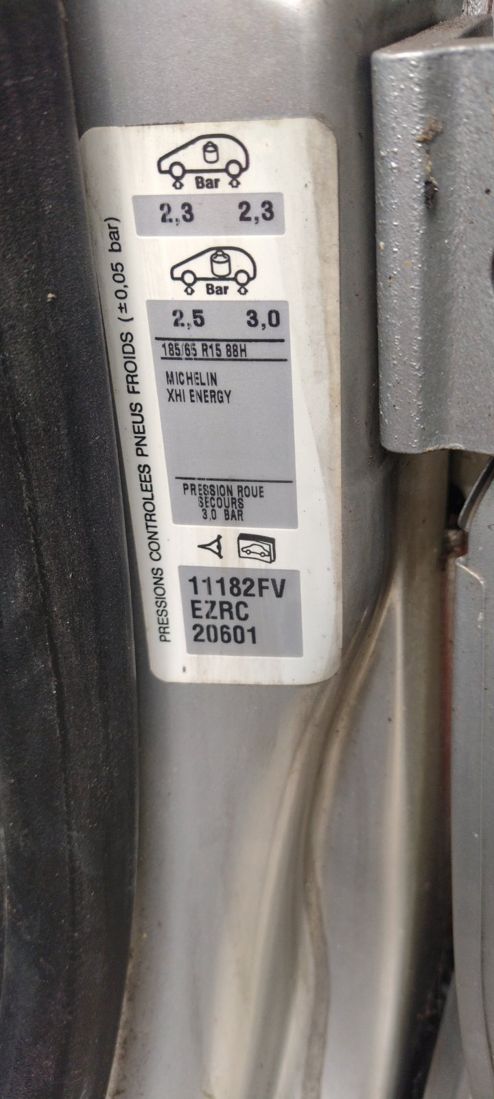

Thanks , please see the photo of my tyre pressure tag , sorry for the delay I had to go out.

RP number is 11182 - so it was built on 21 June 2007.

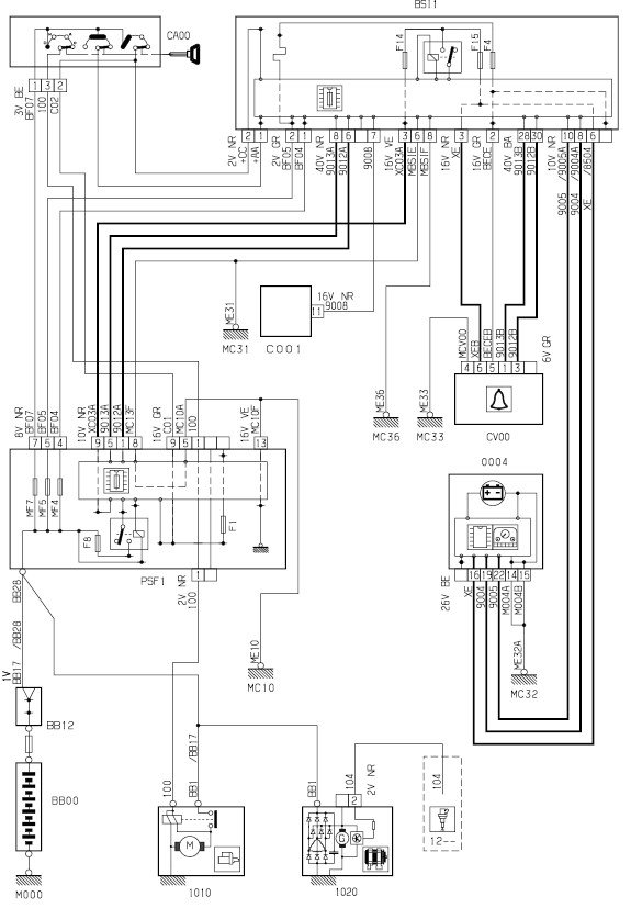

As above the alternator exciter wire is not like on a 'traditional' alternator, it goes to the ECU which has some control of it. However i dont think that diagram above is even from a Xsara Picasso as it appears to me to be from a full CAN vehicle & the Xsara Picasso was never full CAN.
I think this should be the diagram for this car
Alternator is component 1020
