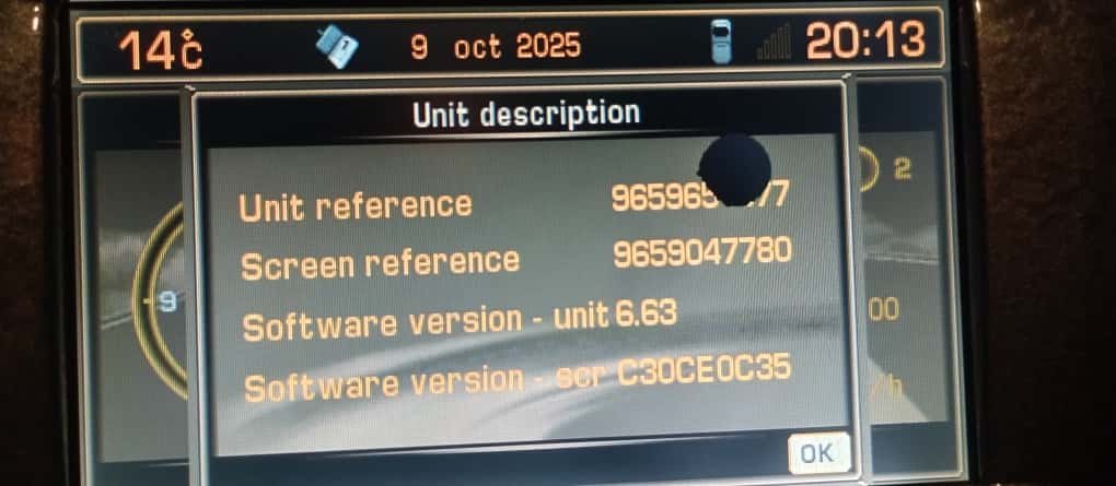

I’ve attached a photo of my software version screen (apologies for the dead pixels!) in case that helps identify anything.

6.63 is the latest (and last) version of the firmware for CAN vehicles. I can't help any further than that.

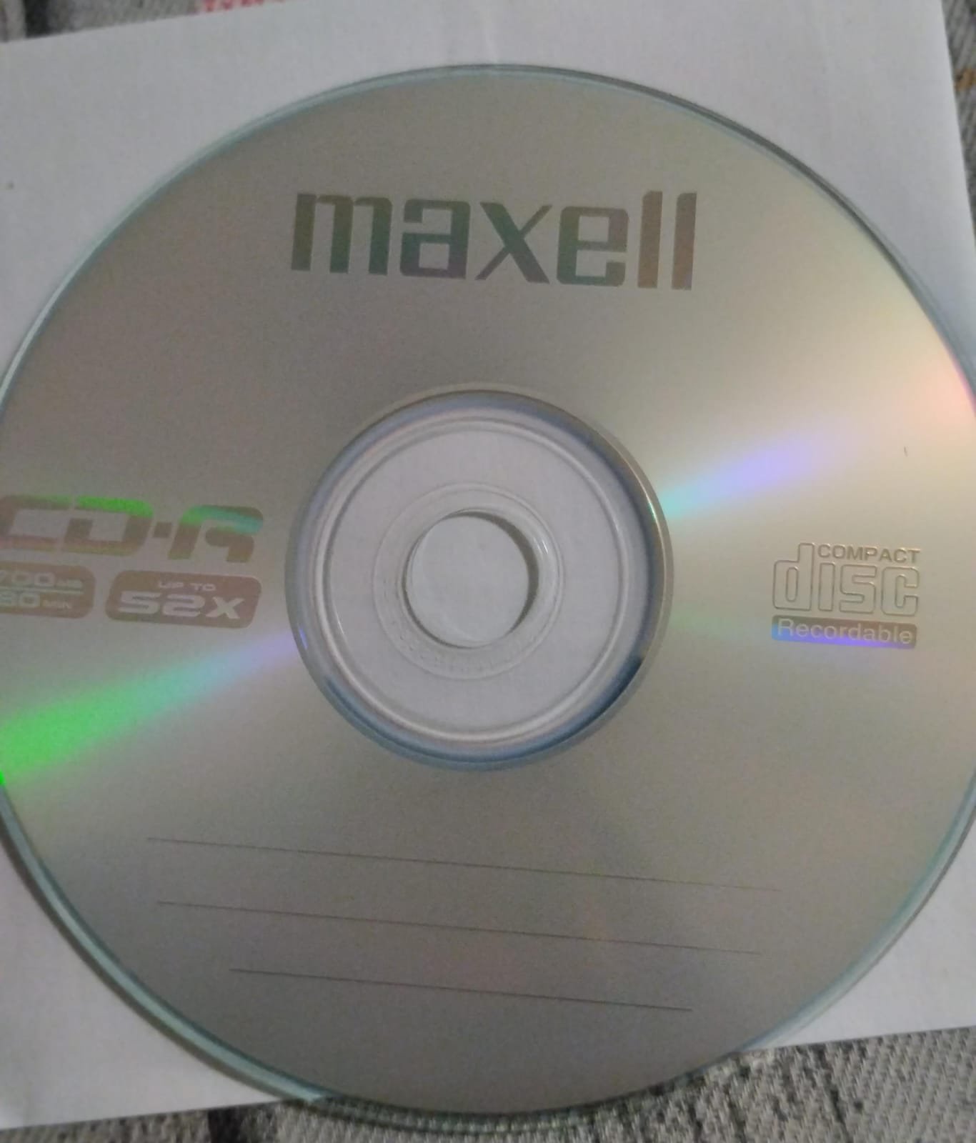

I’ve been wondering if the issue might actually be related to the CDs I’m using. From what I’ve read, the NaviDrive RT3 should work fine with standard CD-R discs.
These are the discs I’m using: Could the problem be with the type or quality of the CD-Rs, or maybe with how I’m burning the ISO? I’m using Nero Burning ROM, selecting the CD-ROM (ISO) option, checking Finalize disc, then choosing my ISO file. I set the burn speed to the lowest available (16×) — though I’m not sure if that limit comes from my drive, the CD brand, or something else.
Or do i have some bad ISO's , if someone could send me some for testing that would be a lot of help as well
Hopefully this gives a bit more insight into what might be going wrong. Thanks again for taking the time to help — I really appreciate it!

I used to burn ISO CD-r's, not for automotive use but operating system installations, so similar but not the same.CherryBerserker wrote: 10 Oct 2025, 04:47 Thanks a lot for the responses so far, everyone!
I always used K3B to burn the discs and was advised to only us 8x or slower.
Also advised to avoid Maxell discs and use "That's" (Toyo-Uden). Always used their tapes when tape decks were a thing.
They are expensive though.
