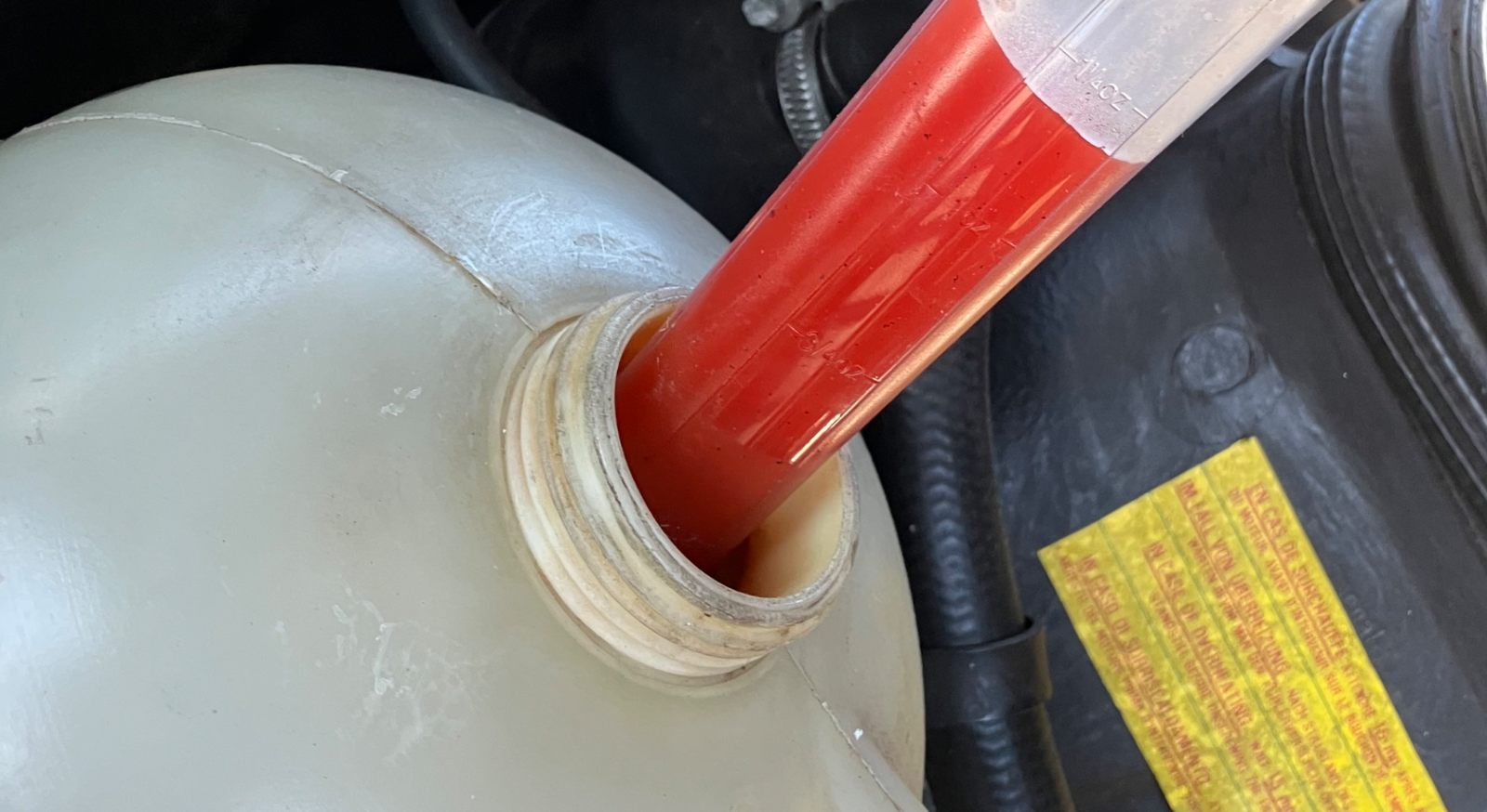

I have a similar concern with the WRONG coolant being put into a 1990 CX (w/ Automatic Transmission) recently .
The mechanic put OAT (Pink/Red) coolant into the cooling system ofter a cooling system flush .
Previously IAT (green) coolant was used in the 1990 CX.
I have read that the OAT (Pink/ Red) coolant has more coolant efficiency ?
I have also read that in the future , it will cause many coolant related components to fail (water pump, radiator, heater core , hoses , and Automatic transmission water cooling components ) ?
Does ANYONE know anything about this here on French Car Forum?

My understanding is the big issue with mixing / a change in coolant types is undersirable results from mixing - mixing types can generate a "gloopy" viscous mess that causes issues.citroenroen wrote: 15 Feb 2026, 18:07 I have a similar concern with the WRONG coolant being put into a 1990 CX (w/ Automatic Transmission) recently .
However, you've said a flush was performed first so the mixing issue shouldn't be a concern here.
I'm not aware of any reason why the coolant changed would cause components to fail - I did find passing mention of "slightly reduced corrosion inhibition" but not much detail on it actually creating issues.
