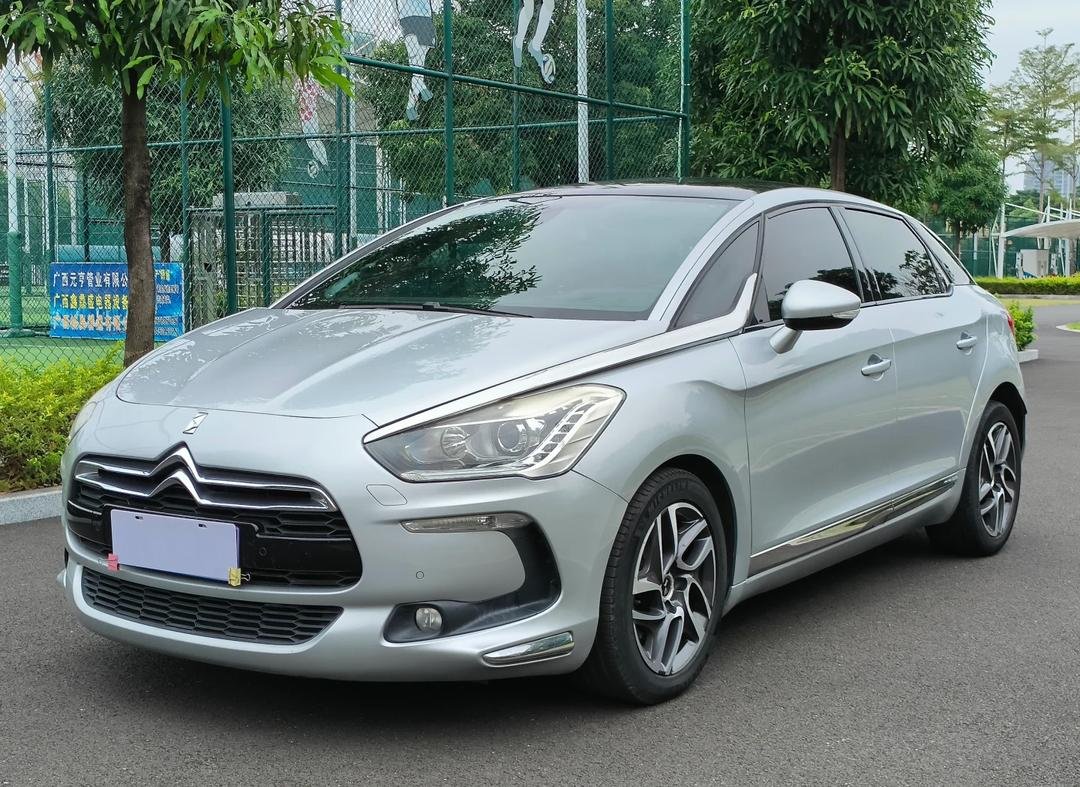

Who has a Citroën DS5 window regulator installation tutorial? Many thanks.

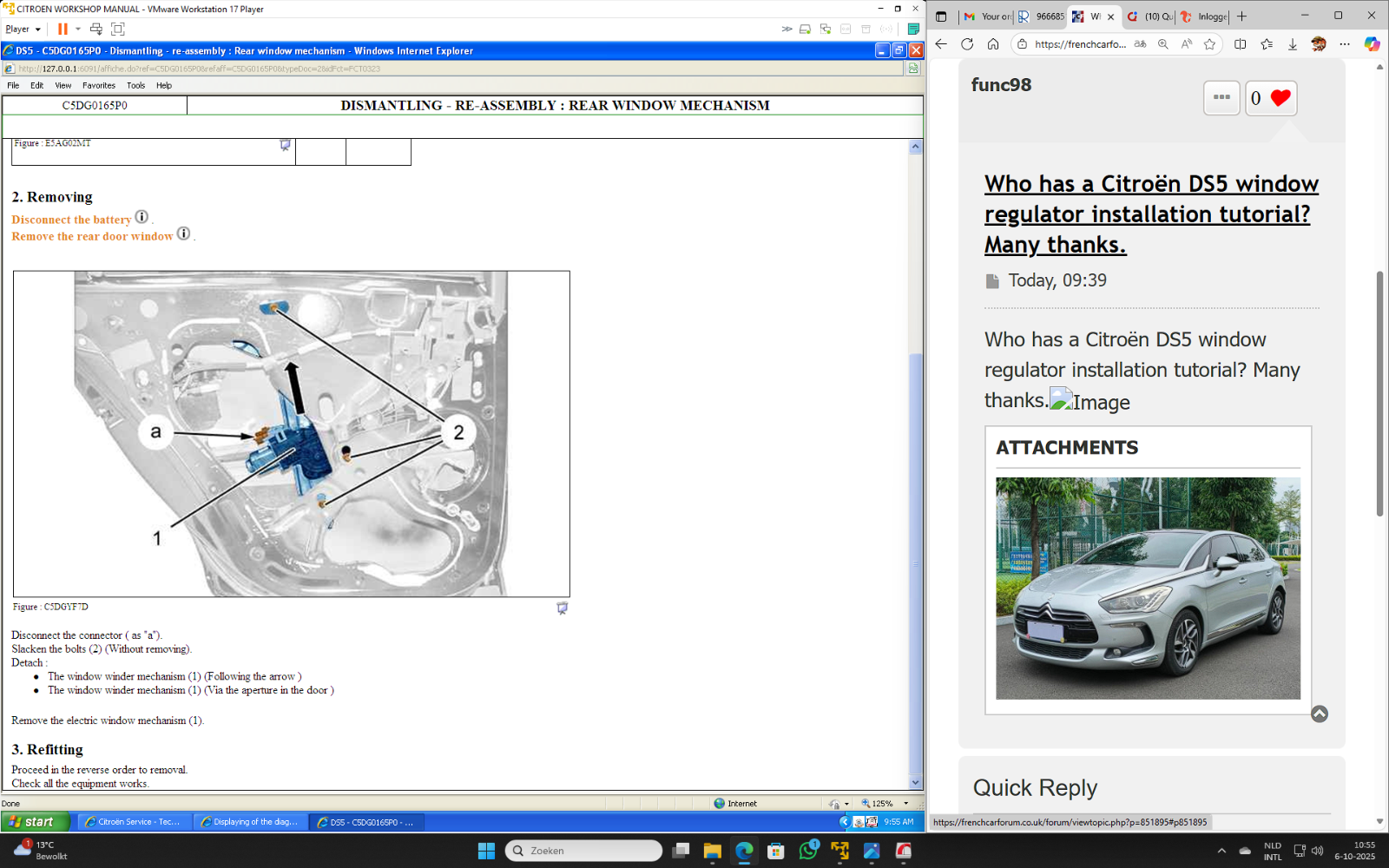

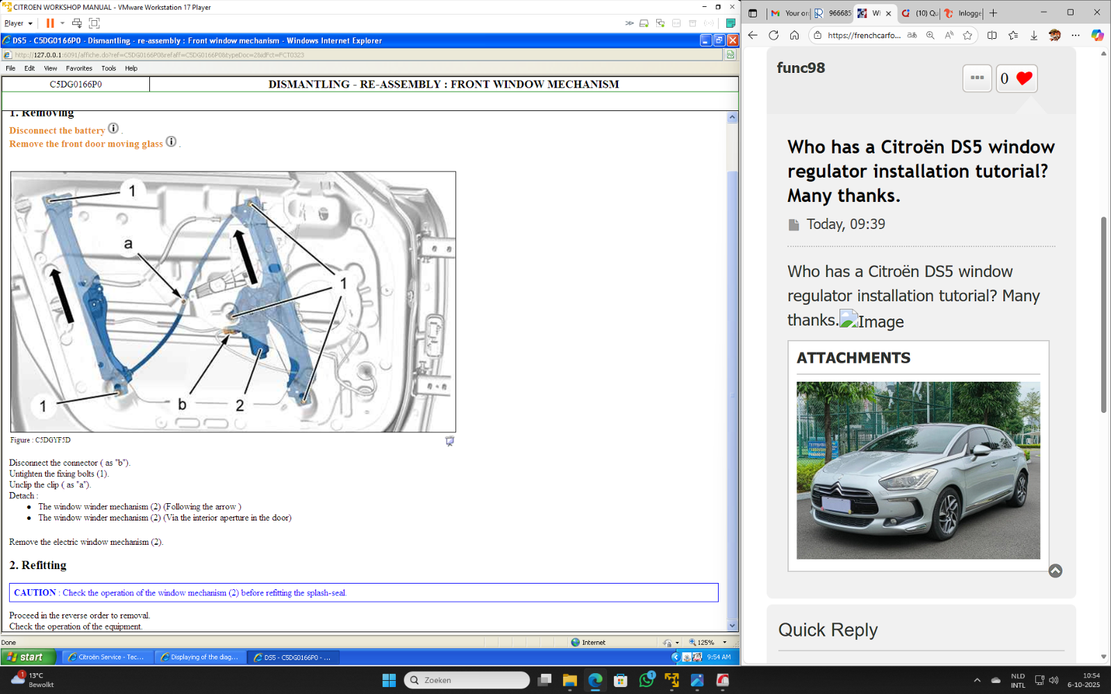

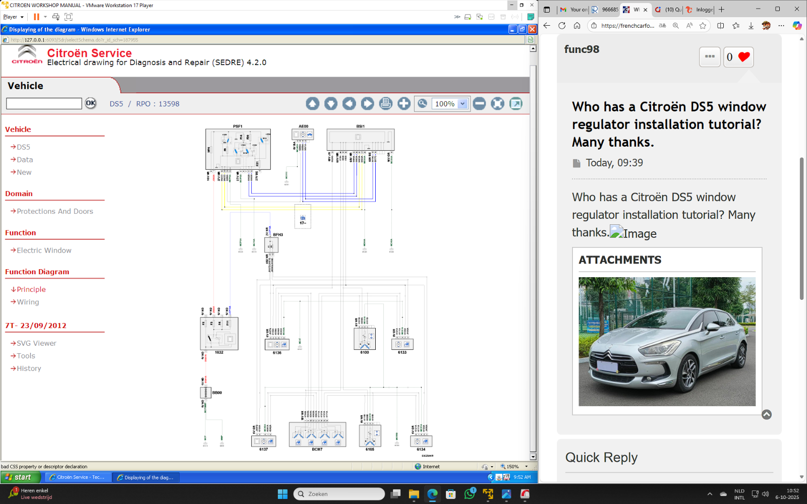

i can send you some screenshots out of an old citroen database i have from 2013/ I hope it's of use to you. I had to split the screen because the DB runs in a virtual machine
luck peyvey

@peyvey?Thanks a lot, super helpful!
