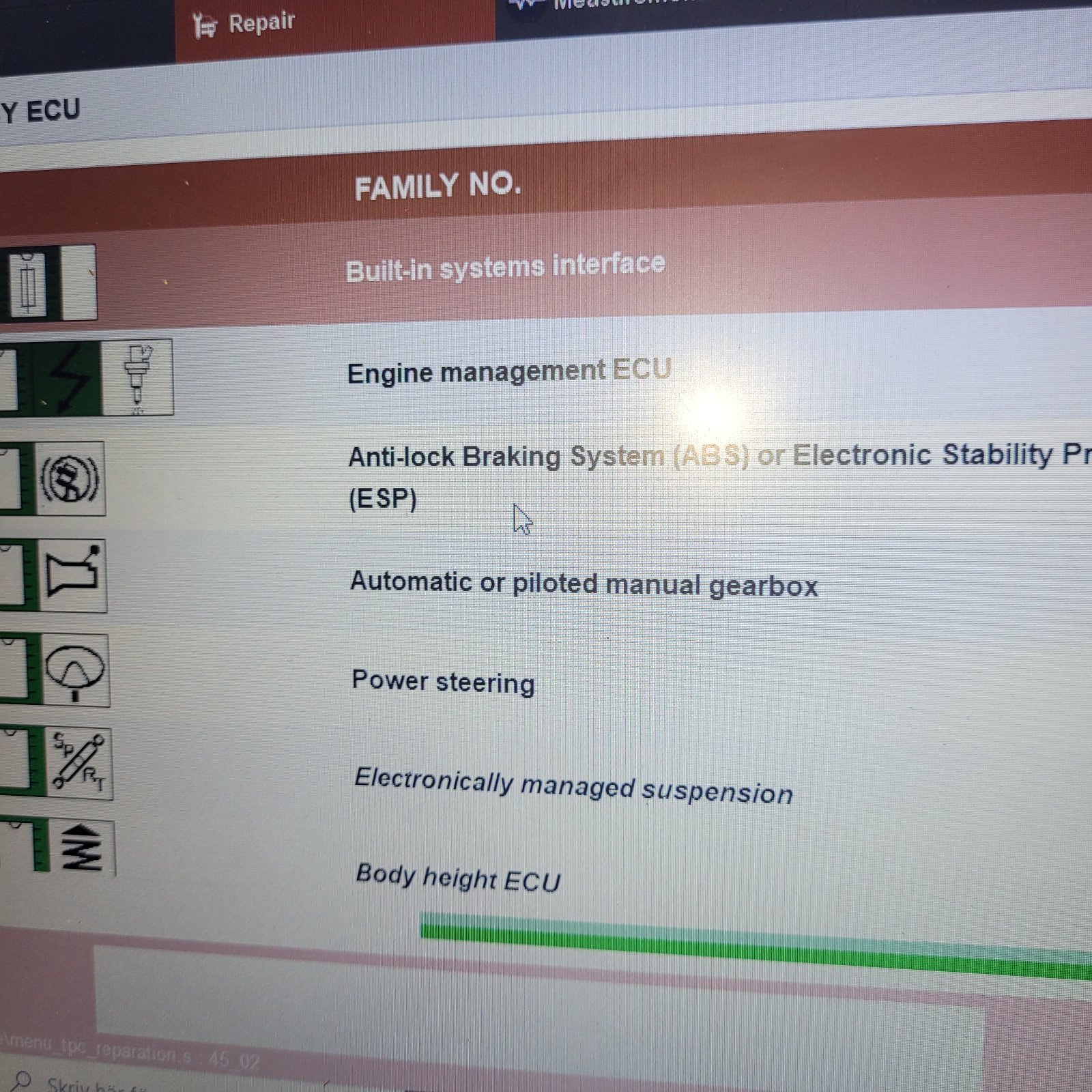

Hi!
I just got my newly purchased full chip LED up and running and want to depressurise the suspension on my C5 x7 2014. However, I'm having trouble finding the right place in the menu. Where can I find depressurise? I clicked "electronically suspension" but could not find depressurise in there.
please help this newbe :-D

Re: Depressurising suspension C5 x7 with diagbox 9.18
Not sure but I believe you have to go in the Repair section and look for the suspension in there. :)
Unread post by gustav »
mickthemaverick wrote: 01 Oct 2025, 19:17 Not sure but I believe you have to go in the Repair section and look for the suspension in there. :)
My first thought and attempt. Cant find "suspension" under repair. Only "electronlly managed suspension". :) Maybe under body height ecu?

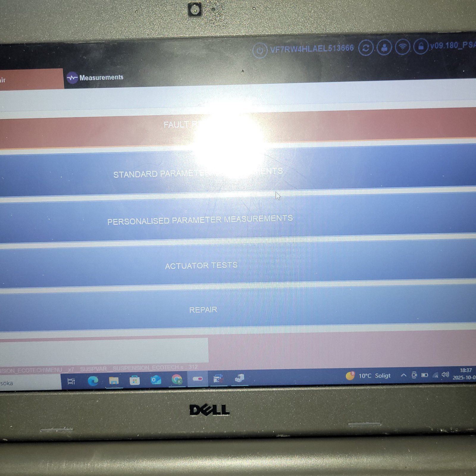

Kees wrote: 01 Oct 2025, 20:00 In the startup you have to go to new delivery.
Ok! And after that?
Unread post by Kees »
Look for check the LDS level.
Kees wrote: 01 Oct 2025, 21:45 Look for check the LDS level.
So New delivery to customer and then Check lds level? Do I find depressurise in that meny?
Yes
Kees wrote: 02 Oct 2025, 08:05Yes
Right where U said it would be. Thanks again!
