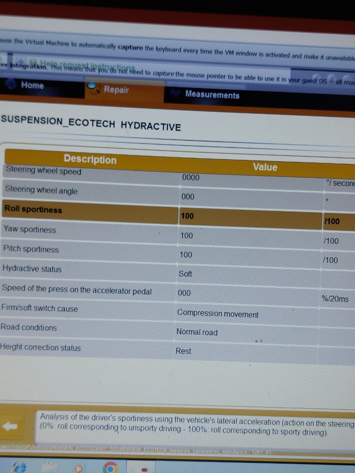

Lexia shows yaw, pitch, and roll sportiness always at 100%, even when stationary. Could a faulty yaw sensor under the driver’s seat be causing this, keeping the suspension always stiff?

Even with the sport stand switch on, the car is in soft mode!!
The difference between soft/stiff is that the threshold for switching is on an other level.
Kees
- Posts: 603
- Joined: 16 Nov 2021, 16:16
- x 148
Re: Citroen C5 X7 very firm suspension
@ nomad123:
Look at my answer on Mick.
The number you see is not an percentage, but it is the threshold for changing from soft to stiff.
Look at the number when you press the sport switch, then you see the number change. This is how the sport stand works.
nomad123
- Posts: 64
- Joined: 24 Aug 2019, 19:00
- x 7
Yes, I know how the sport mode works, it’s not a simple on/off button. When I looked at these parameters, the sport button was on, which is why everything was at 100. When I turn the sport button off, the parameters return to normal and vary depending on driving style. So this is not the cause of the hydraulic system’s poor behavior.
