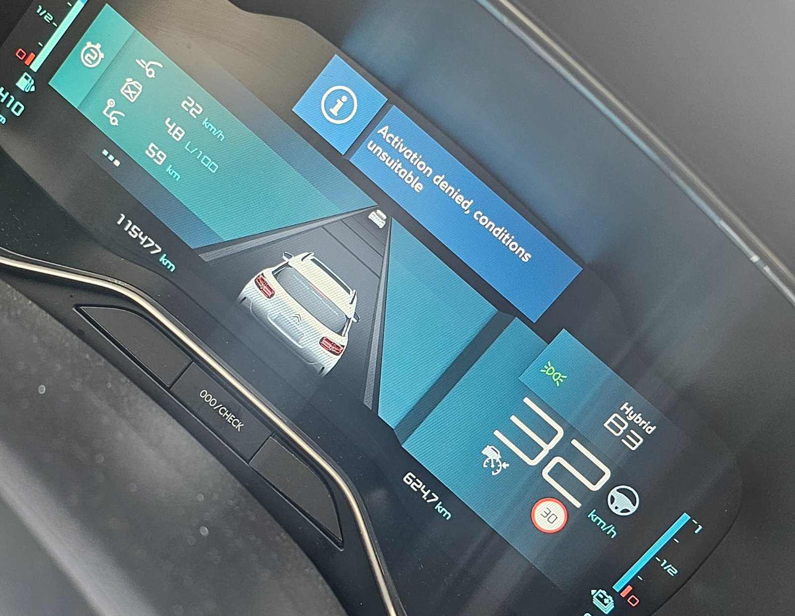

I have a 2021 C5 Aircross hybrid that I recently bought, I updated the system and navigation and everything was fine.
After this operation, I often received the message "Activation denied, conditions unsuitable" and the autopilot refuses to activate. Sometimes it does not activate even after turning off and restarting the engine.
All the conditions are correct, speed, type of road, visibility, etc. I also put a no name tester on the car and it found nothing on the scan.
Sometimes works great, last night it worked like a charm for 300km and today it doesn't want to work at all.
Has any colleague experienced similar things?

You need to get the car scanned with Diagbox or similar to see if any fault codes have been stored. Since the issue is intermittant that is the best way to know where to look

Are you sure, "All conditions are met" there are two conditions that catches me out, slight pressure on the accelerator, and not holding the steering wheel in the right place, this is enough to stop it triggering. In fact, just completed a 120 mile motorway dash, with adaptive cruise/lane assist activated, and at about 70 mile mark, a warning message appeared "Hold onto the steering wheel", first in grey, then orange with a bong. Even though I had both hand on the wheel, they had not moved for a while, or I had just relaxed my grip a bit.

I have a later C4 so my comments are based on that. The Citroen message is unhelpful because it doesn't tell you which conditions are not met. I get it sometimes and I am only just beginning to work out the causes. The fact that your system worked perfectly for a long trip suggests that it might be fine.
This based on the C4 'driving assist'
It might be that your system is working fine, maybe you could try to discover the differences between when it works and when it doesn't work.
- When you switch it on, it activates adaptive cruise control and lane keep assistance. Either could be the problem. If you turn off lane keeping assistance in the main driving aids menu (you have to do this after every engine start in later cars, don't know about 2021), when you press the button on the steering wheel it just turns on adaptive cruise control, so you might be ablle to work out which part of the system is at fault.
I can't just get in the car, start the engine and turn the system on, the parking brake has to be off as well.
When the system is on you can exceed the recommended speed. I see from your picture that you are already travelling above the speed you are attempting to set. I wonder if that causes the message? Also the display suggests that it can already see a car in front, I wonder if that might be a reason it won't switch on? Once it is on and set of course it deals with both those circumstances very well, but maybe it has to be 'clear' in order to set it. I could see that as a safety feature, you wouldn't want the car to brake suddenly when the system goes on.
I see that the speed sign is very low - I assume Kph. Is that below the parameters for switching on? I know it works well below that speed - even to a standstill - when operating but its different for activation.

When it works, it works no matter the sign on the road, the speed in that moment, if there is a car in front of me or not and so on.
I tried already with lane assist activated, deactivated.
