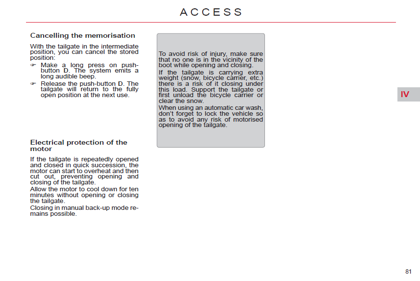

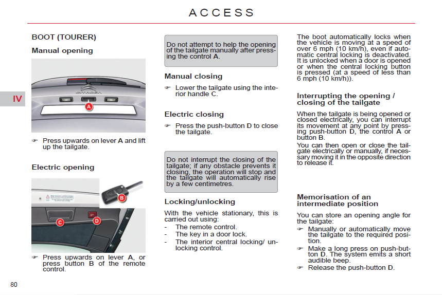

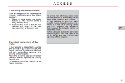

Maybe there's an intermediate setting stored?

However, when using the motorised function it opens about 1 foot and a half before stopping and beeping 3 times.
I plugged in a diagnostic tool which had a program to open and program to shut the tailgate. When I run them, it will open to full height and close correctly, so I know that the hardware is fine. But I can’t seem to get it to open fully on the motorised operation normally,
I’ve opened the tailgate manually to the top and then held the button on the tailgate for 5 seconds. It beeps 3 times but that doesn’t store the position.
I noticed that the button on the tailgate is flashing I assume that means it thinks there’s an obstacle

Re: Motorised tailgate operation issue
On the second page above from the hand book it shows how to cancel the intermediate position - did this work when you tried ? Something you could do is check the battery voltage, if low it might give problems but is probably not the issue.
