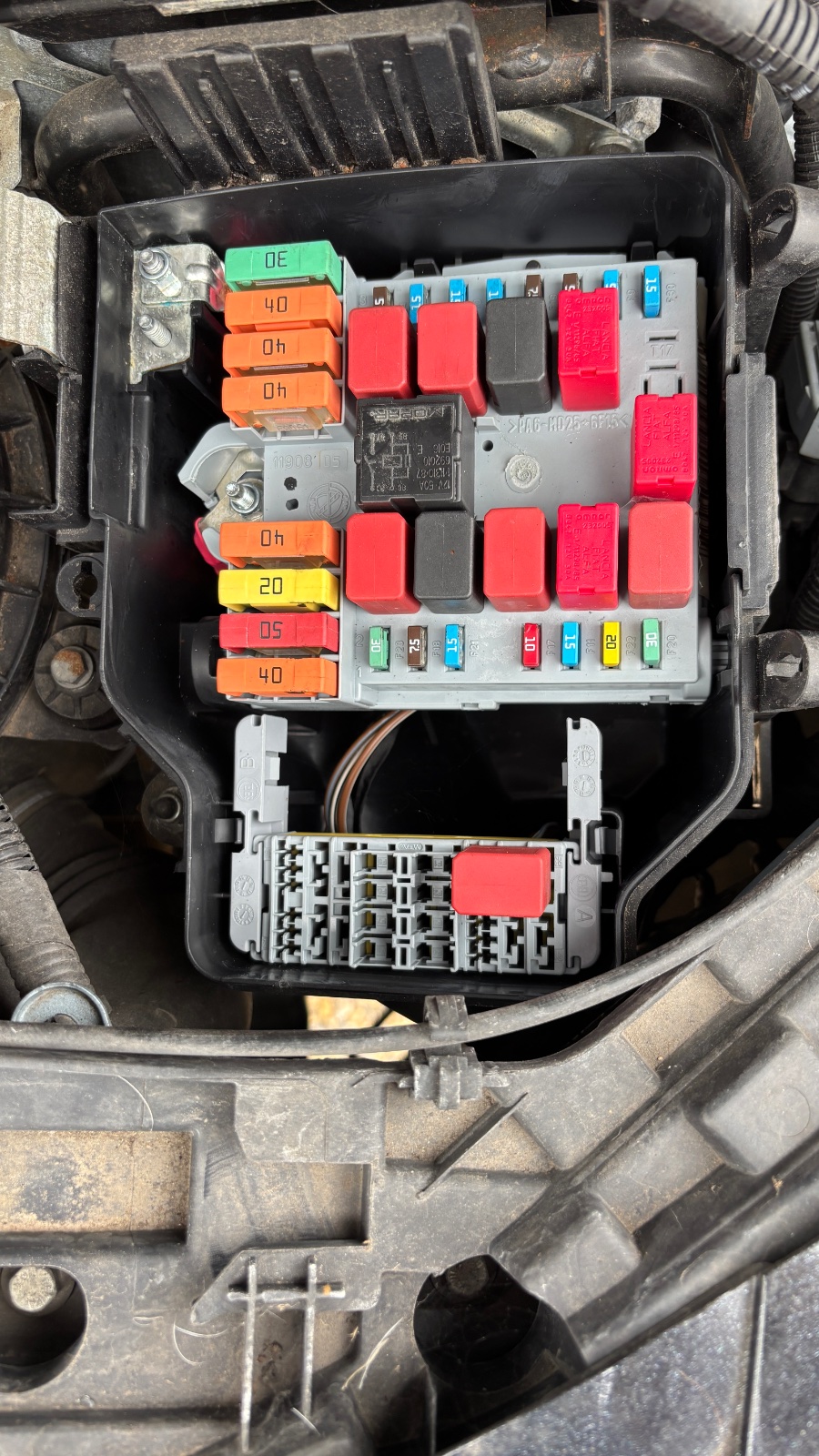

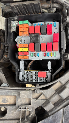

Hi I’ve not been able to get diags on it as all the adapters I have don’t work. However I have combed this forum and found the post about blocked vaporizer. I have got under the van, blown down the diesel tube and can confirm it’s blocked. I’ve ordered a new unit. I wanted to check the vaporiser fuse, and found posts/ info, but the fuse, or even the. Sub fuse board in the engine fuse box is not there… anyone know where else it might be… pic attached. There should be another strip of fuses above the panel with the lone relay
