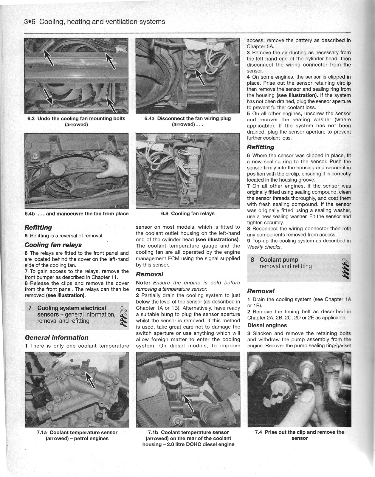

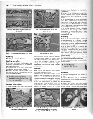

Re: 2007 C5 MK2 P0483 FAULT
It's there somewhere. This is from the Haynes C5 Mk1 & 2 manual and is much as I remember it from my Mk1. Instructions say you have to remove the front bumper although I don't remember doing that. Could be wrong though, it was over ten years ago!
sydo
- Posts: 80
- Joined: 26 Apr 2024, 08:42
- x 9
I opened the cover in pictures 6.4 and 6.8, there is only the socket and the relay.
- Posts: 9399
- x 1940
OK, at this point I have to say - maybe it's a single speed fan set-up!
