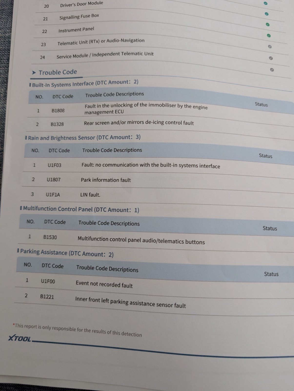

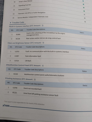

So this is the diagnosis codes I got done using an X Tool D8W for my Citroen C4 Grand Picasso.
I had a BSI reset yesterday too, but the parking assist error came back as soon as I reached the end of the road. Only once and hasn't happened on any drives this morning.

You haven't included the codes!

Re: Electrical Issues - C4 Grand Picasso
Sorry. I thought I put the attachment on, but didn't seem to add..
Should be on now.
Unless you have an autoelectrcian who specialises in Citroen I'd go for the Citroen specialist. It looks like you may have a faulty multi plug into the ECU and a faulty parking sensor. Best to have a diagbox analysis for more specific information.
Is the car running and starting normally without any problems ? Is the only fault you have noticed the parking sensor fault - if so your printout suggests the left front sensor is at fault or its wiring ?
It is usual to delete fault codes after noting them and then see what comes back in case they are old ones and no longer being generated. Was this done ?

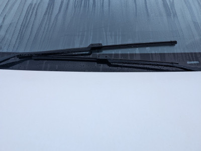

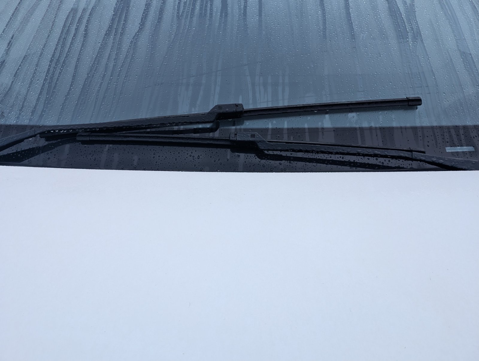

The rain sensor fault is hidden and doesn't show anything on the dashboard, but my wipers are in this position (see picture) is this normal?
Do the wipers work normally apart from where they park? have they always parked like this or just recently. Would be unlikey a raind sensor wouls cause the wipers to park incorrectly
If so this could just be a mechanical issue, the wiper arms can slip on the spindle. The most common causes of this is trying to clear a foot of snow off the windscreen with just the wipers or trying to operate the wipers when the wiper blades are frozen to the windscreen. Hopefully just a case of removing the wiper arms of the spindles & re positioning them.
I think it's only recently that they are in this position. Want me to take a video of them operating?
For the parking sensor, you could swap the inner left front one for the inner right one and see if the fault code moves - if so the sensor is likely faulty. The inner and outer sensors may be different if you need to get a new one.
