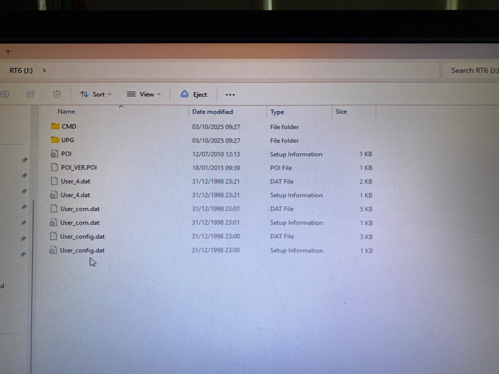

I have just about to attempt this again on my partner's unit.
The process appears a little different to Marc's original post as when the USB stick is recognised:-
"When prompted, it will ask to execute the script, choose 'Yes'."
It did this.
"The script will ask to launch the 'Write' command, answer 'No' to this."
It didn't really appear to ask "Do you want to write?" so I am not sure it did this. I answered YES anyway because it wouldn't really do any harm.
"The script will then ask if you want to launch the 'Read' command, select 'Yes'."
It didn't appear to do this as the screen returned to its normal state so I am guessing I clicked YES to the write command.
So now I am moving onto the next phase in the next few minutes so if anyone is online?
Maybe I should wipe the USB and run the process again and video the RT6 screen? What does anyone think? @Mick.
I did a test run earlier and plugged the USB into a PC again to see if there were additional files and there were so I repeated Part A again and have obviously NOT plugged it back into PC again to check if files are there.
Rhothgar
- (Donor 2026)
- Posts: 2432
- Joined: 22 Nov 2004, 00:21
- x 221
Re: RT6 CD noise issue, I cloned the card and it didn't work
Config files appear to be there
