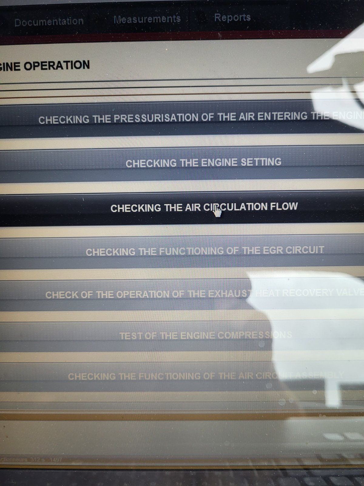

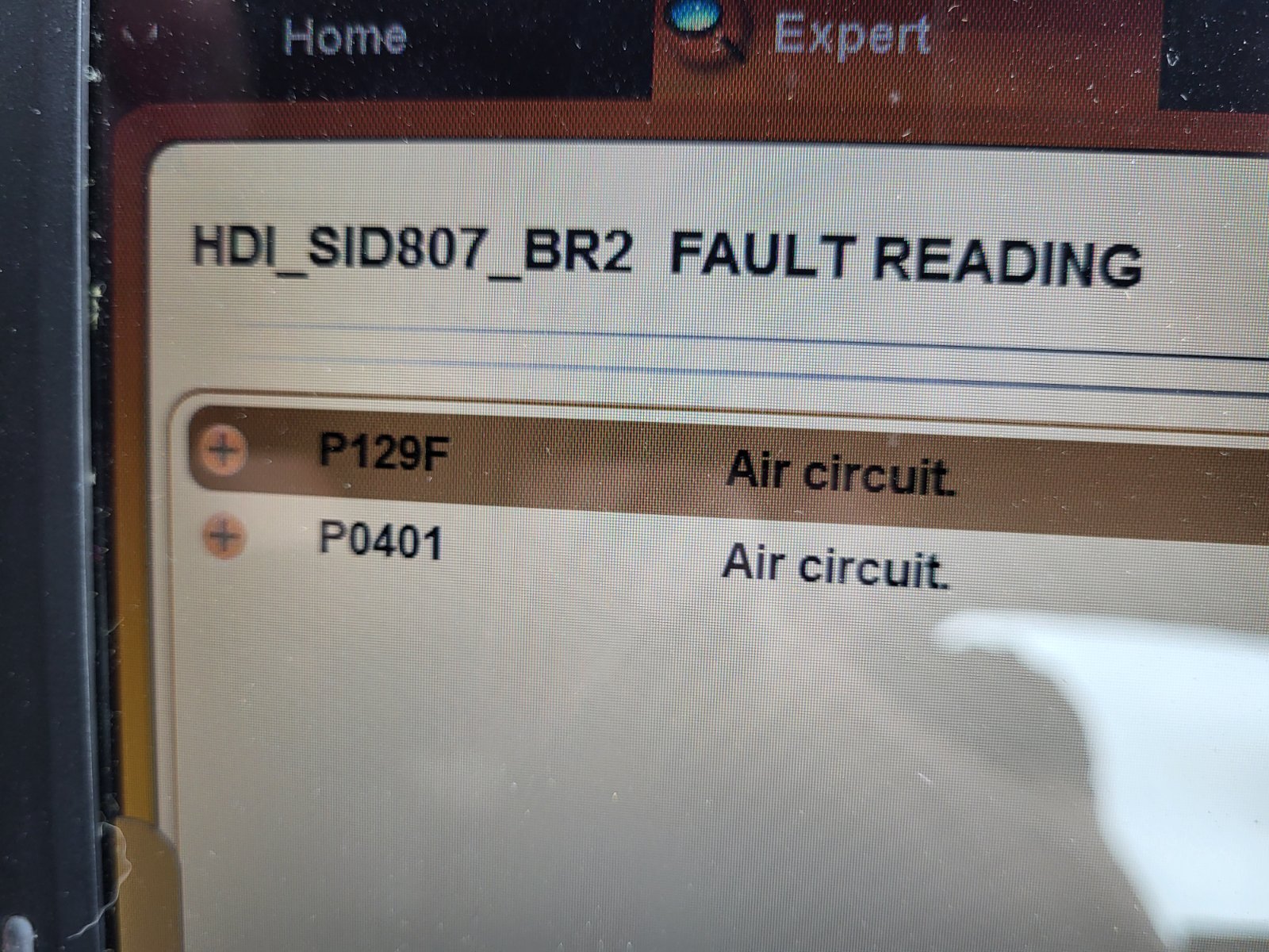

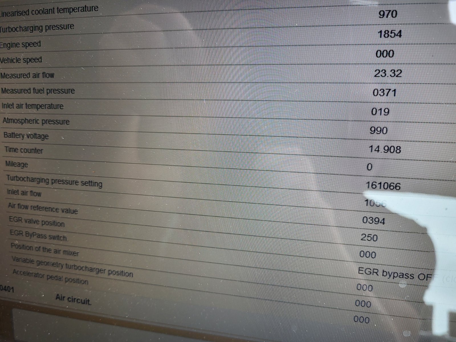

On normal driving my 2012 1.6hdi shows no faults on diagbox relating to airflow, however if I do dynamic testing on diagbox on airflow ,stationary ,engine warmed up the two faults show up ,see pics showing ref air flow 250 and actual 394.
any reason dynamic test shows fault but not when driving? Have changed maff x 3 times ,egr x3 and map, hoping this might be related to my c1391 fault.

I can't answer, but I scanned my 3008 yesterday as I was having some handbrake trouble, and on checking in the engine I saw the same that air flow was around 400 vs a reference of 250 or so at idle, and the EGR was showing as closed. Occasionally I have a long crank, idle is slightly rough (but then it has been for the 50k I have had it!), and I thought very occasionally I could feel a bit of hesitation on cruise - our original C4 Pic did some of this when the EGR valve was sticking. Dunno, no lights on, I'm ignoring it!

Found that as fault only came up on when on diagbox static test , never under normal driving conditions that it was just a abnormal revvingg condition on test that caused it ,cleared faults never did test again and never had faults again or ay driving issue , my c1391 fault wass totally unrelated to any engine /car problem, when i went into engine ecu using diagbox(which isnt scary or compplicated as some people make our) you get options to enable or disable everything ,i had a permanent abs/esr fault ,it turned out abs was disabled in ecu options, enabled it and all faults and lights cleared , suggest if you have diagbox and any faults that you cant clear before replacing parts check everything that should be working is enabled in engine ecu, another thing is i went to a ecu programmining /fault clearing company and they said it was abs ecu related and not engine as shown by codes, that was rubbish , all braking function options are within engine ecu..
