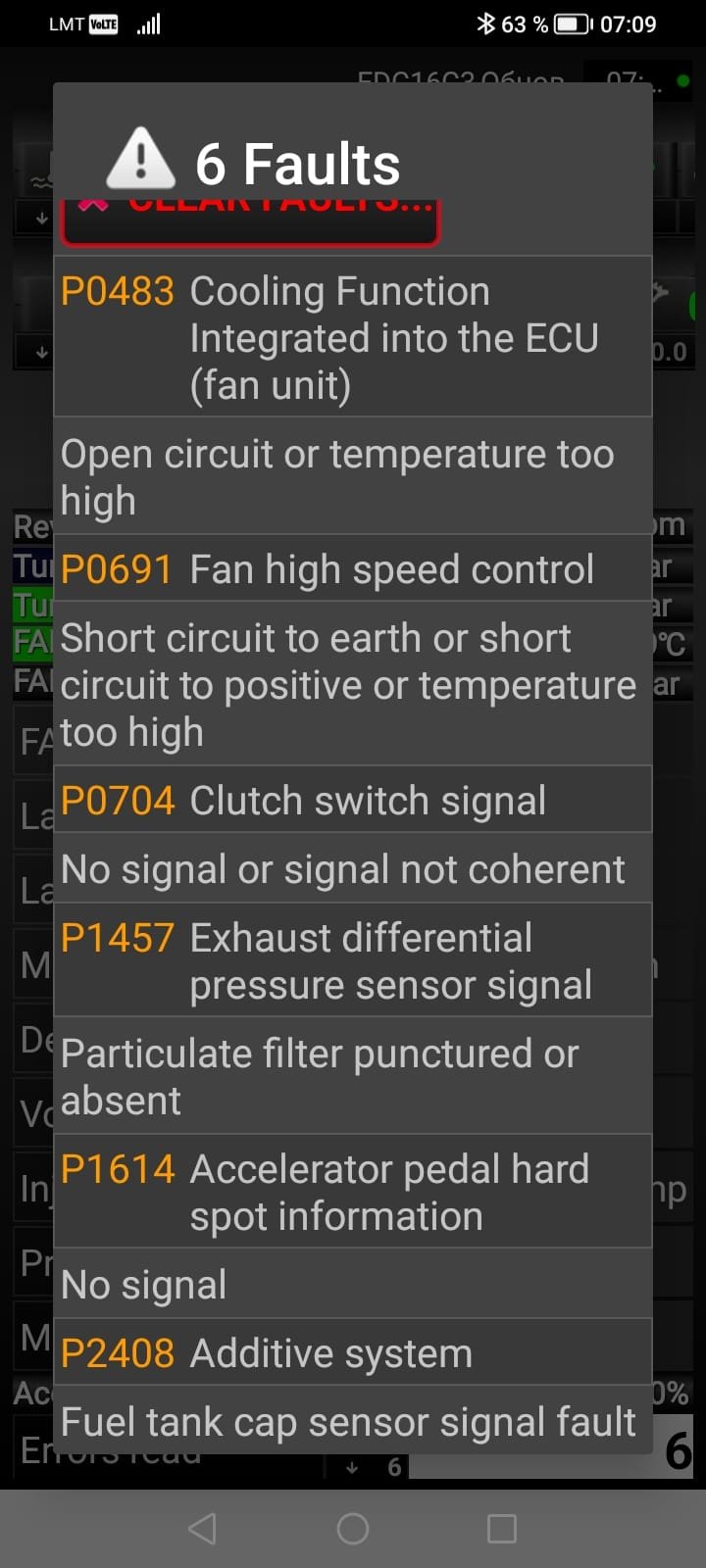

Got an issue with the radiator fan, it works only on a high speed, got scanned a car recently, so there is some fan related fault which won't clear. Radiator fan new, after market. Fuses looks ok. Anyone had similar problem with that or could give me good advice please?

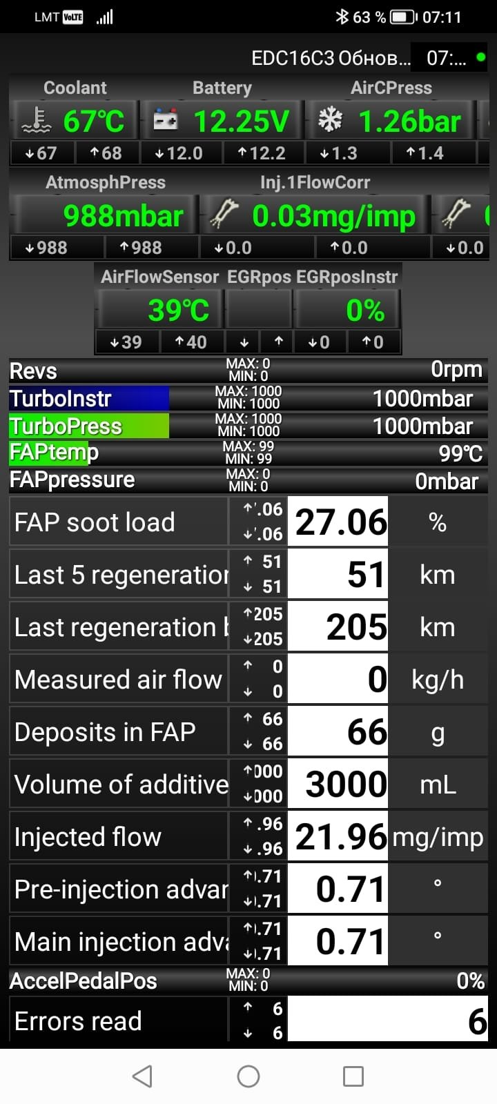

I have attached few files with the faults and readings. Looks like thermostat work fine, as it show normal temperature.

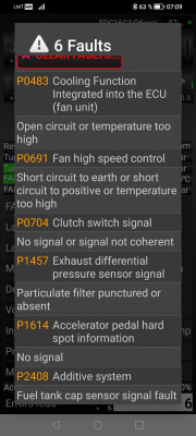

Fault list
Fault list
Actual redings
Actual redings
