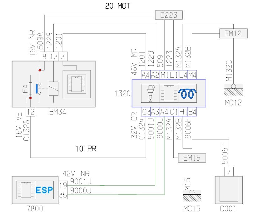

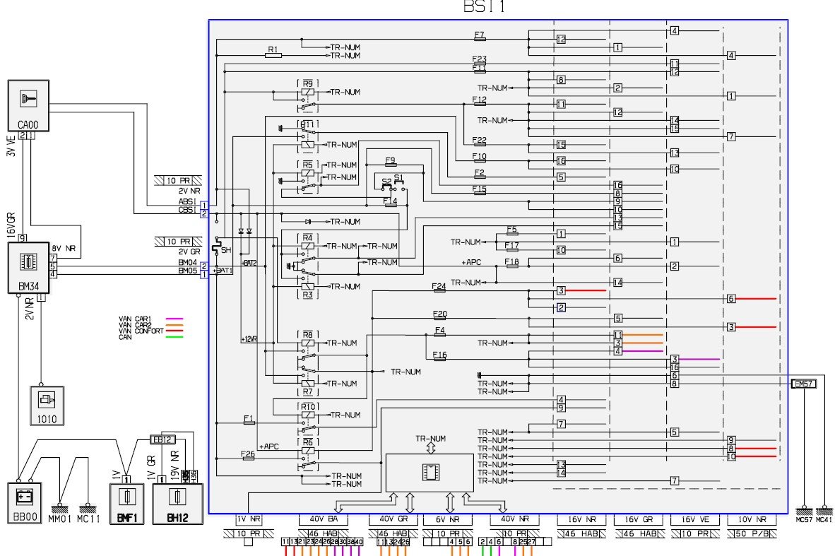

OK, so there is a lot happening here (or more correctly, not happening) so its hard to pick a starting point. Below ia sa BSI & basic injection ECU diagram.
I would probably start With the ignition on and see which fuses have power at them & which dont, Then see what ones are meant to have power and take it from there.

Maybe also do a resistance check across the CAN H & CAN L.
On the bottom diagram they are wires 9001J & 9000J.
Could check at ABS ECU (pins 19 & 35) or at engine ECU 32 way Grey connector pins A3 & A4. You should get 60 ohms.

I checked CAN H & CAN L, at both of ECUs, ABS and engine I get 120ohms resistance, battery disconnected. Any ideas?
