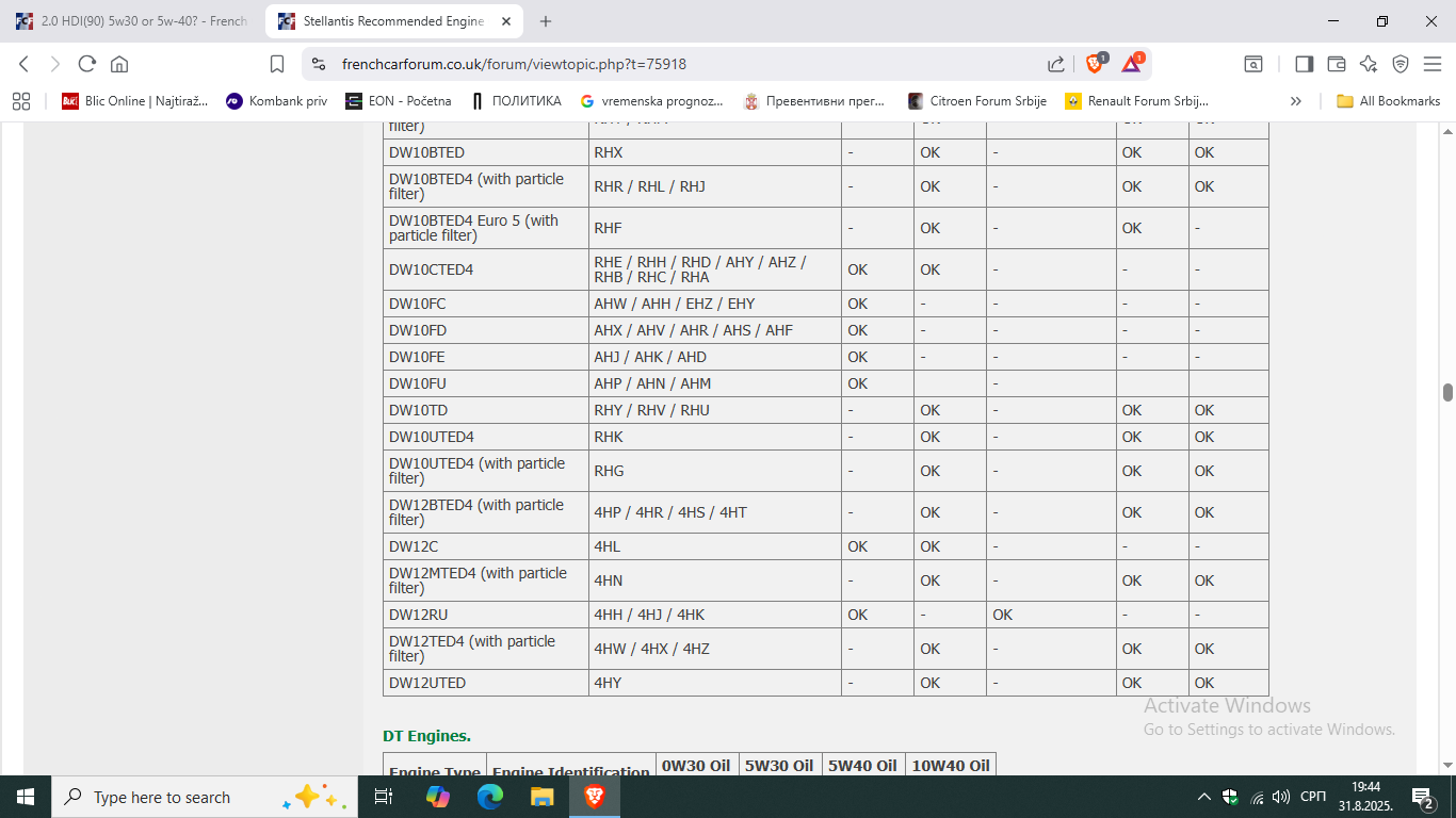

Re: 2.0 HDI(90) 5w30 or 5w-40?
According to the Stellantis document, both 5W 30 and 5W 40 can be used. I would pour 5W 40 if the engine is quite old and a thicker oil would benefit it better.
