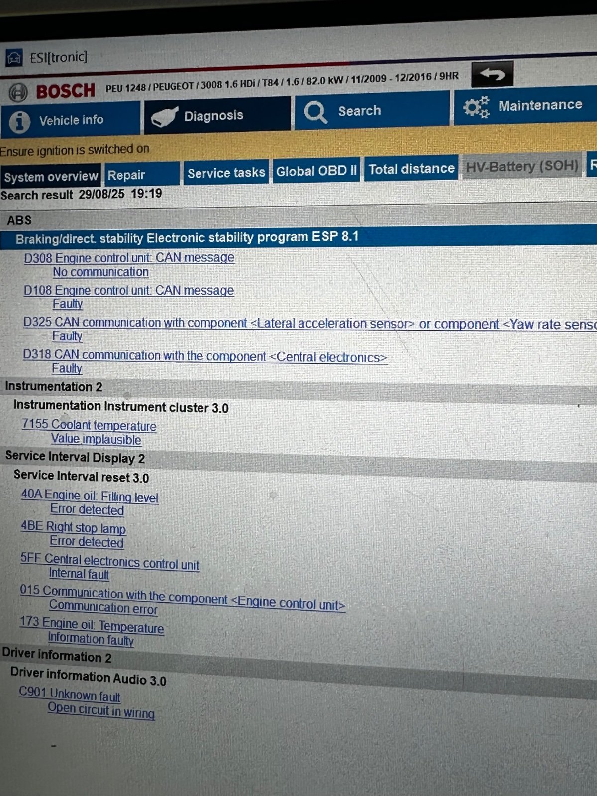

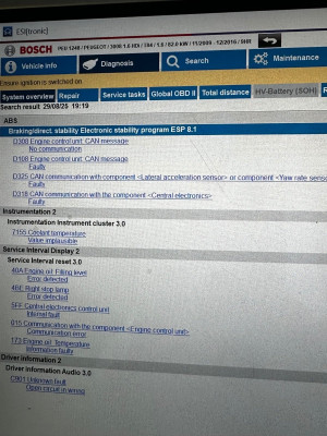

He did eventually plug in the diagnostics to have a look. On two occasions the car kicked him out. Eventually it let it run but took an awfully long time to get anywhere and so he stopped it at a point that he had identified the codes in the image attached.
I do know I have the warning light for Eolys on and I need to do this.
the AA guy, after he got bored, put it down to electrical gremlins and said could be abs/ECU and I need to get an auto electrician to have a look.
Attached, I screenshot the codes that he had pulled up. Quite lost on this at the minute so within this forum if anyone has any ideas at all, I would really appreciate any help. If anyone is to the east side of Leeds??!!!

I would start with a BSI reset, you might have upset the system with flat battery and changing it. they need the correct disconnect and reconnect procedure.
Then have it scanned with Diagbox , Clear any codes, some me be old / historic. Then rescan

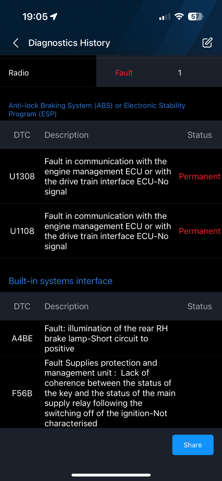

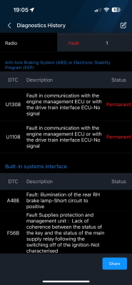

I managed to do a fuller scan than it seemed the AA guy did. It threw up two codes:
U1308
U1108
These codes remained after I did another full BSI reset, turned the engine over (didn’t start, see clip) and rescanned.
Others but nothing massive and not linked.
I’ve also attached a short clip of turning over.
After
Identifying fuses and relays, could it be a corroded main ECU relay? They seem in tricky locations hidden in front of the main engine fuse box.
As always, any help appreciated!

Are you using a fully equipped lexia/diagbox to read those codes? If not it will be extremely hard to find the fault. Cheap code readers can work on some simple problems, like my 14 yr old daughter, doesn't mean it'll give accurate answers to problems.
