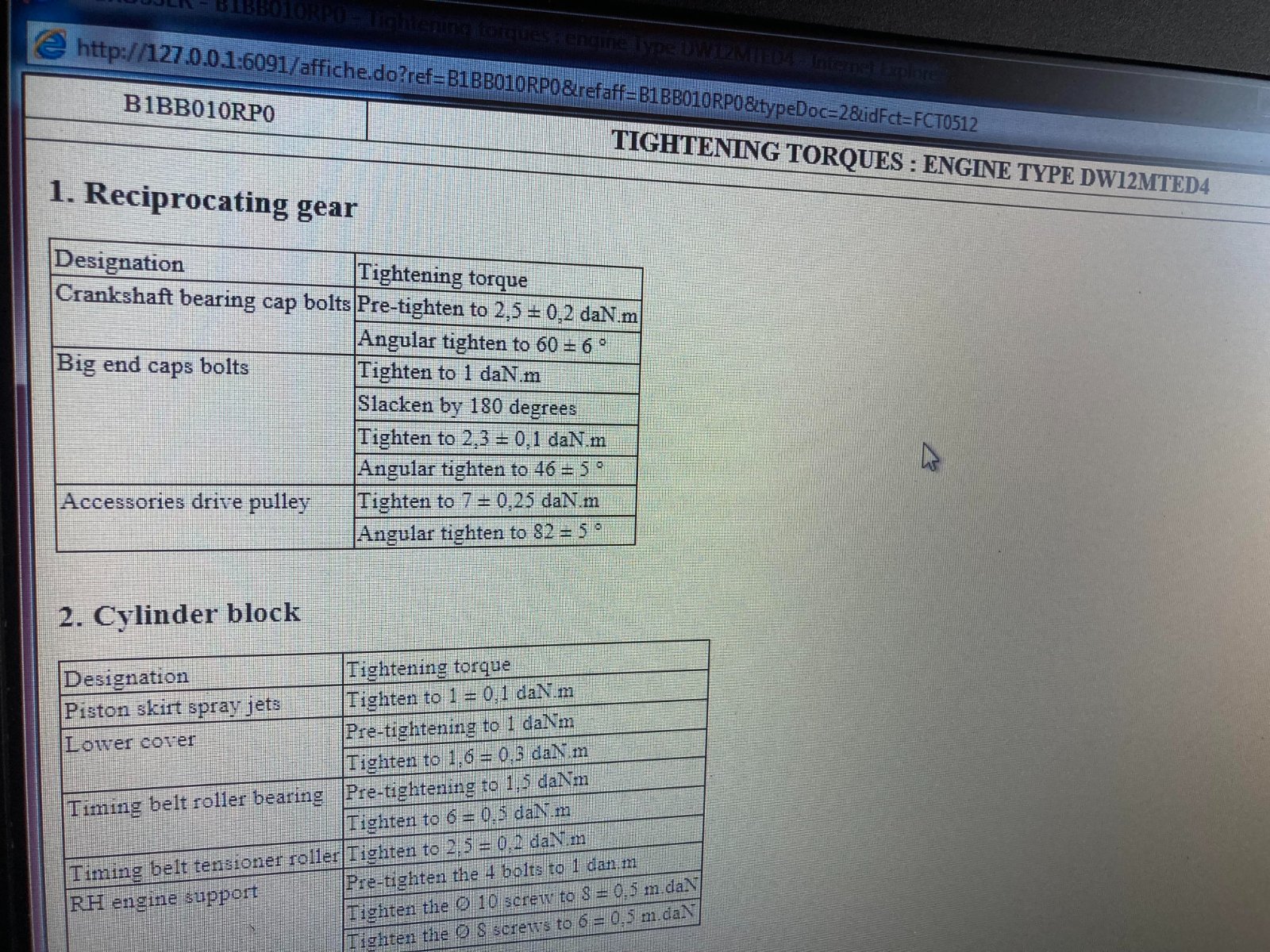

Does anyone know nonthe torque specification for main bearings on a 2.2 hdi Citroen c crosser thanks

You may get the answer at this site: https://www.manualslib.com/manual/78669 ... =37#manual

Any use ?
