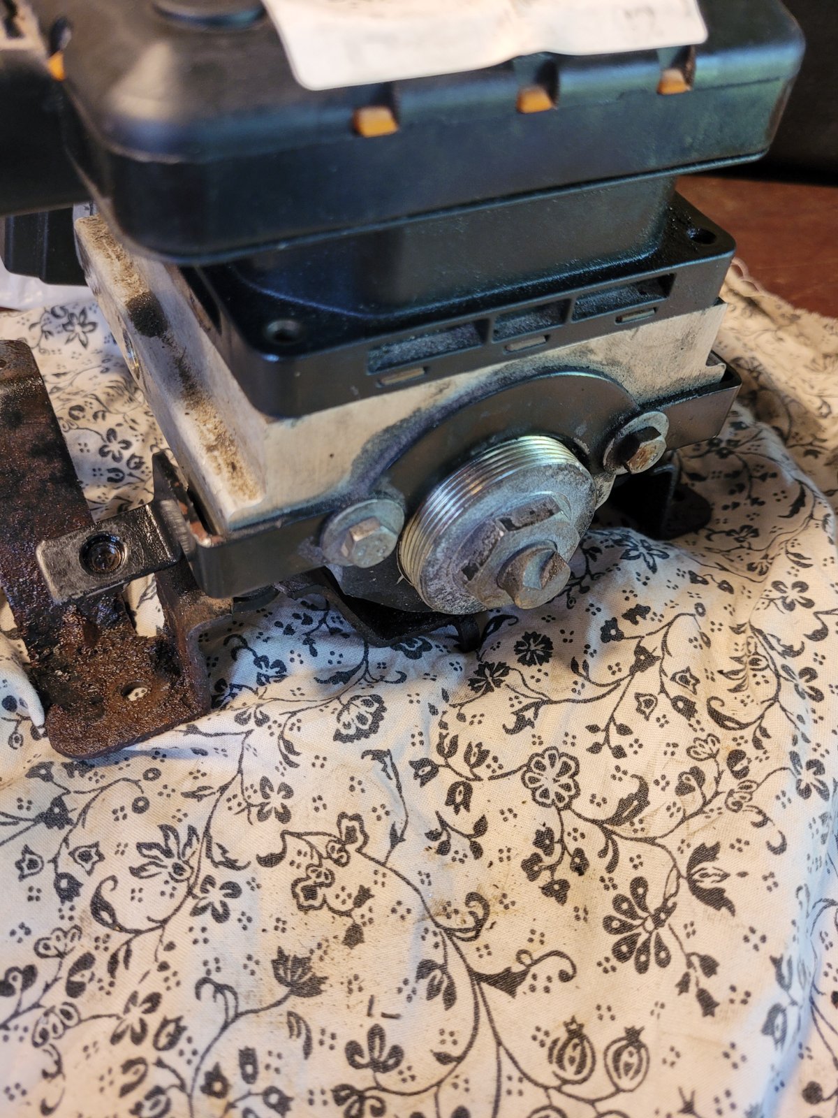

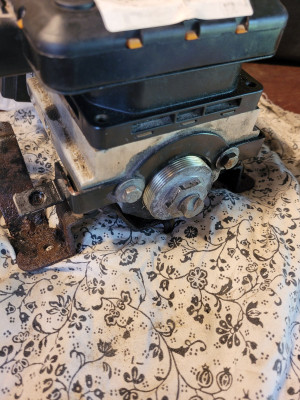

Hi!
Have a really leaky hydraulic pump. Solutions?

Re: Leaky hydraulic pump C5 x7 2.2hdi 2014
Am I right in thinking I can see a pin hole in the flange nut there?
No pin hole what I can see. Zooming in it seems to be coming from the green stuff. Bad sealing? Fixable?

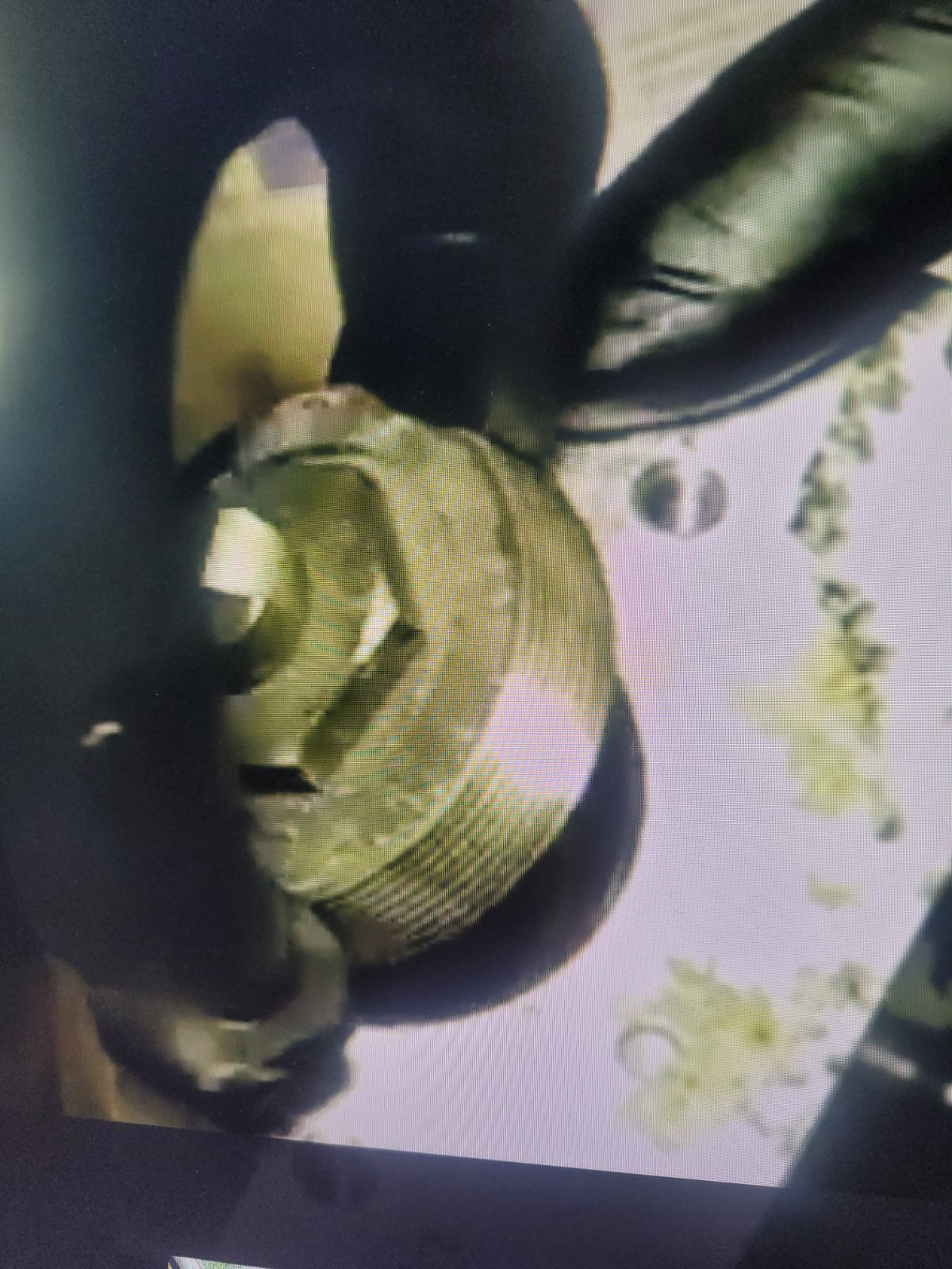

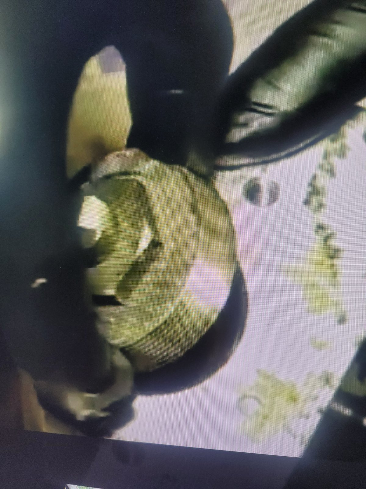

This seems to be the culprit. Is this nut/part availeble as a spare part?

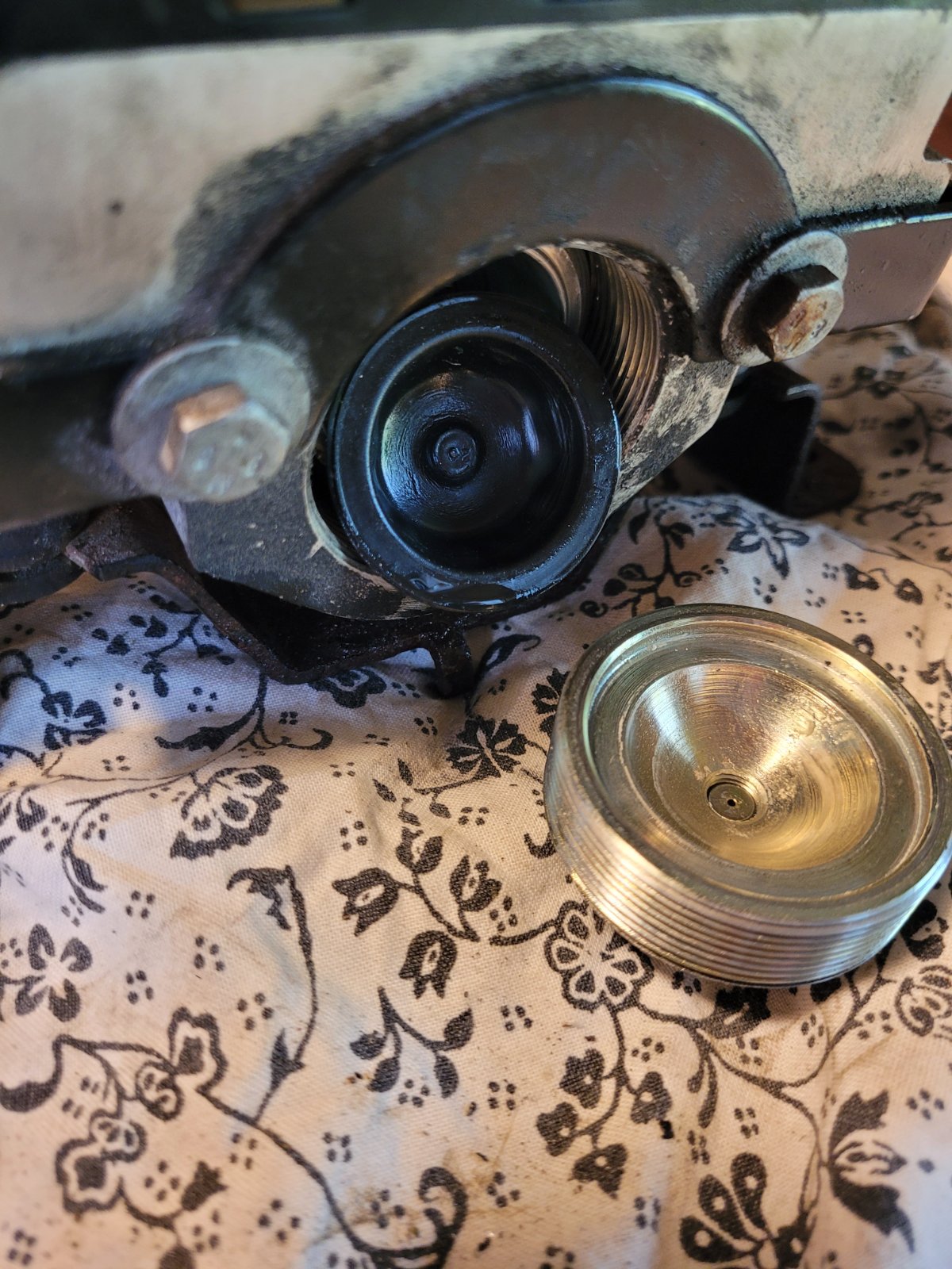

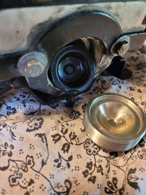

This was indeed the culprit. This is a pressure monitoring device meant to protect the pump house from overpressure. My guess is that the the previous owner didn't tell me he hit something big with the left wheel. The the left sphere was ruptured and the wheel alignment was way off.gustav wrote: 26 Aug 2025, 10:45
The pressure switch/monitoring device has now been replaced but I am missing information about torque?
