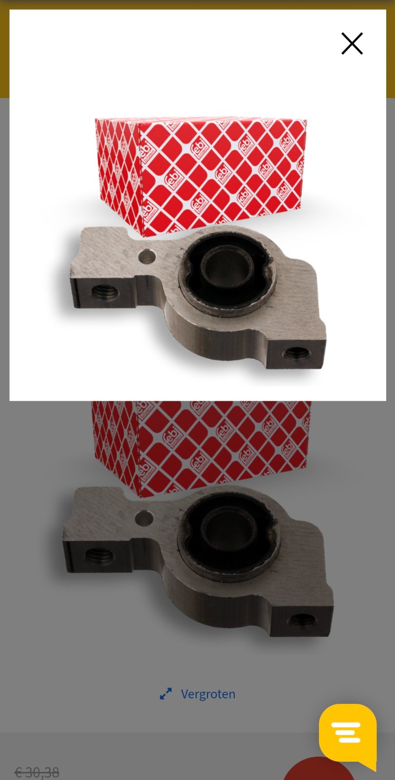

This is listed as fitting 2008 C5 III Break with active suspension. Does it look right?
https://www.ebay.co.uk/itm/276777070322 ... R7ix78ObZg

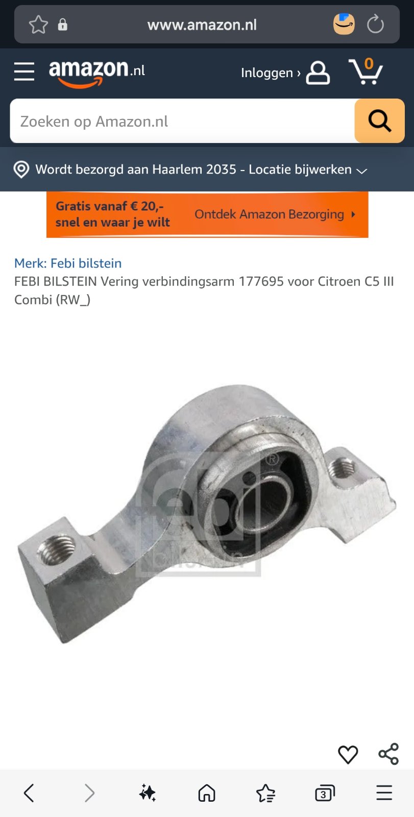

I don't understand, why people not gif the complete information about the car, for example wich engine and vin number!!
But if febi 32116 is the wrong one, you need Febi 177695

Re: C5 X7 Front Control arm rear bush replacement - Help!!!
Hi - the FEBI 177695 won't fit because there is no hole for the height corrector bracket....Kees wrote: 24 Aug 2025, 14:32 I don't understand, why people not gif the complete information about the car, for example wich engine and vin number!!
BUT the bush itself looks the same size so I may be able to push it out and replace the ones in my original housing - thanks.Kees wrote: 24 Aug 2025, 14:32 I don't understand, why people not gif the complete information about the car, for example wich engine and vin number!!
No VIN supplied because it's always stripped by the admins here anyway....
Impossible to tell if it fits from the pics - would need to see it 'end on'....mickthemaverick wrote: 24 Aug 2025, 14:27 This is listed as fitting 2008 C5 III Break with active suspension. Does it look right?![]()

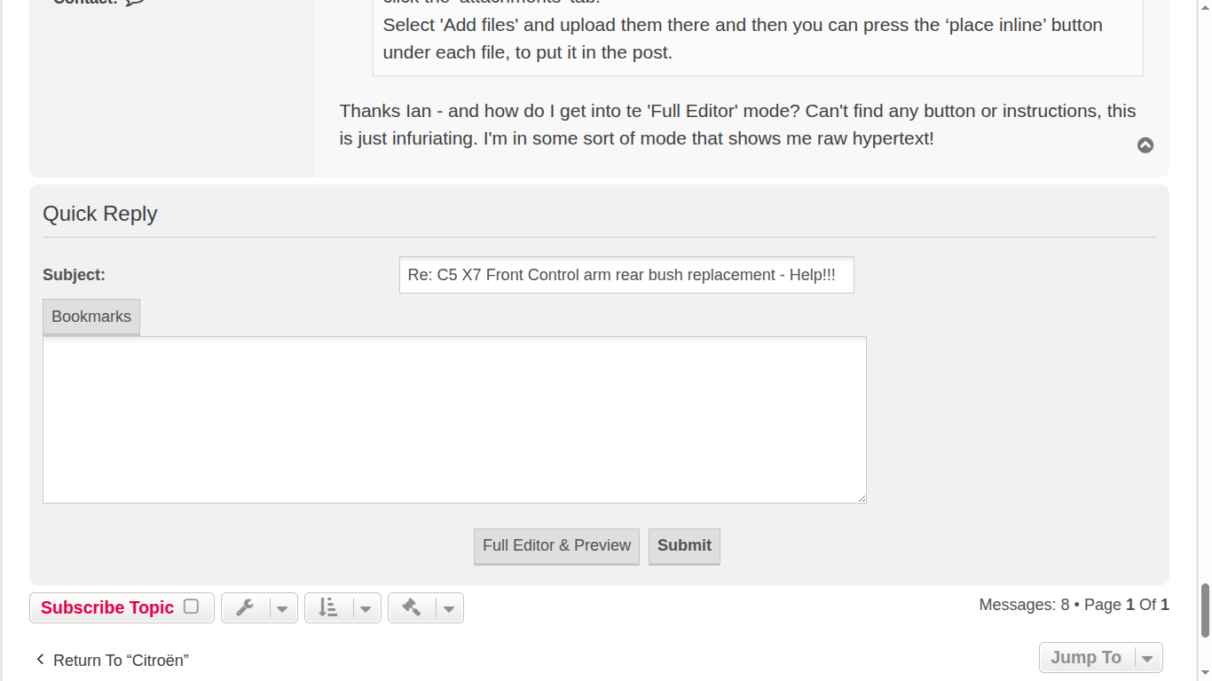

Thanks Ian - and how do I get into te 'Full Editor' mode? Can't find any button or instructions, this is just infuriating. I'm in some sort of mode that shows me raw hypertext!wurlycorner wrote: 24 Aug 2025, 14:23 Hi
To add photos you need to be in the ‘full editor and preview’ mode for posting and then click the ‘attachments’ tab.
Select 'Add files' and upload them there and then you can press the ‘place inline’ button under each file, to put it in the post.
- Posts: 28731
- x 5672
Immediately below the quick answer box:-julianb wrote: 27 Aug 2025, 09:55Thanks Ian - and how do I get into te 'Full Editor' mode? Can't find any button or instructions, this is just infuriating. I'm in some sort of mode that shows me raw hypertext!wurlycorner wrote: 24 Aug 2025, 14:23 Hi
- Posts: 21271
- x 8140
As well as Steve's guide you can get straight into the Full Editor simply by clicking the 'Post Reply' button top left of the thread viewing screen you are looking at.
