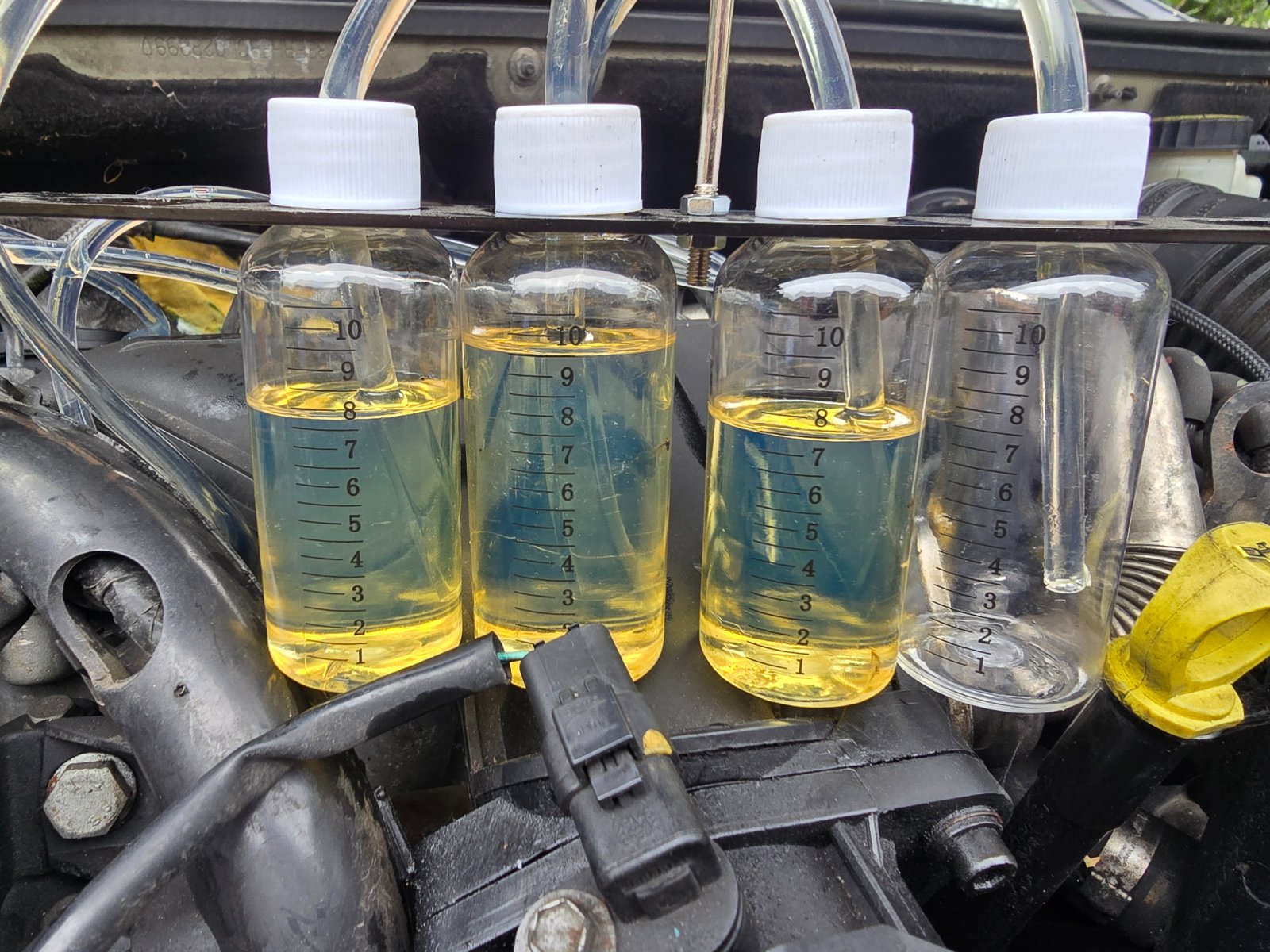

I have been chasing a issue on my peugeot 508 2.0hdi and it looks like I have a knacked injector that is not returning anything fuel after carrying out a leak off test.
Do the other bottles look ok as I'm thinking it's just 1 injector failed?.

Certainly number 1 is dead but the others are working though not well balanced I'd say :)
