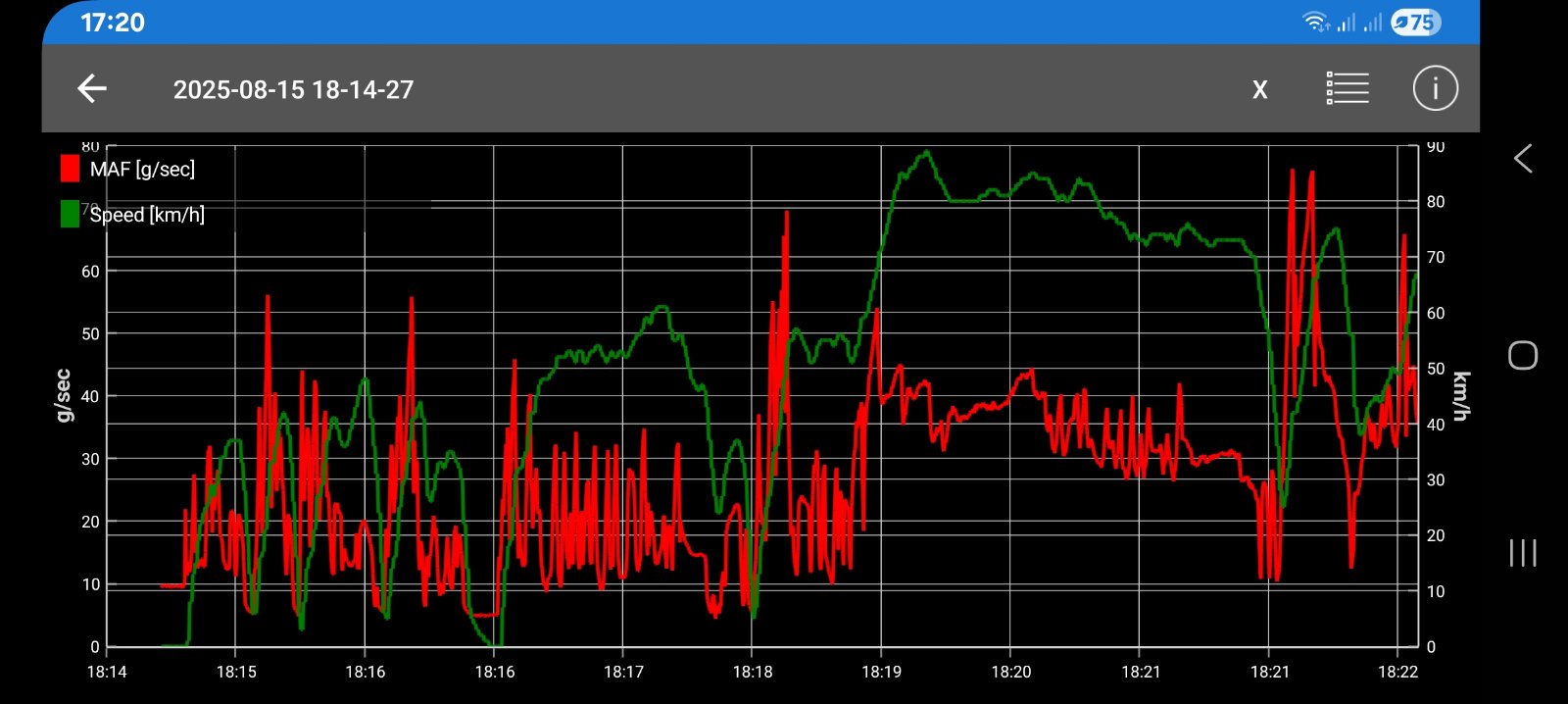

As a complete novice, my guess is that this is a MAF sensor problem. I have attached the live data for a short trip of about 8 minutes. Is that line for the MAF abnormal ? Or do I need to look for something else in live data ?

try disconnecting your MAF, The ECU has a base setting and if you have a failed MAF, it should run better and point you in the right direction

That does look a bit over peaky to me, especially when accelerating, I'd try cleaning it with a MAF cleaner spray as a first thing and see how it goes. :)

You need to look at live data when it's cranking to see that you have rpm signal, cam / crank synch,vans fuel pressure. There might be a MAF signal, but at cranking rpm it's likely to be small.
The graph of airflow vs road speed is not that helpful - you need to plot measured against expected, or at least engine rpm.

Looking at the screen shot I'd say get a new one , also check the loom
