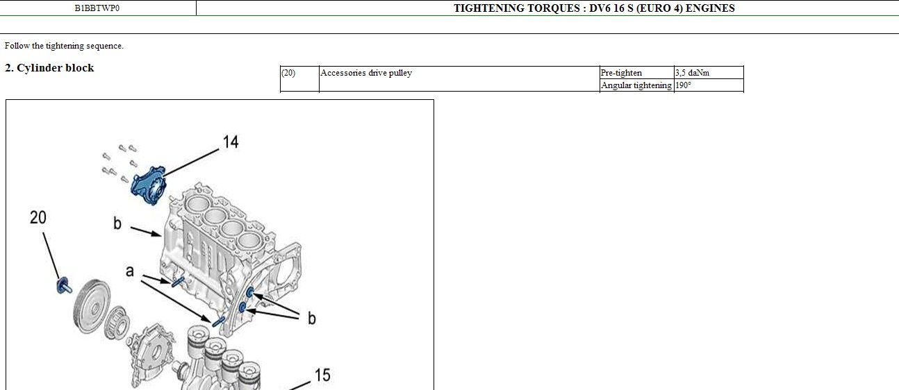

Hi
Has anyone got the torque settings for the crank shaft pulley belt bolt ( cam belt end) ive seen 35 Nm then 190 degrees, and 35nm plus 90 degrees
I know you have to use a new bolt and will be picking one up tomorrow from local dealer.
I ve aso seen some ideas that say put car in gear and stand on the brake pedal to stop crankshaft rotating , I believe there is a locking pin hole in the fly wheel just obstructed by the exhaust flexiable coupling.
Any thoughts please

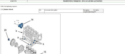

Re: Torque settings
Unread post by Sloppysod »
For C3 II 5 DOOR SALOON 1.6 HDi 110 particle emission filter (DV6TED4)
Tightening torques : DV6 16 S (EURO 4) engines
