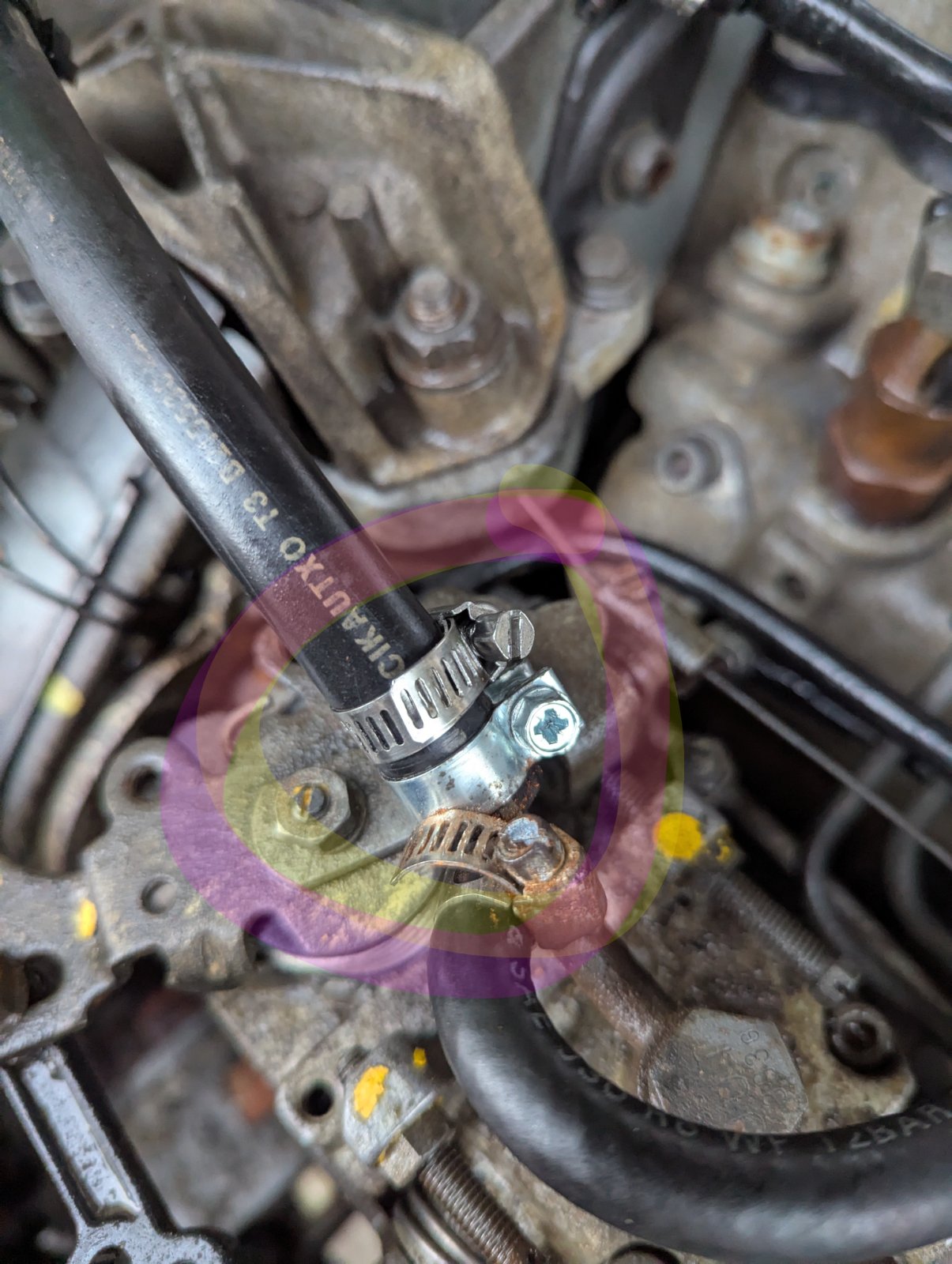

Re: 1993 C15 1.8D fuel leak.
The leak has been found and the pipe secured thanks so much for the input.
The jubilee clips are just a temporary fix until.i get some proper crimp clips
