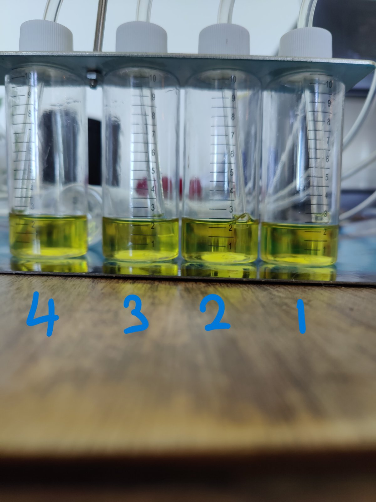

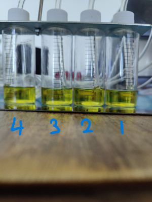

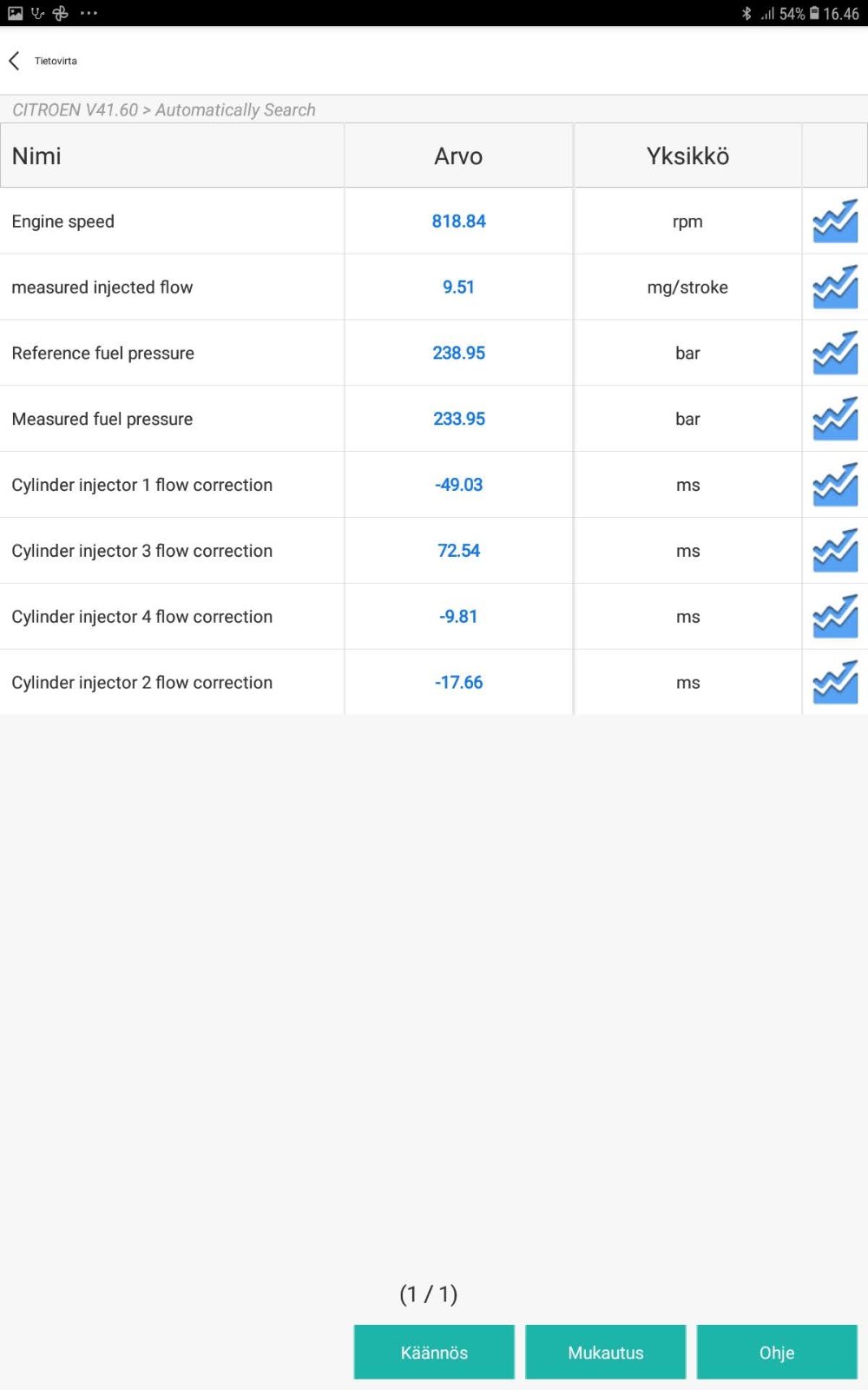

I have checked the correction values for the injectors with a diagnostic tool, but the units are not familiar to me since they are reading ms?? I'll attach some pictures if anyone understands them. I also did a leak-off test and it wasn't too bad, all were pretty even, and the total amount wasn't too much either.

Leak-off test and cylinder indexation
Flow corrections
Flow corrections

With that mileage on the car I'd be tempted to take all the injectors, having numbered them, to a garage who can conduct spray pattern tests on them to determine their efficiency. Then decide what you need to do, I believe new ones will need coding but replacing the old ones in the same places with new seals they will not. :)
